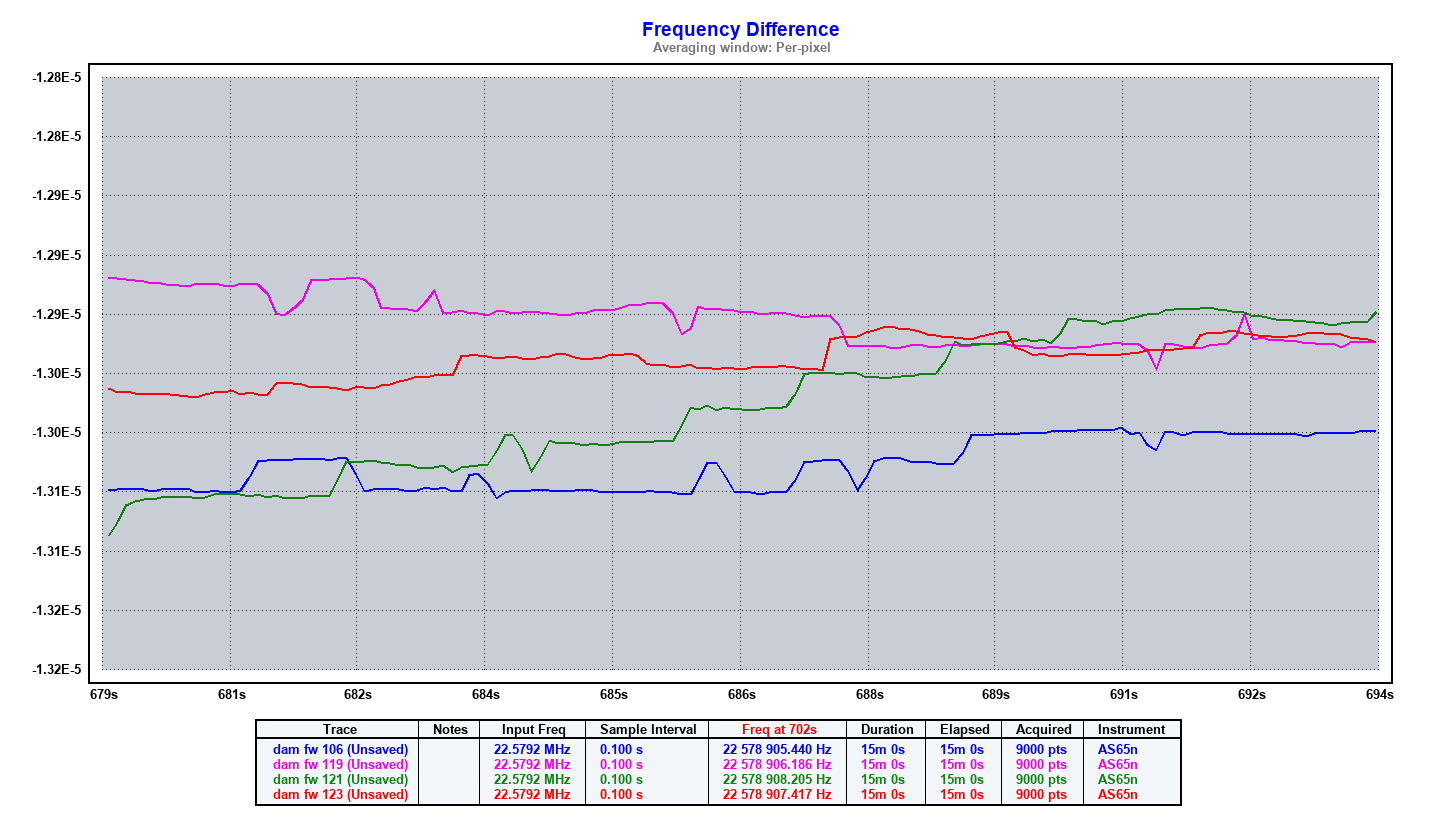

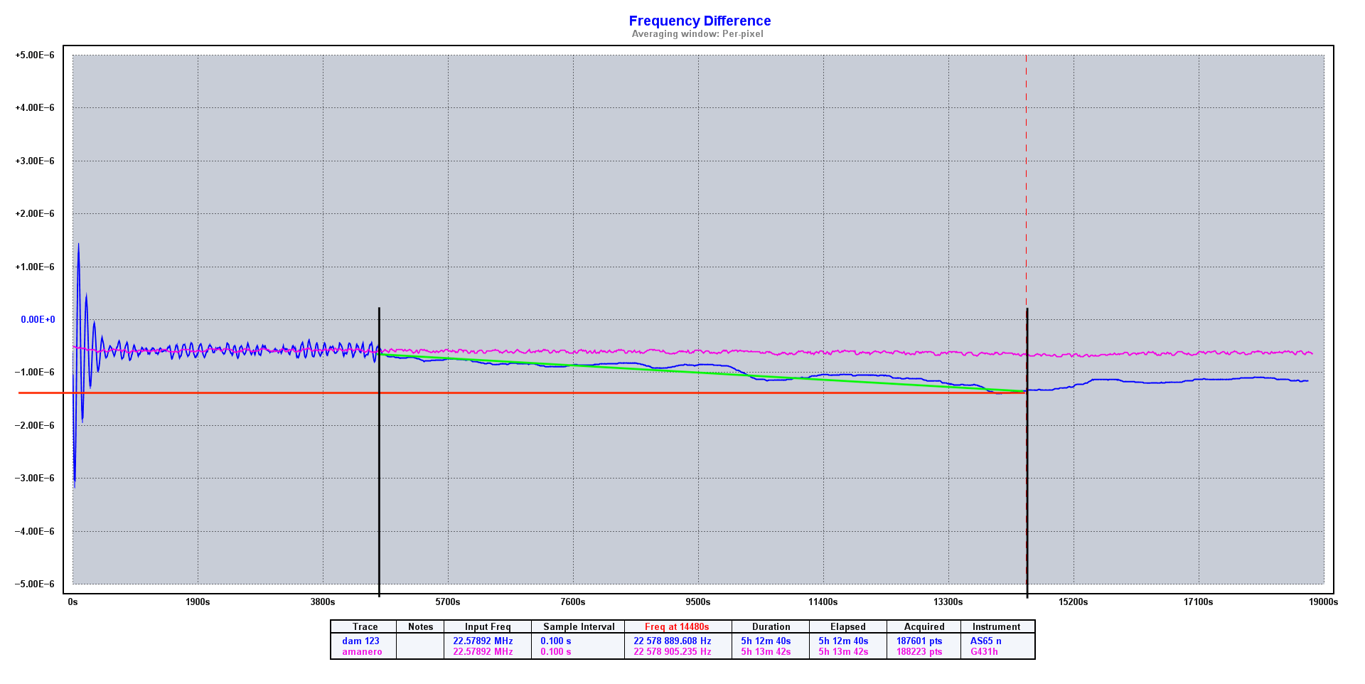

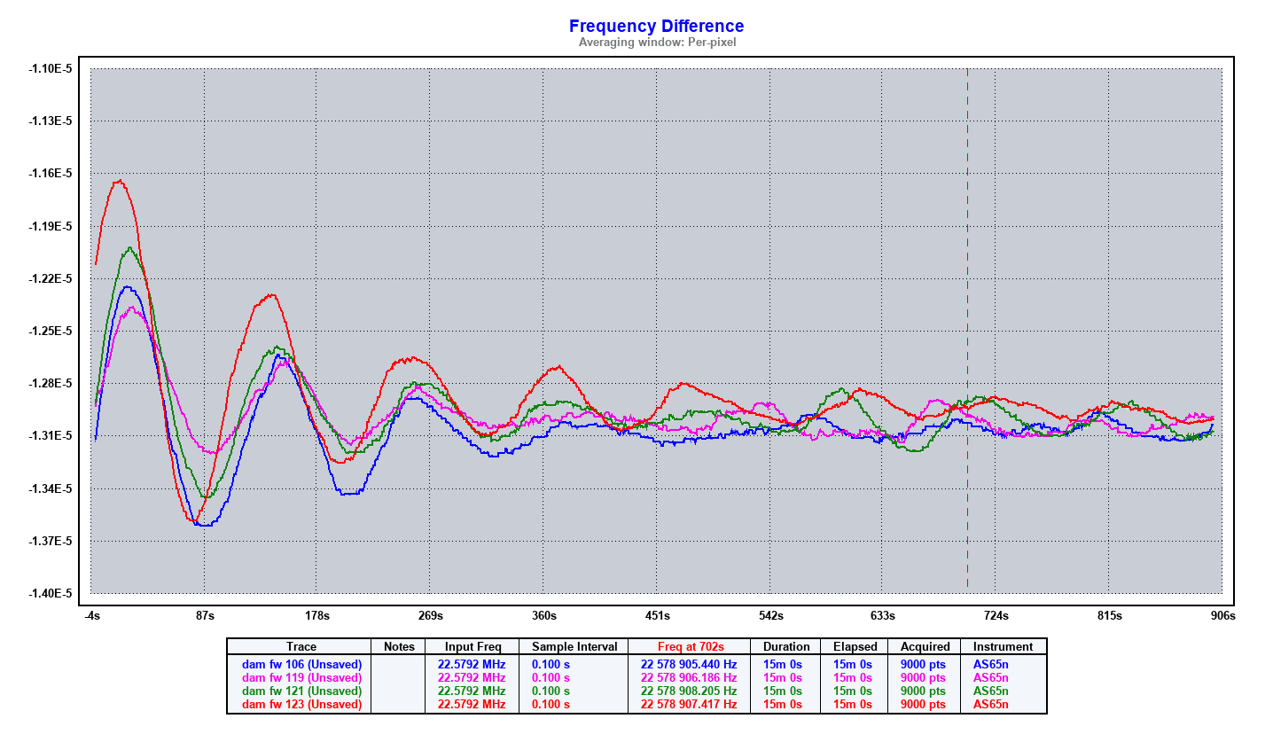

So member zfe has done some measurements of the clock behaviour of the four latest pre 1.24 (Rev 7 HW) FWs. Should be quite self explanatory. The insigth is that it doesnt seem to be any noticeable measurement difference. But if one try to pick someting, it would be:
  • First FW seem the calmest.
  • Latest one could perhaps see a faster lock-in behaviour (steeper adjustemnt curve) in the zoomed in first phase at start up.
attachemnts:

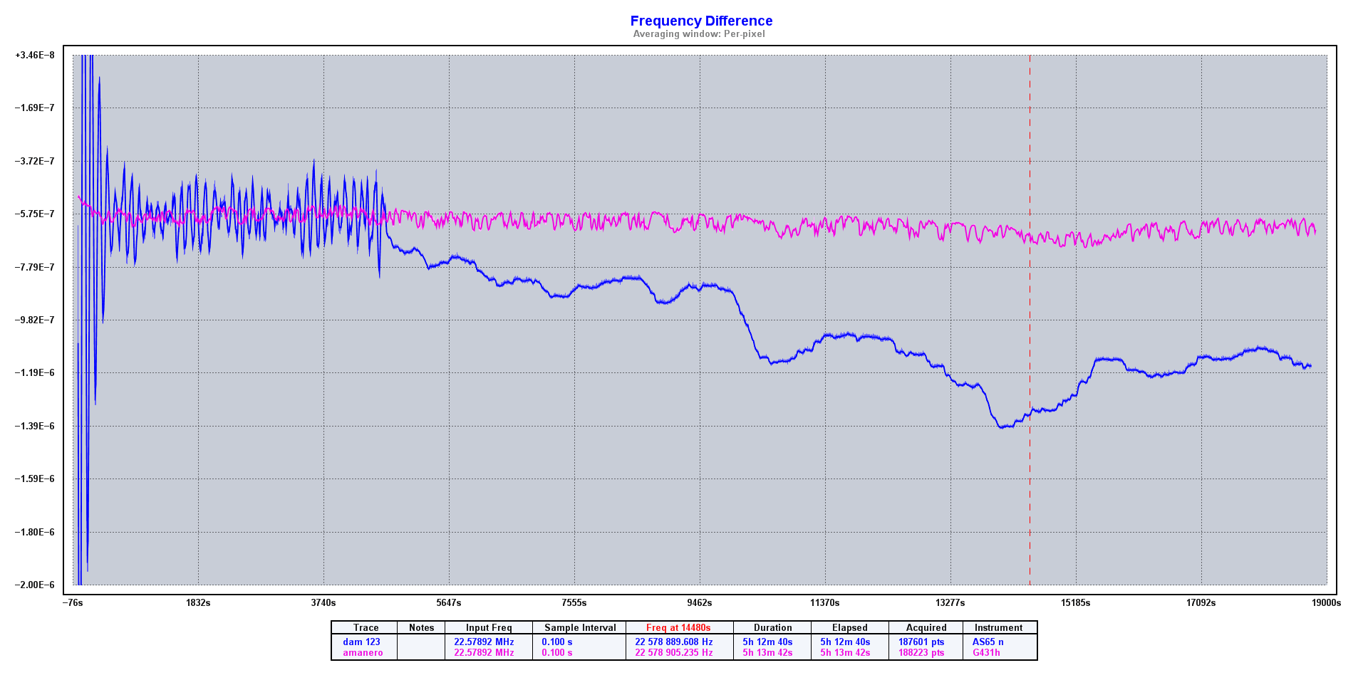

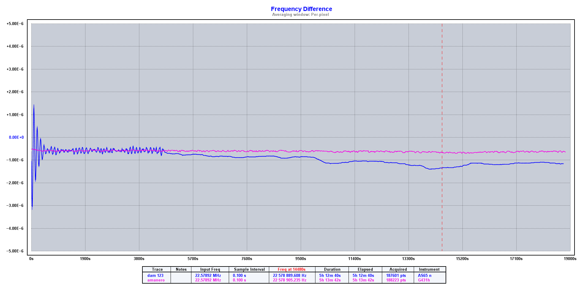

1) The FW compared behaviour long term from startup and fwd
2) Zoom in one 1) during startup

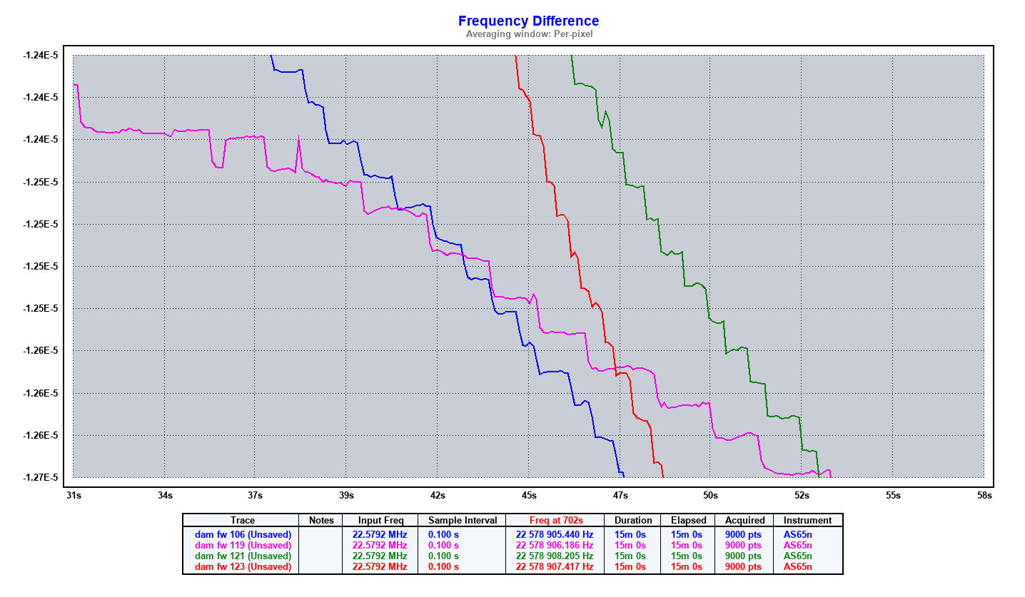

3) Zoom in on 1) later stage

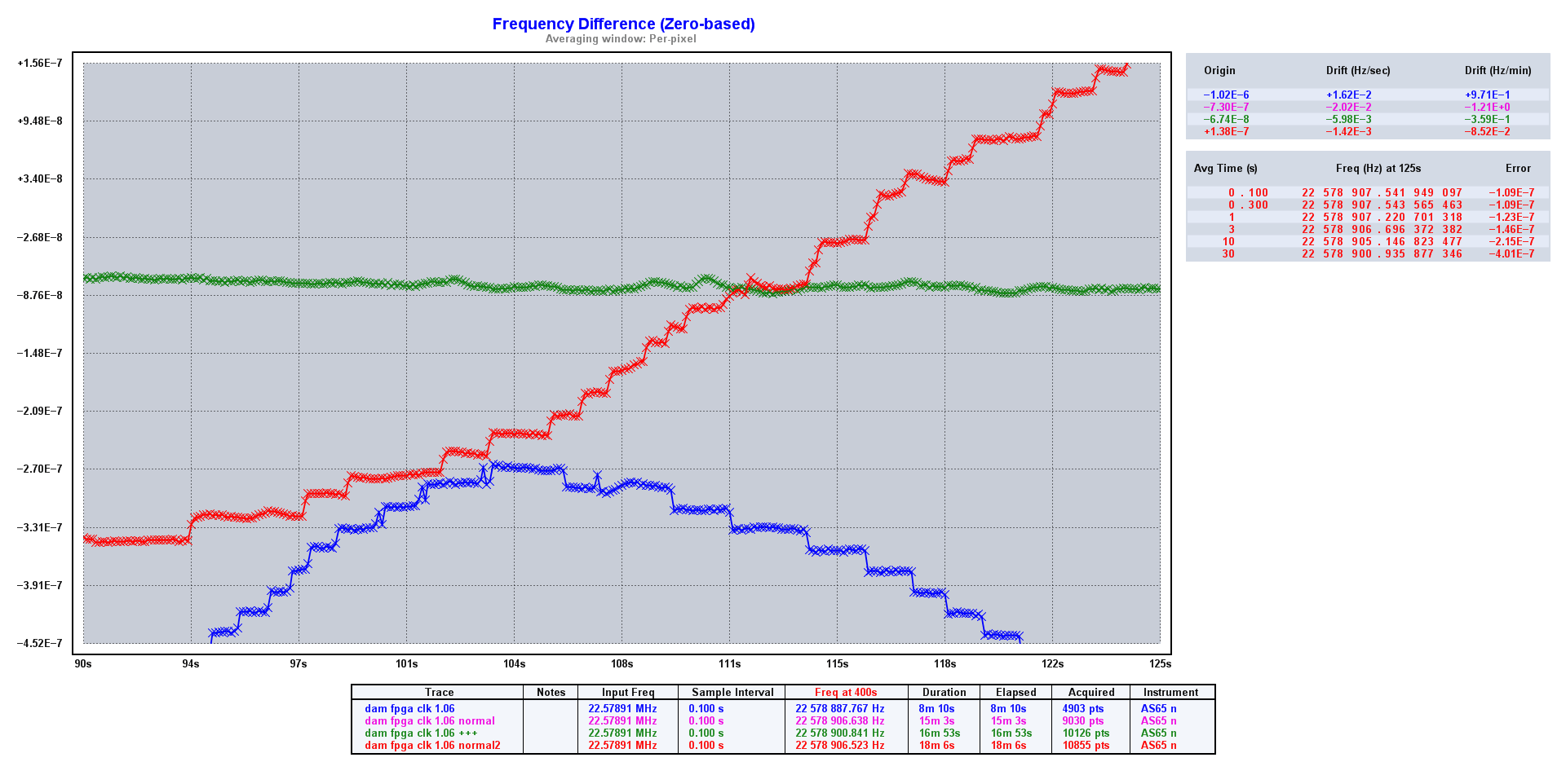

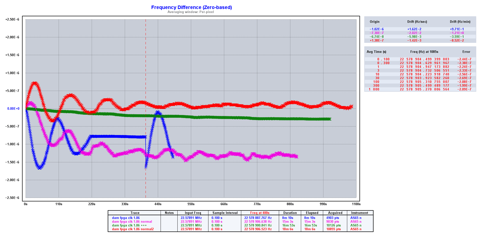

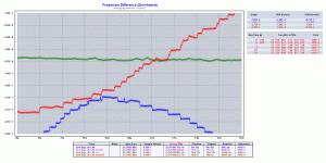

4) A comparison between normal mode and +++ mode. The blue curves illustrates the effect of entering in uManger mode and exiting again. Green is entirely in uManger mode, the other two in normal operation.
5) Zoom in on 4)

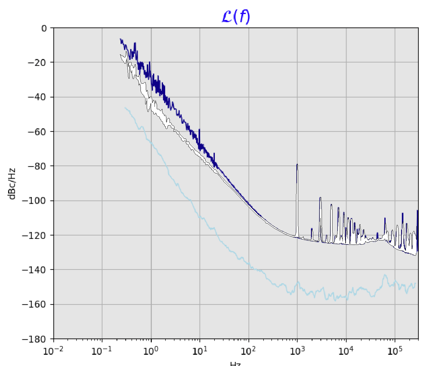

So +++ works and do good - PN 18 dB lower at 1 Hz.
New clock handling don't seem to be able to give any SQ improvements - maybe the opposite. One see greater derivate df/dt on adjustments.
SQ reports seem to match with measurement results - SQ is favourable in +++ mode => low freq/close-in PN is not desirable. (?)
I personally prefer to listen in +++ mode and hear no audible clocks or pops.
Close in PN is negatively affected by clock adjustments.
Maybe DAM series could benefit from even better clocks with lower close-in PN than the Si (if in +++ mode or in a revised FW that)

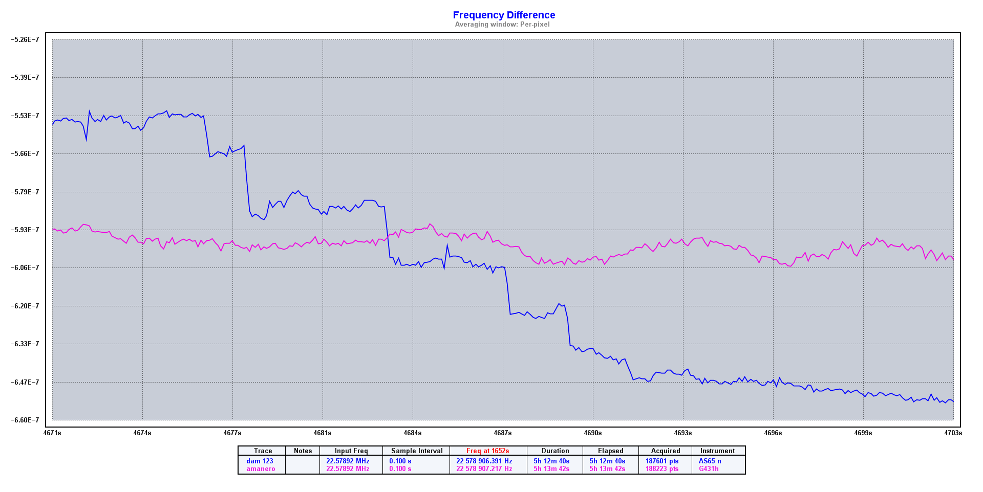

I thought the clock solution is shared between the i2s and s/pdif input - if it is, I think you would see about the same behaviour of the clock running the D/A process... maybe Sören could shed some light on this? I'll share some other of zfe's measurements which gives a clear picture on what happens when you do +++ - gif names describes contenet. zfe, what was "amanero" below?

"amanero" is the frequency measurement of the simultanious measured I2S-masterclock of the I2S signal feeding the DAM (an Amanero).
OK! And now I understand your USB comment for 1941 - its built in in the 1941 and in control of the clock - not like hooking up an external USB board to the i2s - as you do - and obviously have the "problem". The magenta trace above is the incoming clock.

Looking at the long 5h+ measurements - at what point (if any) were the deviations so big that the buffer would be over-/underrun?
Since it's seems very clear now that the clock sounds best that adjusts the least, this is the area that firmware development should focus on.
I'm also interested regarding the differences between clocking from S/PDIF and I2S, since Andrea Mori's measurements have shown the former to have much much higher phase noise than the latter...
Acc to my calculation and taking 20 samples deep fifo at 44,1 into account, 34 seconds. Here is the calc - I'm prepared to be corrected 🙂
A buffer of +/-20 samples at 44,1 is +/- 453ns. (But at 384ksps, only 56ns)
The total difference in the above example for clock deviation between the +++ point and the greatest deviation is 0,75 ns .
The rate of deviation in the above example from when +++ is entered to the greatest offset duration/offset: 10000/0,75e-6=13,3ns/s
A buffer of 20 sample/453ns would hold water for 34s (453/13,3s) if the rate of change was 13,3ns.
So after 34 seconds the +/-20 sample deep fifo has no more space (assuming it starts to write from pos 20 in the buffer (0...40)) and has to throw one sample away, zero the buffer and start over at pos 20. Repeat and rinse every 34 sec - if you don't at this point change the clock... 😉 You could have a warning at 18 sample full and change clock by half the fault and reset buffer - next time it will take 68 (66) to next event - with no slip/repeat.
But surely there is an error in my calculation...where? 🙂
