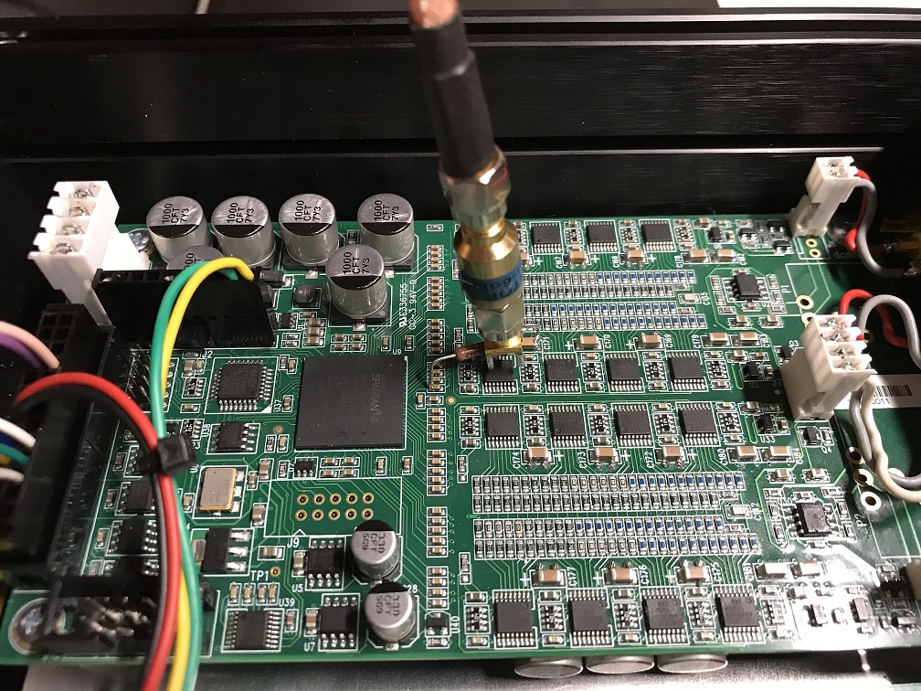

Phase noise measurement
I'm measuring the phase noise of the most crucial signal for the DAM1021, the LRCK (both input spdif and I2S, both sample rate families x44.1 and x48 kHz).
I cannot measure the MLCK for 2 reasons:
- it runs at 45/49 MHz so it's out of the TimePod measurement range
- the MCK output is LVDS so the voltage it's too low to be loaded with the 50 ohm input of the TimePod
