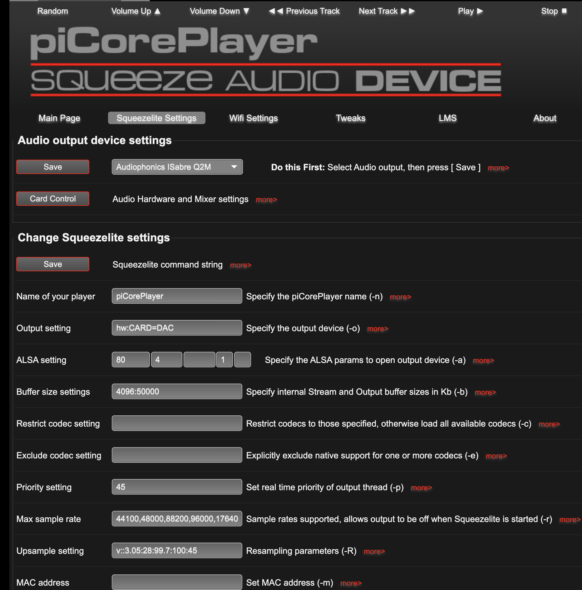

with Picoreplayer what are the settings I should use, right now I'm running with "Generic/simple TI5012 DAC"
Here is my setup. Dont bother with the resample settings. I am doing the upsample in SOX.
(Think it sounds a bit better but that is me. Would probably fail bigtime in blind listening test 🙂 )
So I need resampling from 16 to 32 bit depth?
