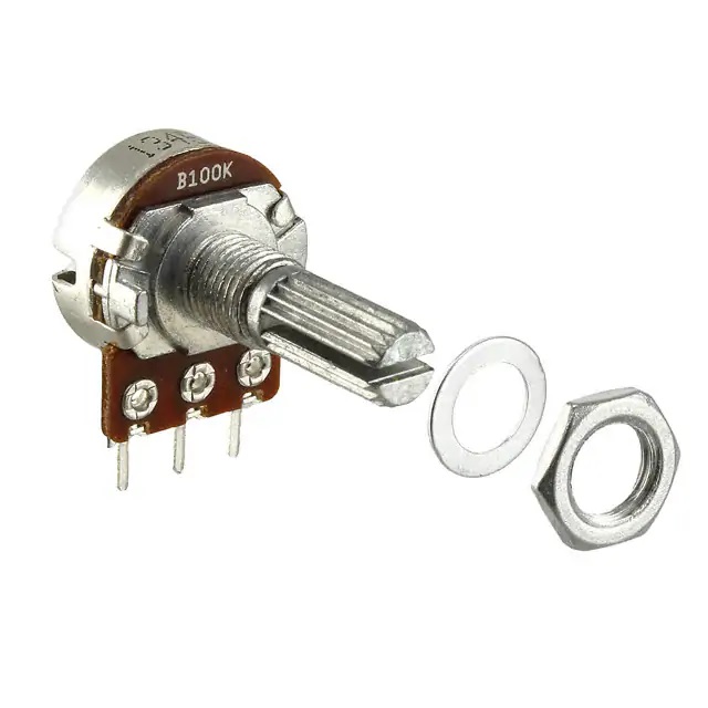

This 1 Euro part performs better
Below 20 dB of attenuation (4 bit) you lose 1 bit for each more 6dB attenuation.
Only if there is actual information. With a CD rip there is nothing below 16 bit anyway. And a signal attenuated to -60 dB retains 18 bit accuracy while at the same time most of those bits are already below the hearing threshold or lost in ambient noise, if proper gain staging wrt to the amplifier is applied.
