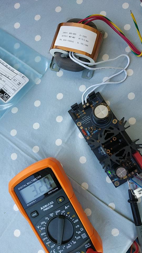

Hi guys, I'm writing here cause I don't know where I could correctly post this question. It regards the xmos board which collect signal from usb and sends it to the I2S input of my dam1021 board. I built a Reflektor-D to feed it and I setted it to output 3.3v. like many of you had already done, I will use it to feed the xmos chip and the isolated input of dam1021. Unluckily, it turned out the the shunt reg outputs 3.2v instead of 3.3v. Sören already said me the it's not a problem for the dam1021 board, but now I thinking to the xmos board. Could it be feeded the same with 3.2v instead of 3.3? I'm scratching my head...
It can, but as vgeorge said, it is not a great idea. Sharing the same PS will render the isolation ineffective. You need not only 2 regulator boards but two completely independent power supplies with separate transformer windings.
I was convinced it was important to keep separate supplies just for the dam board and its isolated input, cause these two sections must not get in contact. Why should it be avoided to use a common supply for the xmos and the isolated I2S? I have seen instead, if I am not wrong, other builds with a common supply at these two levels.The reflektor can be made to output 3.3V by changing a led.
But I wouldn' t power both the dam and the xmos from the same regulator.

PS: btw, my concern was about my build of the Ref-D, which I setted to output 3.3v and it turned out to output only 3.2. Are these volts enough to supply the xmos?

Just I prefer to keep the power supplies separated. I will work with common supply without problems. Just be sure to calculate the current consumption of the dam and the xmos together for the reflektor.

The XMOS interface and the outside 3.3V power for the isolators should really be powered by the same source. And as pure digital power, the quality is not that critical, you can use the regulated USB Power, just any 5V to 3.3V linear regulator....

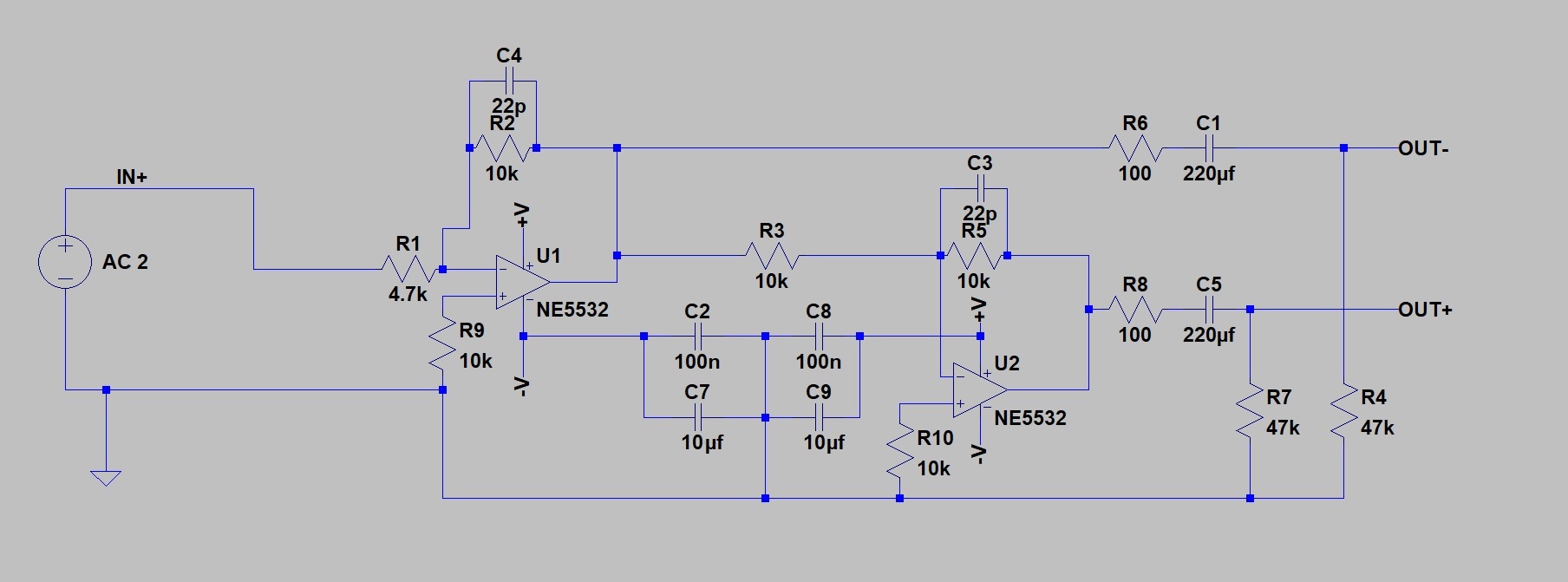

I built a custom balanced output for the DAM1021 based on inverting NJM5532DD (best sounding dual op amp in mine and many other studio people's opinion).
It's really obvious in comparison how bad the on-board balanced output sounds. Squashed dynamics, concealed details, a blunted and at the same time stressed high end.
Though actually rather simple, it took quite a lot of tweaking by ear (many recordings with a high end AD converter and comparing the output to the original file) to get it to sound as good as it is now. Needs a good power supply, of course.
Drawbacks to my output stage are higher noise and more DC offset than the on-board solution. The latter is taken care of by the blocking caps implimented in most amplifiers, of course.
I will use this output stage in my 32 channel DAC for studio use. If anyone is interested, I can post the schematic.
Please do.
It is really simple, with a little more gain than the on-board solution. The inverting op amp configuration sounds much cleaner to my ears, even though a non-inverting solution can in theory measure equally low in THD (except for the very high end of the spectrum with the 5532). The 22pf caps in the feedback path should be NPO/COG, the 100nf decoupling caps X7R and the electrolytics a standard type (not low-ESR, since their inherent resistant increases stability). Coupling caps should be reasonably close to the op amp pins. Don't use more decoupling (especially not rail-to-rail, no matter what Douglas Self writes, I don't think it sounds good with the 5532 and I've encountered oscillation with other op amps this way). The usual caveats with regards to board design, grounding etc. apply.
C1,C5,R7,R4 can be left out if some DC can be tolerated by the following stage.
Phase and frequency response deviations are inaudibly low. I couldn't detect any stability problems.
The resistor selections result in an elevated noisefloor, but it sounds better this way to my ears. Noise is still much lower than with vinyl, a studio tape machine with noise reduction, 16 Bit CD audio etc.
Use a linear +/- 15-18 VDC PSU.

Or you could use the new TI opa1656, those are good, see the opa1656 thread.... In my opinion, the 5532 is pretty old....
Like the design I use in the new dac2541. This circuit have only one opamp in the path of each of the + and - output. You will need to double the resistors for the dam1021, to match the R-2R resistor networks, as the dac2541 have half the output impedance of the R-2R network.
The opamps can take up to +- 15V, you would need to change the decoupling caps to match. But it will work just fine on +- 5V
Agree. It was the only way to obtain reasonable sound out of the old 5534s in the eighties.
