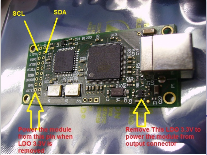

Do you know if the Amareno can be powersupplied by an external PS than its USB ? Could be a good enough candidate as the Soekris has an isolator and a Fifo !
For the SPIDF, i should advise BNC plugs and matched impedance wire if the source provides also a BNC output... RCAs certified at 75 ohms are hard too source. I use some pcb BNC receiver with leads : I just plan to connect it with a pulse transformer leads to leads soldered (as saw in the Implementation thread) for the shortest pass as the to reduce the numbers of soldering wires interconections !
I use an Amanero board in my current DAC, and the DAC powers the Amanero board with 3.3V. You need to remove a little, 3 pin regulator to do this. Also, I think this still leaves one chip powered by USB power, I'm pretty sure my Amanero won't work unless it has USB power too.
And from what I understand, RCA's are never really 75 ohm, so I definitely agree that if you use SPDIF, go with BNCs. I know some companies claim to make 75 ohm RCAs.

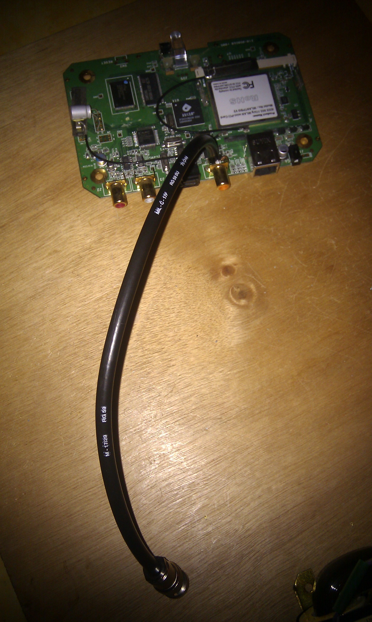

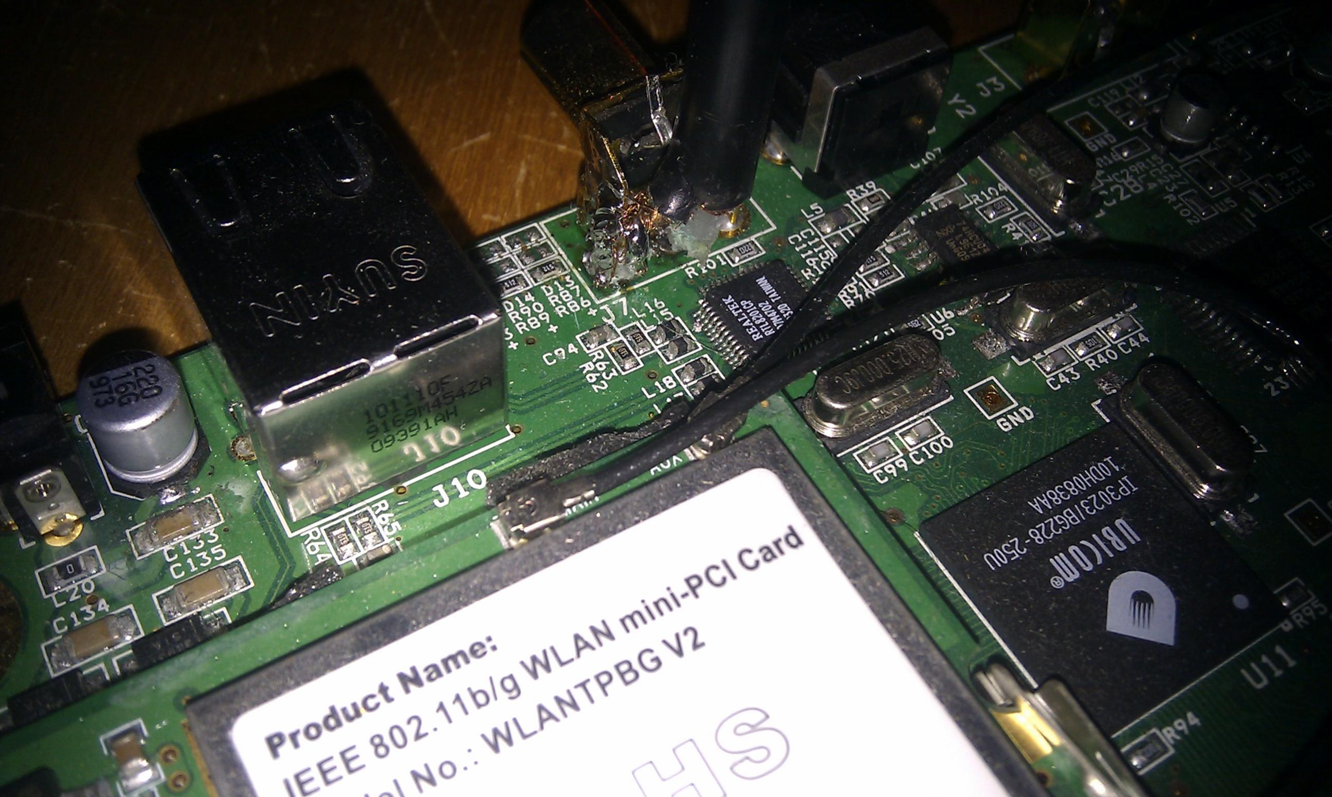

Since the good people from Subbu's threads adviced me, I maid this with my spidf streamer (SB Duet) : full 75 ohms. It gave me a subjective larger band and much better bass. (of course th DAC side has a BNC plug as well)
As the dam1021 R-2R DAC has isolators for the I2S interface it is highly recommended to power any USB-I2S module from USB Power.
I did that with my DIYINHK USB-I2S modules, although for some reason those modules did not have the 3.3V regulator mounted, had to mount those myself....
