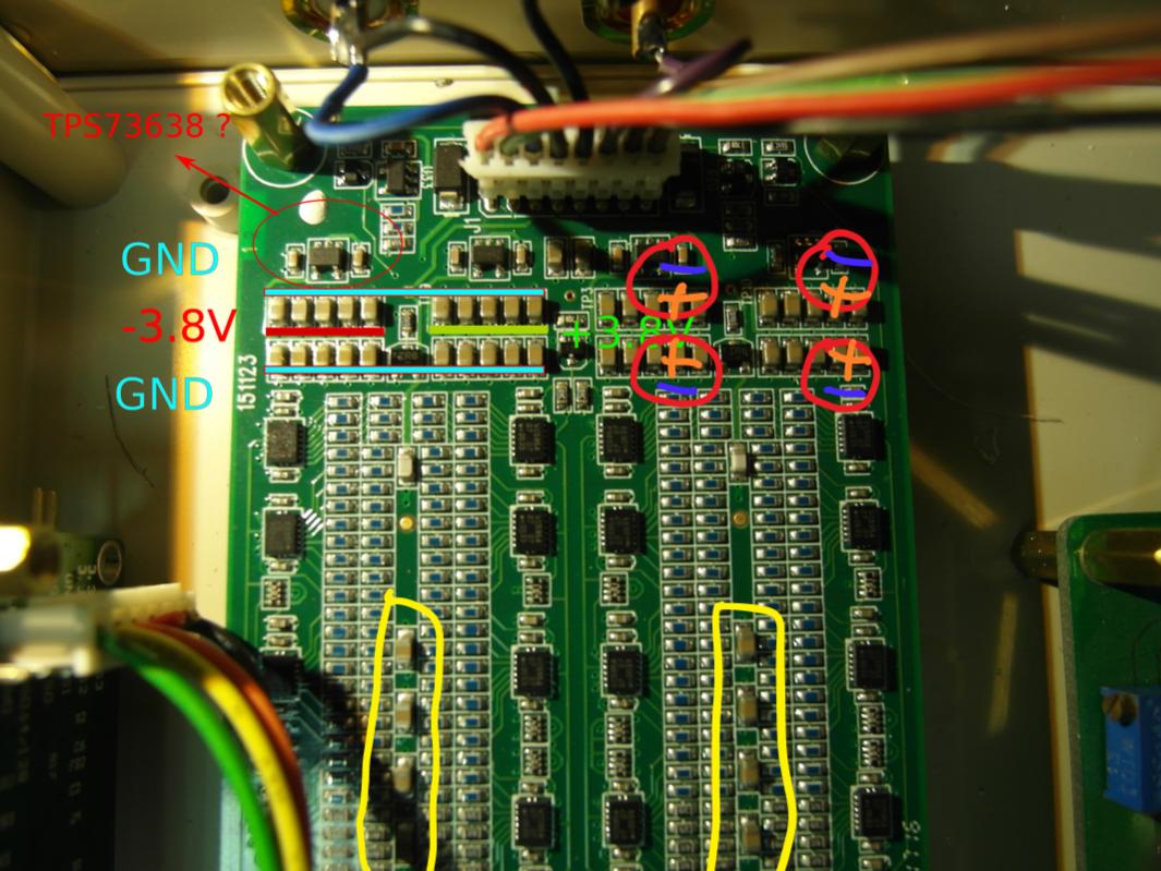

So, the caps arrived, and to not do a dumb mistake I better ask how to. I will never be sure about how to connect caps in V-...Is it OK to add the caps as shown in the pic?
And then there are some important looking ceramic caps in the yellow box, do these belong to Vref as well?
I stole the picture from an innocent Chinese DIYer, please forgive me dude.
And yes Ynmichael, you should get some sleep from time to time, I was already wondering if you ever sleep😀
Jogi, what board is this? The temptation to rip out all these horrid ceramics and replace them with Pana ECPU is overwhelming 🙂
That's the 1121 OEM board and you are absolutely right about those ceramics. But I think I will just solder the polymer caps over the existing ceramics, should be fine.

Ahem, anyone can confirm the polarity on the attached Pic is ok? I am about to heat the iron...
I wouldn't be so quick to give in to that temptation... what's your justification for replacing the Samsung caps? People reported great results with regular electrolytics...

Maybe for the 1121, but for 1021 there's a huge difference before and after vref caps. Separate question whether only pure undiluted distortion was added.

Yes, still alive. For whatever reason the SKlite 5V line puts out only 4,5V for the Waveio, so I had to switch to USB power from computer, which is not a good idea.
And I only added 3000µf to each of the Vref+, and left Vref- as it is as I didn't get a confirmation.Better be patient than sorry...
And I added 1500µF to the clock supply.
So...much better. Still not really there, but there is hope. The dac sounds somehow current starved and stressed in stock form, which is better now.
