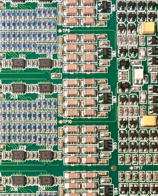

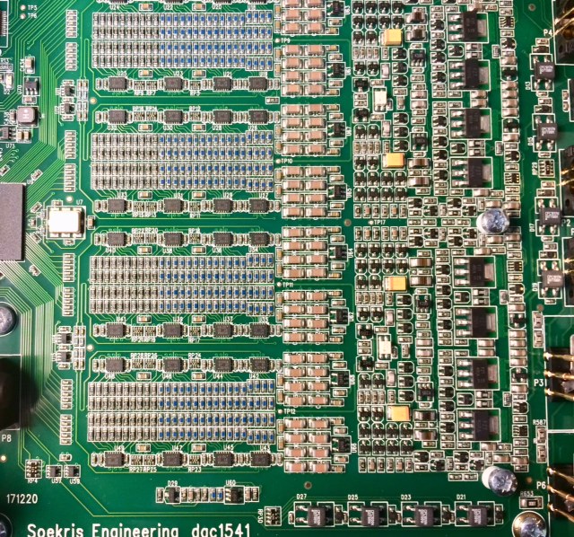

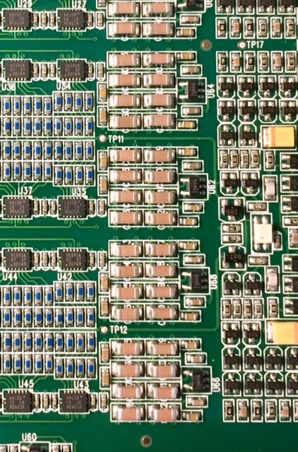

I too noticed a significant SQ improvement in removing the output filtering caps from the single ended output board. However, my old guy eyes are having trouble finding the locations of the output caps on the 1541 balanced output board.
Attached are photos of the 1541 board. If someone will identify the locations of the output filtering caps, I'll remove them and report my findings.

I cannot possibly imagine why a crappy ceramic cap would sound bad in SE and not BAL. And it is extremely easy to resolder if you decide you prefer the sound with the caps.
It's an NPO ceramic cap, so not really crappy (and this really depends on application anyway).
It seems most people who removed the cap are not using the balanced outs. I have to use the buffers, so they need to work properly.
You are right about the buffers. They will see a bit more RF without the caps. One of the first things i did was remove the buffers as imho these are even worse than the ceramic caps. Anyway, it is much easier to take the caps out and have a listen than agonise about it.
No so easy when you have two boards stacked with extremely tight pin/pin headers and basically wired together 🙁
