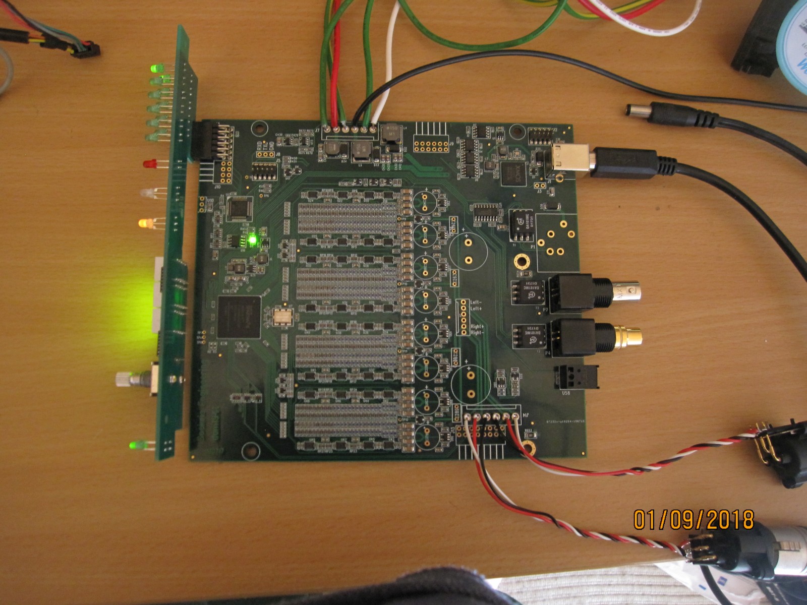

Yes.
Or maybe you should use the upcoming dam1941 board, basically a dac1541 with power supply and output buffers removed.... Will also be available in a single ended version, the dam1921, same board but half the resistors networks mounted....

so the usb in integrated in the board? i see an xmos chip in the picture.
Yes, the dam1941 have all the digital inputs, just like a dac1541. In fact, the dam1941 also have support for an additional I2S input, t.ex. for a Streamer interface....

Any info on your power supply?
@soren
The additional i2s input will be unbalanced? Support to take/use balanced i2s?
Just std 3.3V cmos levels. You can do you own balanced I2S interface, there are no standard for that....
I'm planning do to a basic but very flexible power supply with PCB mounted transformers and LM317 / LM337 regulators, to supply +-5V for the dam1941 itself, +-7-15V for optional buffer board and a high voltage line done by a voltage multiplier, for a tube buffer board....
People are of course welcome to do all kinds of fancy Power Supplies and Output Buffers, there seems to be as many ideas about that as there are builders....
