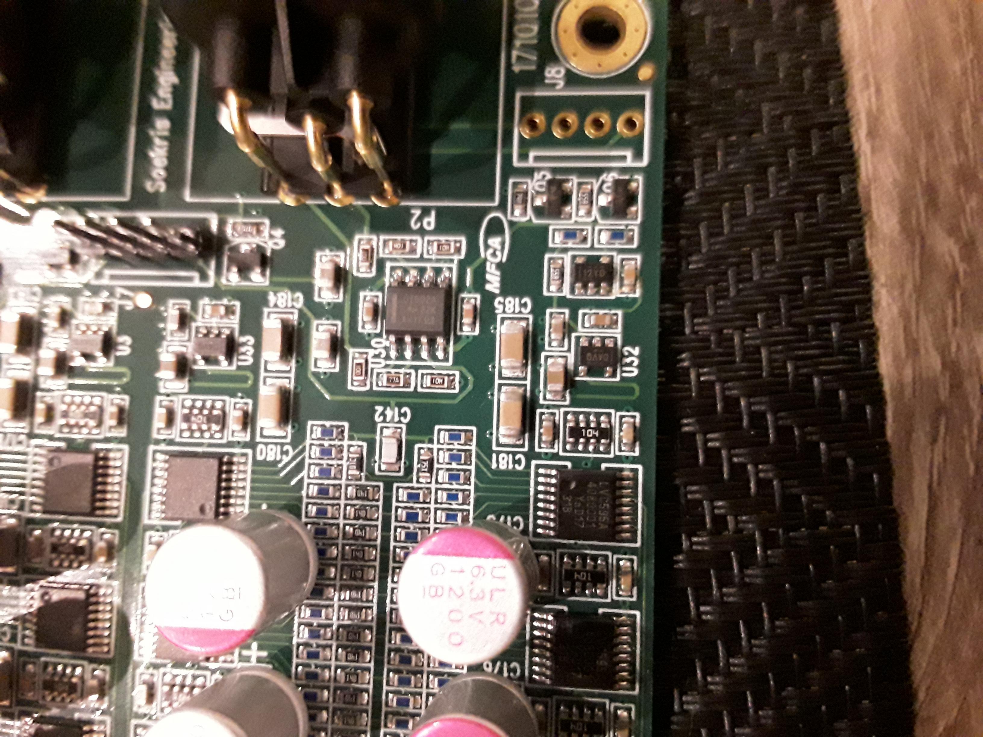

WARNING : if there is suspicion your DAC is deficient, and if you try the unbeffered output, check that there is no DC before pluging the amp.
I would take a long hard look at the shift registers for the left output, and compare them to the right output shift registers.
If you probe around, pretty sure you will find a difference.

Hello Randytsuch,
I probed the shift registers, here are the values for VCC
First row: 4.02V
2nd row: -4.02V
3rd row: 4.02V
4th row: -0.11V which is left channel
So You were right, something is wrong with the board, I checked with a Lense to see if something obvious could be seen, but i didnt find anything. I’ll contact Soekris service department for an repair/exchange.
Nothing else to do right?

I would definitely call them, and see what you can work out since sure seems like the board is defective. I would guess Vcc to the forth row of SRs is open, so you are not really getting a voltage there.
Could be an open via somewhere, I've seen that happen on PWBs, and they may work when brand new, but fail after a little while if the via had a problem to begin with.
BTW, power to the 2nd and 4th rows are actually -4V goes to the ground pins and ground goes to the Vcc pins. So the SRs see +4V for their Vcc, but they are actually at -4V relative to ground.
