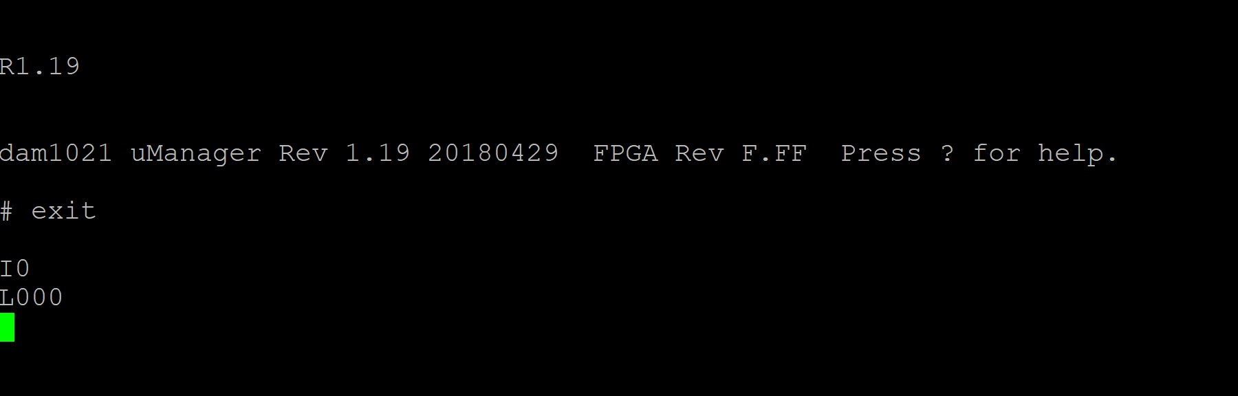

Hello, my Rev 5 board cames with 1.06 firmware, I have performed the firmware upgrade flawlessly to 1.19, with putty app, and reduced the fifo parameters, otherwise I could not achive the 100% upload. I have been listen in raw mode which is a good surprise...

OK, I've updated from 1.06 to 1.19 and I do have very distorted sound now. Audio was fine before. I've reverted back to 1.06 but sound is still distorted. Any clue?
EDIT: nevermind, shutting it down longer solved the problems. Thank you Soeren for providing the update!

I've sucessfully uploaded and updated new 1.19 firmware. Now it reads rev 1.19 and FPGA rev 1.19. Later today I'll try if everything is OK soundwise (no distorted sound, input lock etc.)
Firmware update was successful, in my case, only with old PC with real COM ports and Hyperterminal. (Windows XP)

Hmm...downloading 1.19 goes fine and says ‘downloaded and programmed’. But when I type the ‘update’ command it comes up with Incorrect Image to the right of ‘are you sure?’ Upon typing y it says Invalid Command. And after power cycling the green lock LED is solid on music but no sound.
Anyone had this? Must be missing something but I’ve tried going back to the 1.06 full package - which also says Incorrect Image after update but actually plays.

I too had an incorrect image message after update, but works OK on v1.19.
