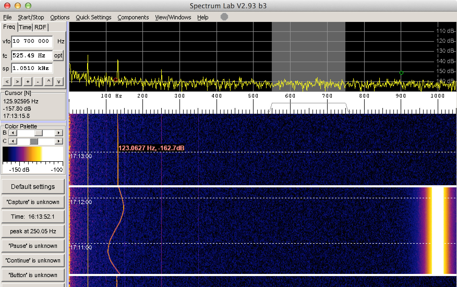

When measuring the DAM at the raw outputs I see in the spectrogram a (very) low level peak who's frequency wanders in a period of about 2 minutes in the range somewhere between 100Hz and 150Hz.
The peak only wanders if there is a "signal" (that is if there is an I2S input), otherwise it remains fixed.

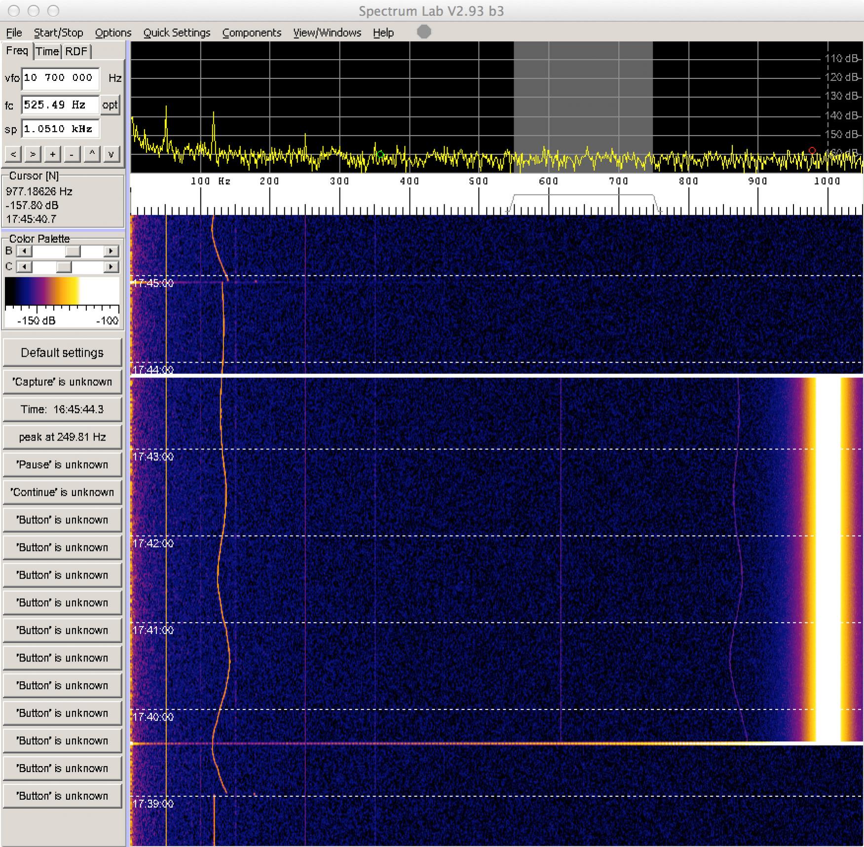

The wandering is damped (third picture)
It seams to be independent of the played signal (third picture, playing silence as well as 1kHz).

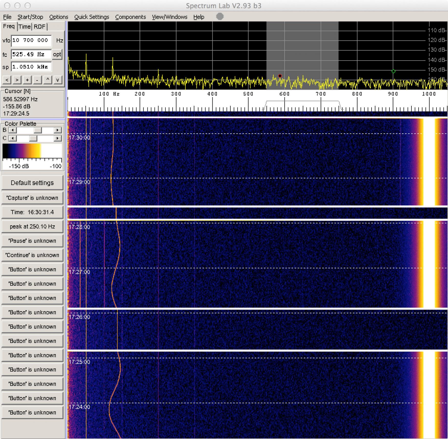

The wandering amplitude gets less with higher sampling frequencies (second picture).
I first took it for an flaw of the ADC, but have now seen it again with an other ADC and only with the DAM connected.
Have you any idea what this could be ... some artifact of the fifo reclocking mechanism?? Not that it is, at this level, of any importance for the sound ... just curiosity.
The ADC sample rate is 192kHz, 0dB correspond to an input of 3,16VRMS.
The FFT is of length 2^17 with van Hann window.
The DAM is a 1021 rev1 connected with USB via an Amanero.
First picture (from bottom to top) player stopped, a 1kHz signal with fs=48kHz is played for about 2 minutes (recognizable at the white beam to the right), player stopped.
Second picture (from bottom to top) with pauses where player is stopped, a 1kHz signal with fs=48kHz , fs=96kHz fs=192kHz is played.
Third picture (from bottom to top) player stopped, silence is played, a 1kHz signal is played for a longer period, silence is played, player is stopped for an instant and silence is played.

Probably, look like the clock tracking, but at -140 dB, who cares ? I haven't seen anything like that here, try moving the wires around....
Clock tracking? You described the algorithm as using a high/low watermark when you adjust the clock. Shouldn't we see steps rather than a soft sinus pattern?
No, I have described it earlier as tracking, that's why to me it looked normal, don't know how it got picked up, but -140 dB is not very much....
If you are willing to describe your clock handling I think many of us are interested.
I asked you if you had a watermark in the buffer, and when it was filled or emptied to the level of this mark, you adjusted the clock frequency. This is of course som sort of tracking but I assume this should mean stepwise tracking (changing of clock) and not a continuous sinus shaped change as the measurement somehow indicate.
Well, still, how could this create a tone? And why at 120 Hz? Strange...

I was more asking about the behaviour of the clock component on the board... if you order a 10 Hz increase - how will the 6 leg component execute that? Gradually or in a brute step?
The rate of change of that tone seem to be: 40Hz in 49 seconds i.e. 0,8 Hz/s. Thats much times higher than the PLL bandwidth so it should be absorbed - right?
With a PLL BW of 0,1 Hz we should not see clock adjust orders more often than every 10 seconds - right?
