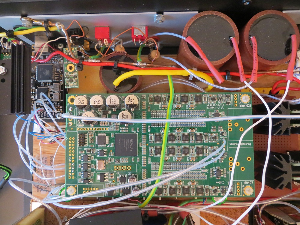

Just an update to my build. My case is a bit different as I am retrofitting the Soekris 1021 board inside a Lampizator L7 DAC. The Lampi originally came with both a PCM module and a DSD module. I replaced the DSD module with the Soekris.
The USB module is Amanero and its outputs are connected to the PCM and Soekris boards in parallel. The DAC boards are powered by NewClassD DEXA regulators. Outputs are switched by a relay connecting to a 2A3 tube output stage.
Attached a photo of the board inside the L7 chassis.
I can switch between the PCM module and the Soekris module with the push of a button, making comparison easy.
Soundwise the stock Soekris sound quite good but I prefer the Lampi PCM module as the latter has better resolution and finer details. I then came across the transistor mod posts so I ordered the parts and did the mod to the dam1021 module.
Now this is a major improvement! So much so that I now prefer the modded Soekris over the PCM module. With the transistor mod the dam1021 now has even better resolution and details, better separation and soundstage than the PCM module.
I was a bit hesitant in doing the transistor mod as soldering the SMD components is quite tricky. I'm now glad that I took the chance.
I'd like some inputs from fellow diyer's:
1. The two DAC modules now connect to the Amanero USB board in parallel. I wonder if this may degrade the sound? Any experiences on driving two DAC boards from the same USB module?
2. My dam1021 board is the latest version. Now that I did the transistor mod I wonder if there are any other mods that are worth doing?
Thanks.
Nice upgrades you did 🙂
That transistor mod is that with BC550/560 for the vrefs ?
Mods that I did:
- Cut the USB +5V power to the Amanero and add its own Lt3045 PS.
The Amanero benefits greatly from a better PS.
- Added extra capacitance to the vrefs and clock
- lowresmod (only necessary for my v1)
- replaced the four onboard regulators with muzgdiy regulators
So far it sounds very good, only thing I didn't try yet is the BC550/560 transistor mod
Thanks!
Yes it's the BC550/560 mods as described in this thread earlier.
> Mods that I did:
Agree completely. I powered the Amanero from a NewClassD regulator. Big improvements.
I'm wondering if the extra capacitance to the vrefs is compatible with the BC550/560 mod?
For the clock cap do you know where I can find information of it? Thanks.
> muzgdiy regulators
Interesting. I'll need to look into it.
Btw, how would you rank the improvements from the various mods you tried?
In my case the BC550/560 mod is similar in magnitude to the power supply mod to the Amanero USB module.
Yes, I've read somewhere that the transistors have no problem with it
Search this thread for my name and "clock" and you'll find it 🙂
The lowresmod had the most impact but that's because I have a v1 DAC,
the later versions have this mod incorporated.
Difficult to rank them but with each step it got better 🙂
