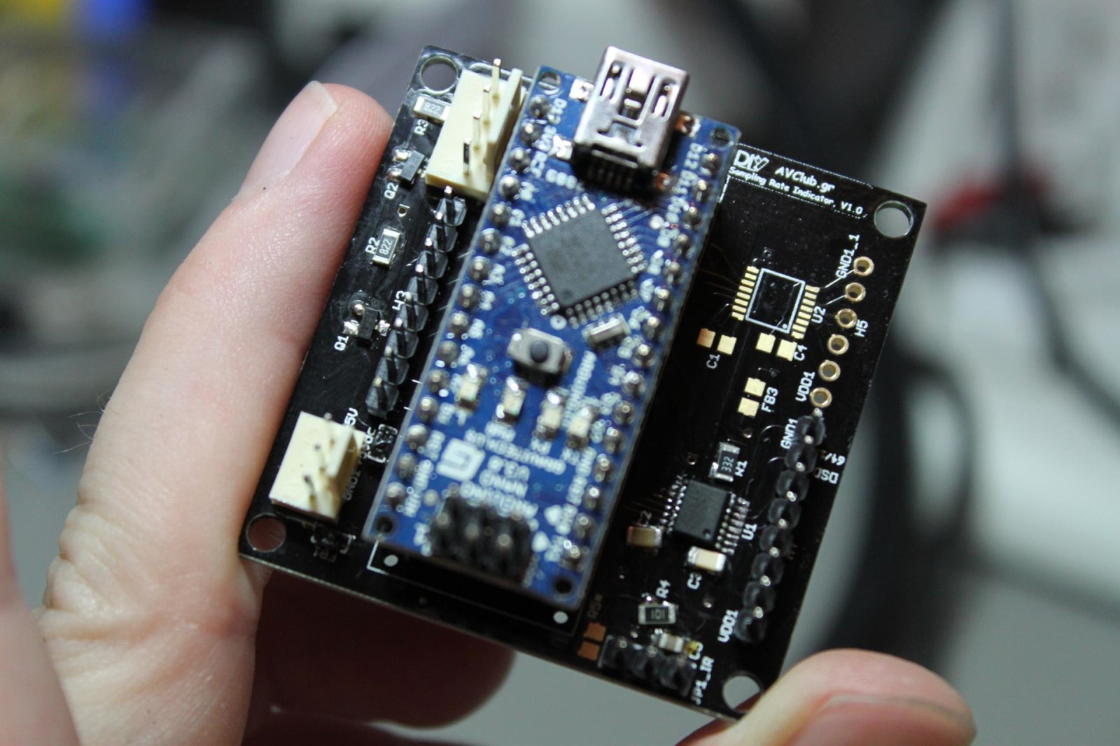

I've been doing remote control with an arduino:

Is it finished yet or? I just need volume control, so Lite version is what I need. Do you sell, group buy or something?
Regards
I'd say that the "lite" version is pretty much finished.
I don't sell and haven't bothered to do a group buy or anything. I'm not sure there would be much interest anyway. I do have a couple of spare indicator PCBs that could be modded to isolate a serial port and control the Soekris.
Perhaps if there is enough interest I could do a re-design specifically for the Soekris and do a small GB of PCBs.

For those of you talking about remote volume control, you might want to consider a rotary encoder instead of a motorized pot. For remote control, you already need a microcontroller. So you could also make that microcontroller interpret rotary encoder movement.
My balanced dual-mono dam1021 project is on hold at the moment, but that is what I'm doing. I'm using a Raspberry Pi as my micro-controller. Basically, the only dam1021 volume control is via the serial commands (not using any pot). And the Rpi brokers where the volume change requests come from, i.e. rotary encoder or software command (or remote control if I want to add that some day).
