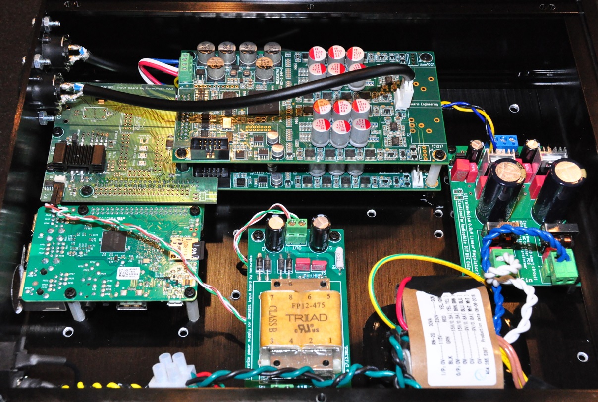

Anyone see anything obviously wrong with this setup? This is a balanced dual-mono configuration. I'm using Normundss' board to parallel the two dam1021s, and also use the Raspberry Pi as input. That "middle" power supply with the Triad transformer is the power supply to the input board. The two dam1021 boards are powered by the DIYINHK LT3042 regulator board.
This config was working perfectly until I made the following changes today:
So what's wrong? The top board is very inconsistent. Sometimes it works just fine. Other times, I get intermittent obvious distortion. This distortion isn't constant, it seems to be tied to certain frequencies (or at least certain musical passages). The worse case is very loud popping, almost like there's an intermittent direct short to the output (as it makes the drivers visibly move). I pull the amp power immediately when this starts happening.
It's definitely the top board. And that doesn't make any sense to me, because it's only the bottom board I messed with today. If the reduced power supply voltage were the issue, I'd think it would affect both boards.
Any ideas on what might be wrong?

The obvious suspects are:
1) Bad connections/solder joints caused by mechanical stress while assembling/disassembling the setup.
2) Are you sure the bottom board VREF caps are not touching the bottom of the top board? Can't see it in the photos.
Definitely sure on that front. There's at least a whole cm of clearance between the bottom VREF caps and the top board (I can get my finger tip in between).

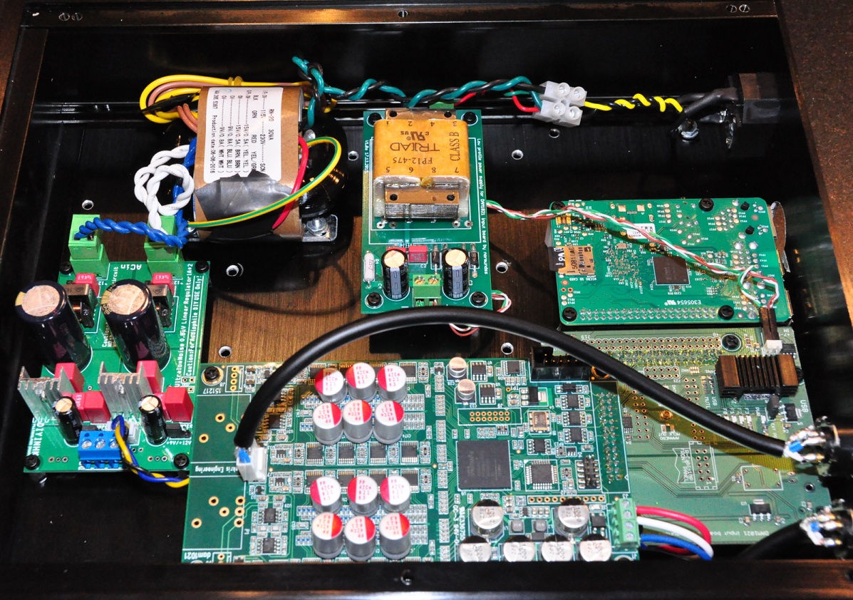

At any rate, I did some more listening/testing: it seems the "scratchiness" was sometimes coming from both speakers. So that made me think power supply issue.
I just put the original 15V/1A xformer back, and switched the regulator to +/-12V mode. So far it seems the problem is gone.
I could previously consistently replicate the distortion/scratchiness on one part of one song. At around 0:58 of the first song on DG's recording of Dvorak's 9th conducted by Karajan, there are some "dramatic" chords alternating between strings and horns. Whenever the horns sounded, I got the noise on either or both speakers.
With 15VAC+12VDC, I've listened to that passage multiple times now, and been listening for the last 40+ minutes, no weird sound artifacts.
So, it appears to be a power supply issue. I can think of a couple things: (1) 9VAC isn't enough headroom for 9VDC for the DIYINHK LT3042 board. Someone above mentioned it should work, but the board's silkscreen actually says use AC voltage that is desired DC voltage + 3. (2) Transformer couldn't supply enough current. I'd think 0.8A should be more than enough for two dam1021 boards though.
I'm using a 30VA Rcore transformer 2 x 9V and same regulator. The input voltage to the regulator is 11,2V AC. I'm powering 1 board. Works fine. I tested the regulator @ 300ma and still get 9V output.
So almost same setup, but powering 1 board.
Make sure to isolate the dac, the corner holes are all connected to ground so i use plastic screws.
Try to measure the regulator outputs not connected to the dac but with a 30 ohm load (300mA), do you still get 9 Volts?

You're powering 2 boards so 2 x 180mA = 360mA (positive rails). Try a load of 22,5 ohm (400mA). 5W resistor should work.

Interesting. Does your R-core have only 2x9V secondaries, or does it have more secondaries as well? If the former, then I suspect your transformer has way more secondary current than the one I was using.

I was thinking, though, perhaps I could use my DMM in ammeter mode with my current (working) 15VAC/12VDC setup. I could measure DC current between regulator and DAC boards; and also measure AC current between transformer and regulator. The idea is to see what kind of current is actually being pulled. However, I have a super-cheap DMM, not sure if it's fast enough to actually show peak current bursts...

30VA R-Core only 2x9V
I think the current is pretty much the same, independent of load & voltage. So no bursts. In your case it should be 2*180mA positive, 2*60mA negative.
What voltage do you measure on the input of the 2 dac's?
