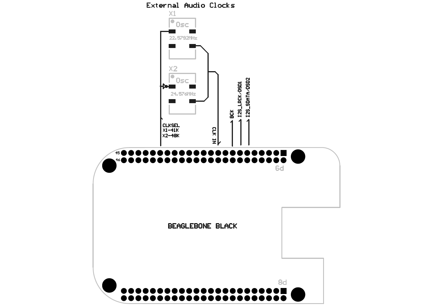

My understanding is that, because of the limitations of the BBB’s onboard clock it will resample all 44.1KHz family data to a 48KHz related rates – this may be audible – and, if the BBB is connected directly to the R2R DAC inputs the DAC will process the data at 48KHz, i.e. it will process the previously compromised data ‘as is’.
I was suggesting the use of an SO3 between the BBB and R2R DAC only as a means of keeping the native sample rates of the data processed through the BBB (in conjunction with the miero driver obviously) - are you saying this is wrong?
Ray
Apologies, I missed this point in my earlier post but are absolutely right.
The S03 will effectively serves as a clock module for BBB in this case. But then again you could use something simpler as shown to connect directly to Soren's DAC. Based on my previous post these clocks need not be top-end types as the Si514 on Soren's DAC determines the final outcome. If fact for BBB you can use its internal 24.576MHz and use a single external 22.5792MHz to make it even simpler
I will roll out the next version of BBB-UFL adapters with clocks options on board accordingly

Based on Soren's explanation his FIFO engine requires a programmable oscillator that is dynamically adjusted to manage a skinny buffer. This may preclude the use of native cut fixed oscillators of better performance and therefore to disadvantage.
I guess the next best option is to use Si570 that has better jitter performance. Soren has indicated against this choice before based on power consumption. Other than that I do not see other types of better programmable oscillators, so unless there is a radical overhaul of the FIFO mechanism the options for improvements this way are very limited.
