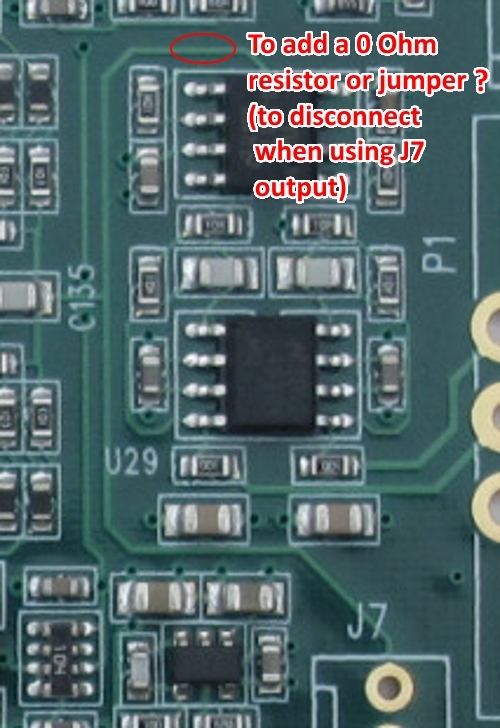

If we connect an external analog stage to J7, the DAC would need to drive onboard opamp and external analog stage concurrently. Would it degrade the sound? Should we add a 0 Ohm resistor or jumper just before the opamp so that we can disconnect it when using external analog stage?
