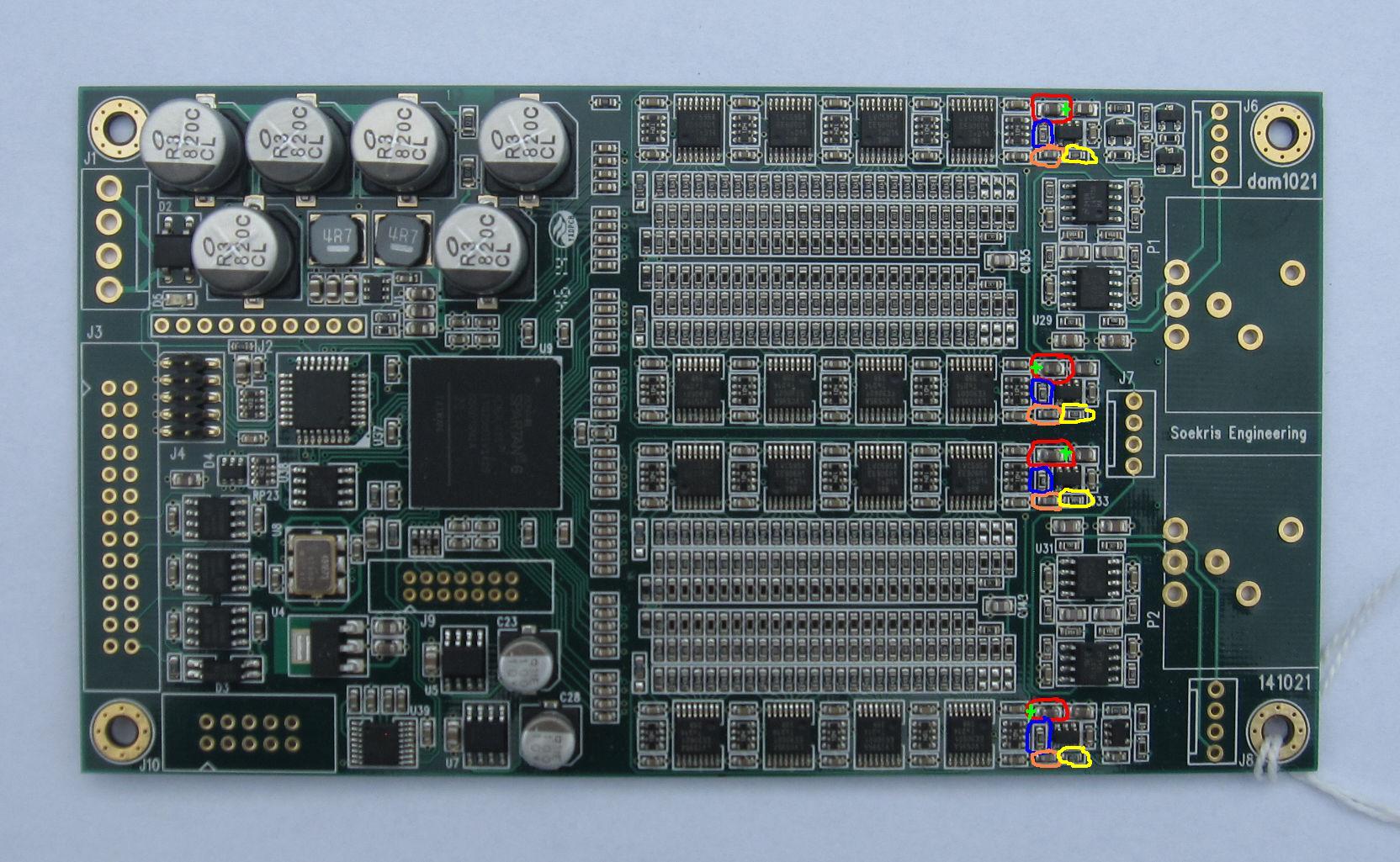

Sören: On the V3 boards, is the hole footprint for extra caps 3.5mm or what dimensions?
The holes are nom 26 mil - 0.66 mm diameter, most smaller caps up to Ø10 are spec'ed at 0.5-0.6 mm and should fit....
Btw, I forgot to mark + and - on the PCB, will mark a picture at some point, until then:
C166-C168, C172-C174: Plus is towards the XLR plugs.
C169-C171, C175-C177: Plus is away from the XLR plugs.
I'll recommend to verify with a multimeter....
For people who want to use two boards from different production lots in balanced mode here is how each of the four vref buffers look like from the factory:
Original rev1: 10R series resistors, 22 uF output capacitor, 330 pF feedback capacitor and 499R feedback resistor
Factory upd rev1 and prod rev2: 0.1R series resistor, 47 uF output capacitor, 499R resistors mounted in both capacitor and feedback resistor position, creating an effective 0.050R vref buffer output impedance.
Prod rev3: 0.1R series resistor, 47 uF + 3x 100 uF output capacitors, 1K00 resistor mounted in feedback capacitor position (orange), 301R resistor mounted in feedback resistor position (yellow), creating an effective 0.025R vref buffer output impedance.
Colors on attached drawing:
Red: Output capacitor.
Blue: Series Resistor.
Orange: Feedback capacitor (now used for resistors).
Yellow: Feedback resistor.
Prod rev3: 47 uF + 3x 100 uF output capacitors
Sorry Soren, you mean for each vref there are now 47 uF + 3x 100 uF (4 stacked) output capacitors?
No stacked parts, rev3 board now have an additional 3 pcs 100uF ceramic capacitors for each vref rail, see fresh pictures on soekris.dk website....
