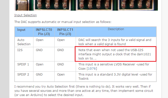

And I found another issue regarding signal locking, in hifiduino, it mentioned that for the I2S input, USB-I2S interface might output a clock that the dam1021 lock on to….
https://hifiduino.wordpress.com/2015/03/16/soekris-dam-1021-r-2r-dac-users-guide/
I do have this behavior in my dam, it doesn't really change the signal LED to solid green, however, in uManager I see L44 returns, so it thought there is 44.1 signal detected.
Is this a bug? Will it be able to fix in future firmware release? Thanks Soren.
