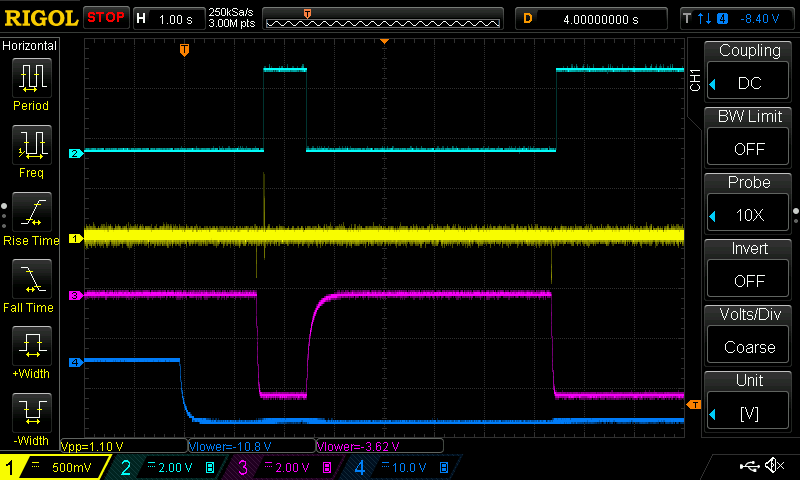

I have uploaded updated firmware, still 0.99 but dated 20150826. Can you please check to see if the problem you observed is still there ?
With the 20150826 firmware the problem is still there. The pin 18 glitch has actually become longer in duration.
With v0.99 20150826 firmware:

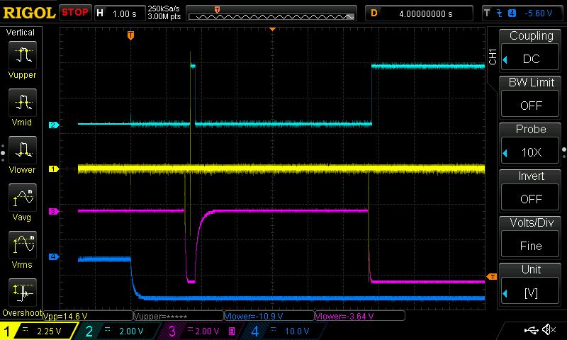

With previous v0.99 20150817 firmware (the measured output pulse amplitude here is off by 10x due to incorrect probe scale setting) :
