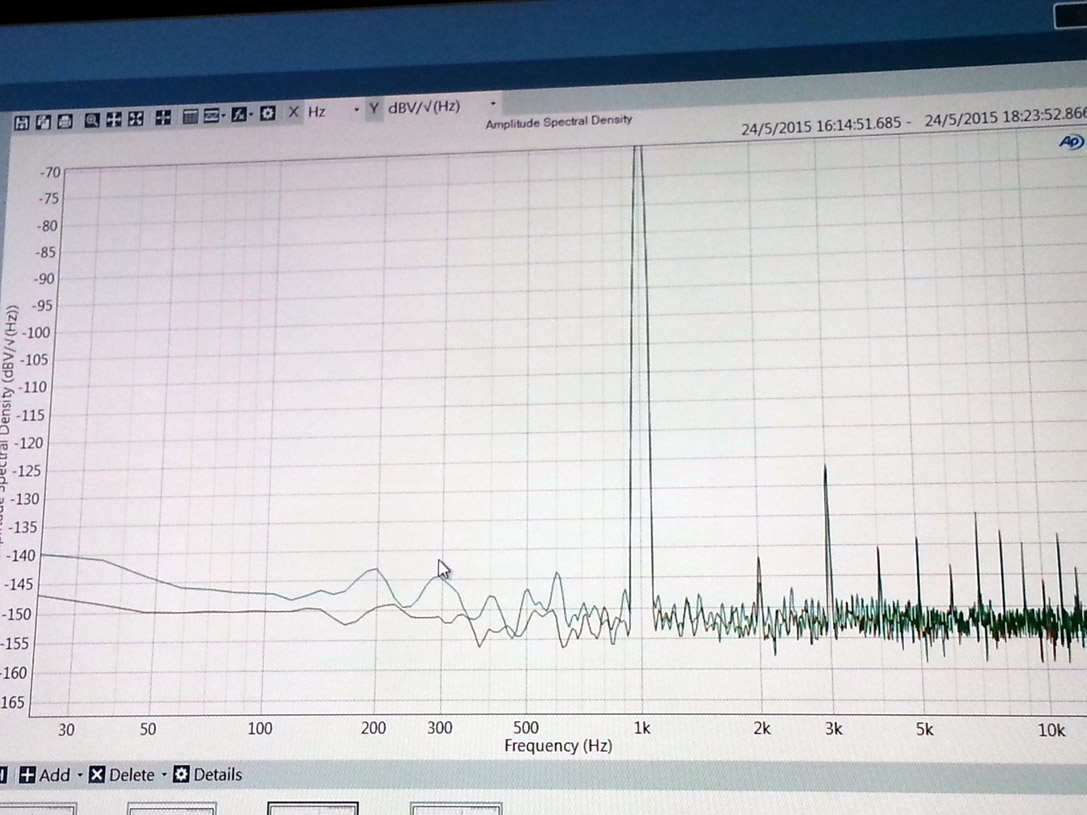

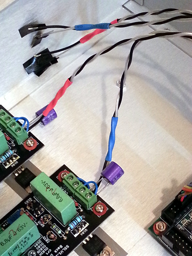

Yesterday, we tested the dac + BiB comb with an APx-515.
We identified several things which other DIYers (using BiB Shunt reg) need to pay attention to.
1. one may add cap at the output of BiB Shunt Reg (see pic below)
2. do not use remote sensing
After these two modification, FFT analysis showed that there was a drop in noise floor of about 20dB. Yes! 20dB! Simply by looking at the FFT graph, we founded that there was also slight improvement in harmonic distortion too.

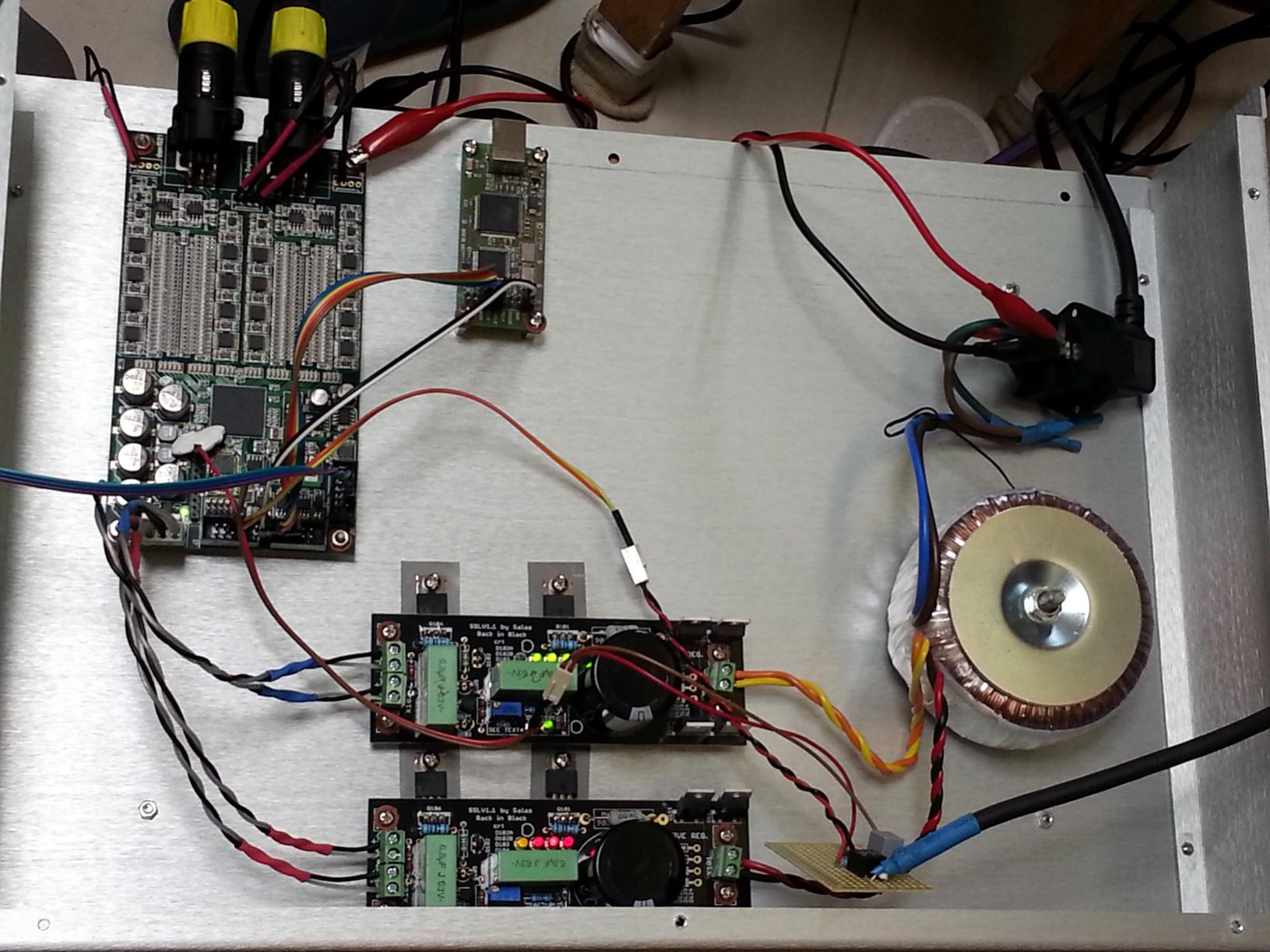

Note on Ground
Although it sounds like a cliche to most of the members here,
we have to iterate that the grounding makes a real difference
in the Dam 1021's performance.

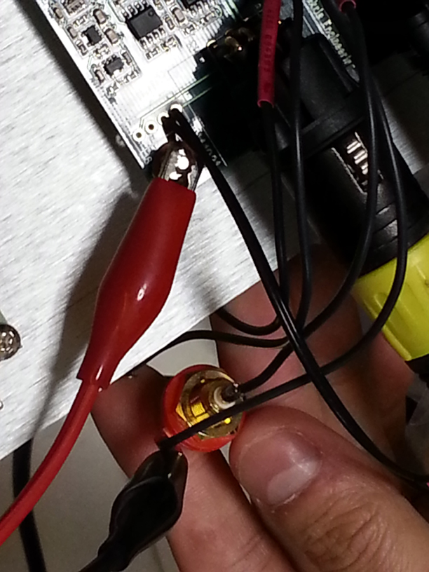

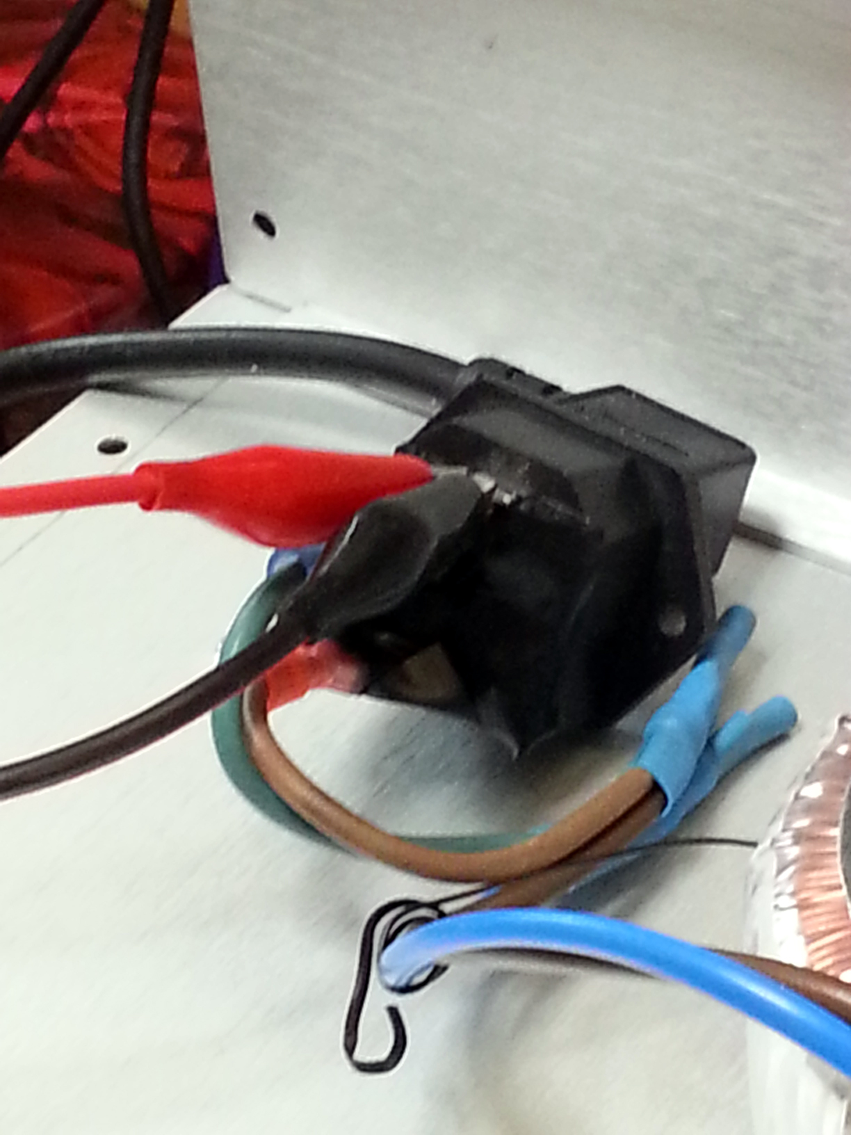

My Dam1021 had not put into a chassis. I put everything into a chassis
a day before I picked it to my friend's home, (he has an APx-515).
Everything did not connect to the chassis ground. The ac power ground
was not connect to the chassis (DON'T try it at home!!!).
We found that grounding the bolt near the left output
(see the red crocodile clip in pic) is the most effective in reducing noise due
to interference. Of course, it may relate to how one places the PCB boards
inside the chassis.

FFT at 1kHz
We compared the Dam1021 with a PCM1704 based DIY DAC.
At 0dBFS, the Dam 1021 shows higher distortion than PCM1704, about 10dB higher.
But, at -60dBFS, the Dam 1021 shows lower distortion than PCM1704, 10dB lower.
We are speculating that if Dam 1021 manages to produce much lower distortion at low
signal level than PCM1704, there may be some tricks that we can make it distortion lower at higher signal level.
The 67 pages AP report is too large to upload, only the FFT graphs under 96kHz sample rate are attached.

Arthur, re THD... i believe the curve tracks similarly to other discrete solutions. You can check MSB as well as TotalDAC where the THD at low level performs really well in comparison to the 1704... but the 1704 does better at 0dbfs.
I found that odd at the start as well but the similarities with other discrete solutions seems to suggest that this is normal and part and parcel of the chosen architecture and implementation.
