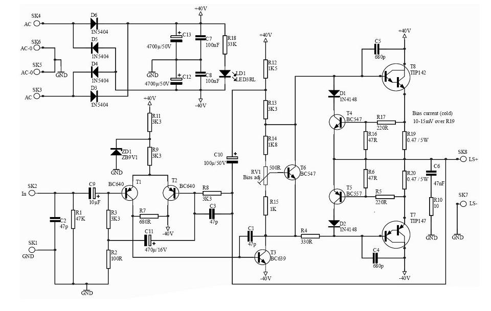

here's the schematic....supposedly 200 watts, is this possible?
I have had a few issues since 1st posting. The tip142 wasn't secured properly, got too hot and exploded. Replaced it and now it blows fuses once it is turned on. What would cause this? I would imagine something else in the circuit is blown to now cause the fuses to blow.

your amplifier as is
looks like a very insecure thing
42 volts for this amp is not a problem but working with loads lower of 8 ohms is absolutelly oyt of the question .....
for shure not only tip 142 was blown from not being properly attached to the heat sink ...somehing else is gone too .....

also this amplifier will produce about 60W at 8 ohms load but operating in lower load like 4 ohm will be stressing outputs like hell
you have to be very carefull with idle setting a bit too much idle will bring the smoke in to your amp
amplifiers working with these outputs may be simple but never stable upgrade option will be to use very nice metal can transistors from on semi MJ15015-16 diferent case but very reliable
amplifier needs a quiet big heatsink and vbe multiplier transistor 6, BC547 needs to be in very good thermal contact with the heatsink to monitor temperature and reduce idle respectivelly ....
amplifier like that if not made properly will oscilate like hell ...meaning that the usual methods like zobel with inductor decouplers bypassed here and there have to be installed .....
figoures of 200w as mentioned somewhere above is absoltuley out of any question .....you will never get them with an amp like that

Since the BC547/BS557 is only 'good' for Vce of 50V and depending on how the TIP142 blew up, there is a pretty good chance that more defective parts are involved and responsible for the (still) malfunction of your amp. The TIP142/TIP147 will withstand a Vce of 100V therefore no harm for them is expected with rail voltages of ±42V though.
A good point to start is the bias transistor T6. If he is blown and makes an open circuit both power stage transistors (T7 & T8) will conduct and draw a lot of current from the rails. Be in luck if they're not blown again and the rail fuse(s) always blow first. The current limiter T4 and T5 may be damaged too in the first place. Once they are blown, either open or short circuit, they will either never protect anymore or protect all the time.
Furthermore look for burned and/or discolored resistors and check for correct value(s) as stated in the schematic.
