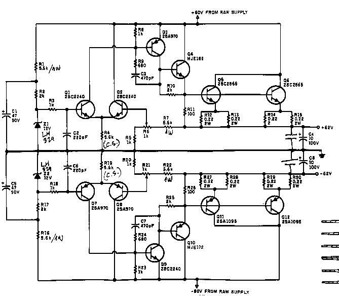

Use a voltage regulator circuit like the one from The Audio Amatuer for the GFA-555 amp. Do a search and you will find the schematic on line here. It does a great job and is easy to build.

It is very adjustable with the pot and using different ref voltages(zener) and handles lots of current with most any decent output transistor. I've used mjl21193/4, 2sa1302/2sc3281, mj15003/4 and many others.
