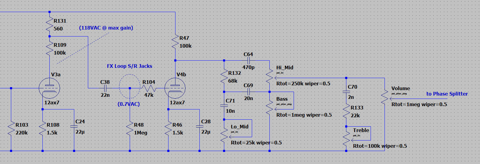

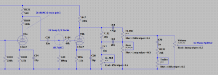

V3a is being heavily overdriven, and is intended as a common cathode stage.
Well, that opens up another can of worms. Do you want the heavily overdriven V3a anode signal to go to your FX send? The signal at V3a cathode is probably going to be less overdriven, lacking the distortion created by V3a itself. 🙁
If that turns out to be the fly in the ointment, as I suspect it will, then we have to start re-thinking the problem all over again.
If you have a signal that's more than 100Vpp on the anode (i.e. more than 30 volts RMS), and you need about 100 mV RMS for the FX send, that's roughly a 300:1 attenuation.
This means you could use something like a 1 meg resistor and a 3.3k resistor to divide down the signal. 1 meg will barely load the 12AX7, and 3.3k source impedance at the FX send should be quite low enough for a valve guitar amp.
If you insist on less than 3.3k source impedance at the FX send, your best option is beginning to look like a MOSFET. Easy, cheap, no extra valves or valve sockets or heater power necessary, and you can buffer that 3.3k send impedance down to a few tens of ohms.
Personally, I wouldn't bother...IMO, 3.3k send impedance is just fine. (So is anything up to maybe 10k.)

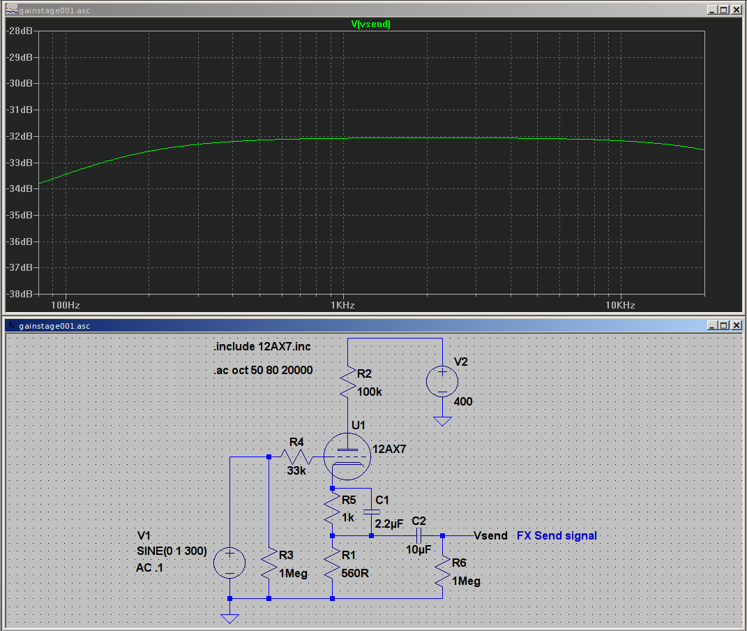

After some play testing, the tone is different coming off the cathode (as per the recent schematic) than off the anode. The overdrive is similar, but tonally it lacks the same punch as when the signal is taken from the plate. So yea, that idea is a no-go.
As an aside, I'm not married to the preamp circuit. I wanted to experiment with 5 cascaded stages, rather 4 (+CF) which seems to be an industry standard. Point being, nothing is set in stone and I'm willing to try just about anything. My only limitations are physical: room on the turret board, # of preamp valves, etc
The 1M/3.3k divider would work then. I didn't consider something like that because I'm still trying to fully comprehend impedance as a whole. I think I'm starting to "get it" though.

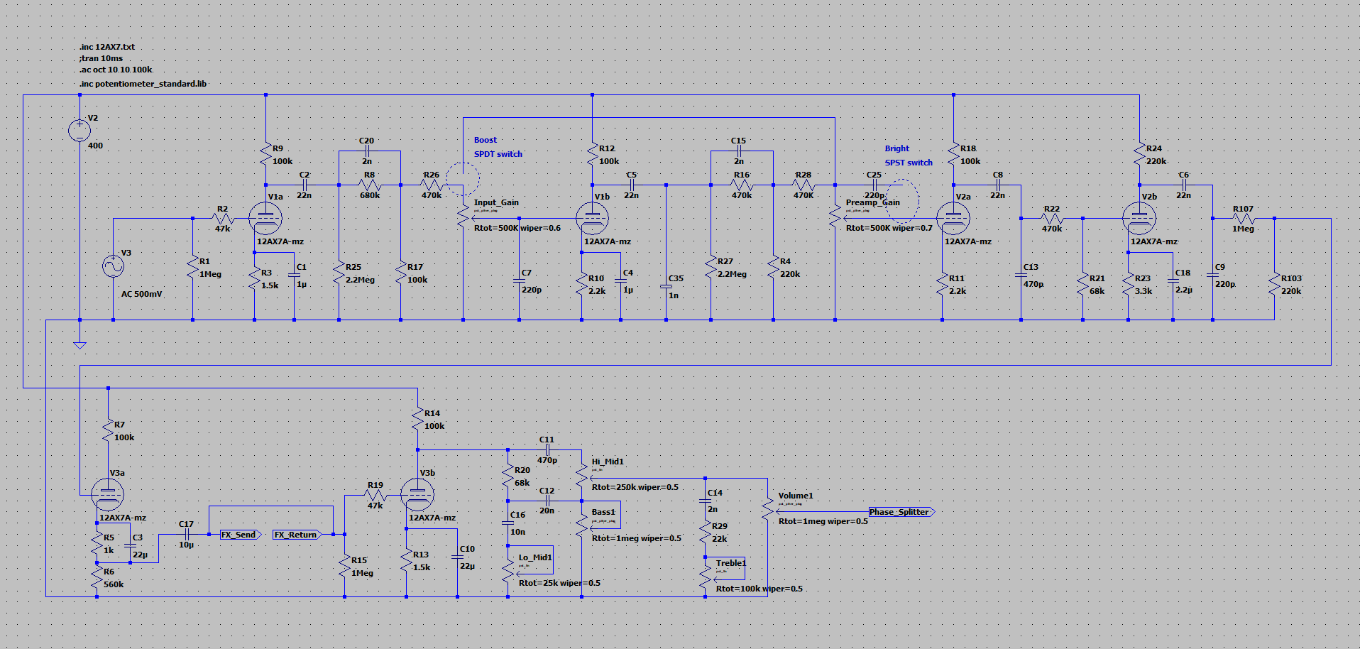

I've attached what I have in mind. I also scrapped a lot of the preamp circuit I had. I'd found myself tacking on components trying to solve one problem, but then creating another. Sometimes the simplest answer is the right one.

Just a thought - will you be elevating the heater of V3? With the grid of V3a at +200 volts DC, the heater shouldn't be at ground (0V), otherwise there is an increased chance of damaging the heater-cathode insulation.
I believe 200V is in fact the maximum allowed Vhk, and don't forget, you will exceed that by the amount of the positive signal swing. i.e., if you have a +100V swing on the cathode, it will momentarily go to +300 volts, while the heater is still at zero volts...
Of course V3b's cathode is nearly at zero volts, so you will have to split the difference when you plan your heater elevation voltage. Maybe +100V or thereabouts.
Incidentally, signal swing at V3a cathode is the other thing I'm wondering about. In a typical common-cathode stage, the cathode is sitting at about +1.5 volts, and so you will never get more than maybe 3V peak-to-peak out of it, making it relatively safe to feed to guitar FX pedals.
But your cathode follower has the cathode at +200V DC, (assuming the 400V B+ you showed earlier is correct. That means the cathode is probably capable of swinging at least 100 volts positive, and 200 volts negative. Conceivably, V3a could put out something close to 300 volts peak-to-peak, and that would definitely fry any guitar pedal seeing that signal.
So it's very important to make sure the input signal to V3a never exceeds two or three volts peak-to-peak. V3a itself is dangerously powerful, so you have to make sure the signal is properly throttled-down before it enters V3a. I'm sure that's why you introduced R57 / R59. Good call!
One other thing: when first powered on, the grid of V3a shoots immediately to half-B+ (200V). But the heaters are cold, so there is no current through R45, and the cathode is therefore at 0 volts. Now you have 200 volts potential difference between the very closely spaced grid and cathode...and that is likely to cause an flash-over, a spark jumping from grid to cathode, which can ruin the valve.
You can prevent this with a protection device between grid and cathode. The "classic" device is a neon bulb, or you can wire a 10k resistor in series with a silicon diode (1N4007, say), and wire the pair between grid and cathode, in such a way that the diode conducts if the grid goes positive of the cathode, and the 10k resistor then limits how positive the grid can go. (See the Valve Wizard's write-up here: The Valve Wizard )

There is also the extremely undersized 1 uF coupling capacitor to consider. At 80 Hz, it has an impedance of about 2k ohms, which has to be added to the output impedance of the CF + resistors, essentially doubling the output impedance of the entire send circuit.
Using a 10uF cap would have virtually eliminated this problem, and 10uF caps only cost pennies more than 1uF caps, worst case.
What a pity to double the send impedance simply by using an inadequate coupling cap!

So if we would make the 2.2K resistor 500 Ohms, the output impedance would be
103K || 500 Ohms = 497 Ohms PRR?
I saw the same Soldano clip Fozzy215. Maybe people don't like the loop because they try to use it with instrument level pedals. I called the design uncommon because I thought that most effects loop sends put the voltage divider before the CF, but I will look up some well known amp designs to check now. The DC coupled CF is undeed something that adds 2nd harmonic distortion, I have a feeling you are already familiar with this link The Valve Wizard
Cool that you spotted the too small cap Gnoboddy, I did not thought about it raising the output impedance, but since Soldano intended it to feed line level gear ( 10K-22K input impedance) I would also make it bigger to make the low end a tad more "transparant".
Does the 1M resistor serve a purpose?
Plus/minus the usual 10% or more...none of these numbers is exact because of component tolerances. Fortunately, for audio electronics, we rarely care if things are as much as 10% off-spec. (With some exceptions, like high-order active filters.)
Yes, it does! It's there to make sure the 1uF coupling cap has a path to ground, so it can finish charging up once the amp is powered on.
If you don't have that 1M resistor, the capacitor won't be able to charge. The left end of the cap is at a slight positive voltage, and when you plug the FX send into some other piece of gear, the input of that device provides a path to ground for the right end of the 1uF cap. So now the capacitor charges through the input of that external FX gear, and you hear a big "Thump!" through your speakers.
So the 1M is there to try to stop "thumps" when you plug the send signal into some external piece of gear.
