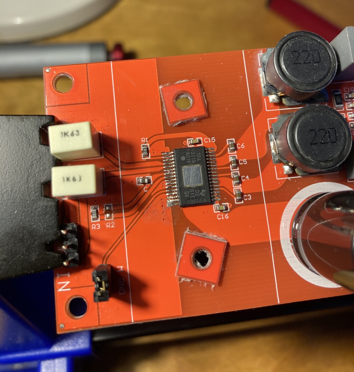

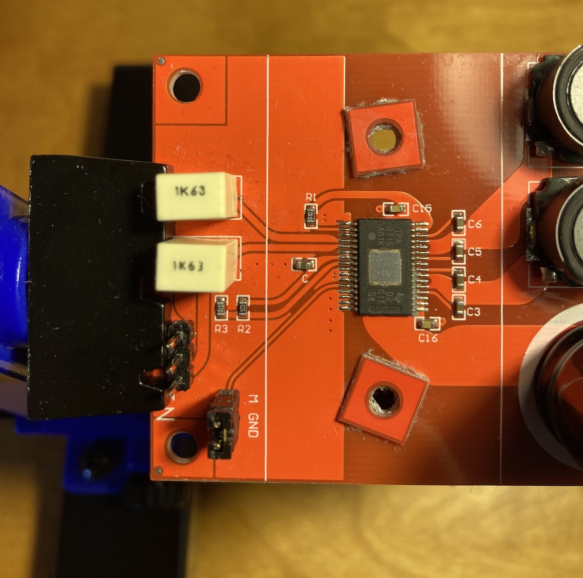

I bought a couple of the Chinese red mono TPA3116 boards on eBay, that have balanced inputs. I have connected them to a professional line level source (+4dBu) and they have far too much gain.
I started investigating what the gain value was set to on the boards and have been a bit confused by the resistor values:
R1 = 01D = 100kΩ (SDZ to PVCC?)
R2 = 473 = 47kΩ (GVDD -> GAIN - aka R2 on data sheet)
R3 = 01D = 100kΩ (GAIN -> GND - aka R1 on data sheet)
These are valid combinations listed on the datasheet, and it doesn't seem to match any of them?
Code:
MODE     GAIN     R1 (to GND)   R2 (to GVDD)
Master   20 dB    5.6 kΩ        OPEN
Master   26 dB    20 kΩ         100 kΩ
Master   32 dB    39 kΩ         100 kΩ
Master   36 dB    47 kΩ         75 kΩ
Slave    20 dB    51 kΩ         51 kΩ
Slave    26 dB    75 kΩ         47 kΩ
Slave    32 dB    100 kΩ        39 kΩ
Slave    36 dB    100 kΩ        16 kΩ
Closest appears to be Slave / 32 dB. But I would presume that it wouldn't work at all in save mode without a master.
Am I reading these resistors wrong?
Or have they chosen weird values?
Does anyone else have one of these boards and changed the gain on them?
Apart from the high-gain, the board is working well and appears to be sensible.
Really not excited about replacing tiny SMD resistors! 🙁
Thanks!
njh.

Hi njh,
You may be in the same situation as I with the red board:
TPA3116 D2 mono amplifier as a stereo system? , posting #57. If so, you may need to heat-up the soldering iron.
FF

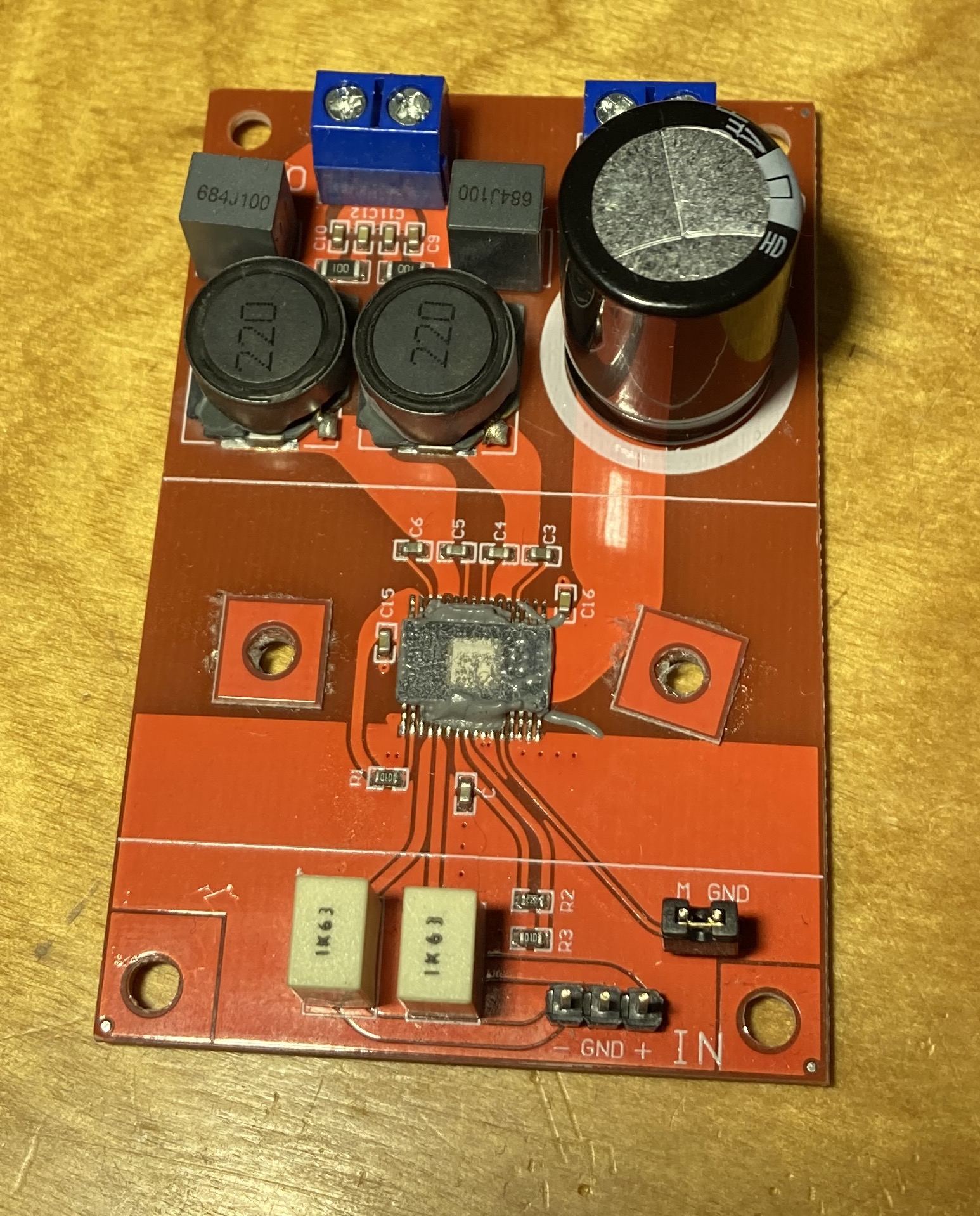

Pins 13-16, the last four on right are grounded. You can liberate the pin 13 by a scalpel to join it +V by 100k resistor. Your amp than runs at 1.2 Mhz.

That is the best way, changing feedback resistor can upset stability.
It isn't actually a feedback resistor. It is a potential divider that puts a voltage into an ADC in the chip as a way of configuring it.
That thermal paste all over the pins is conductive, made of aluminium or silver particles, you need to clean that up thoroughly to avoid future shorting disaster...
Thanks! I will give it a clean. I am fairly sure it must have been like that when I bought it 🙁

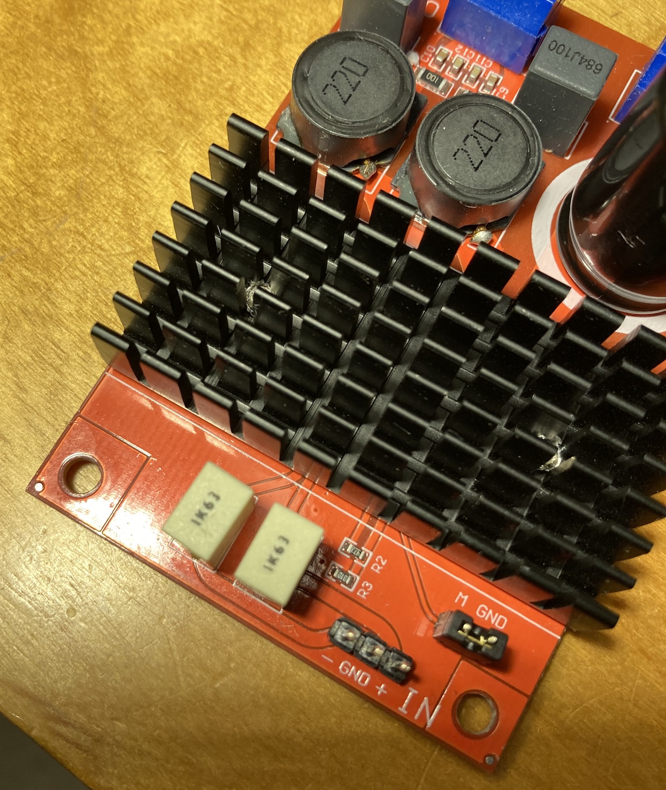

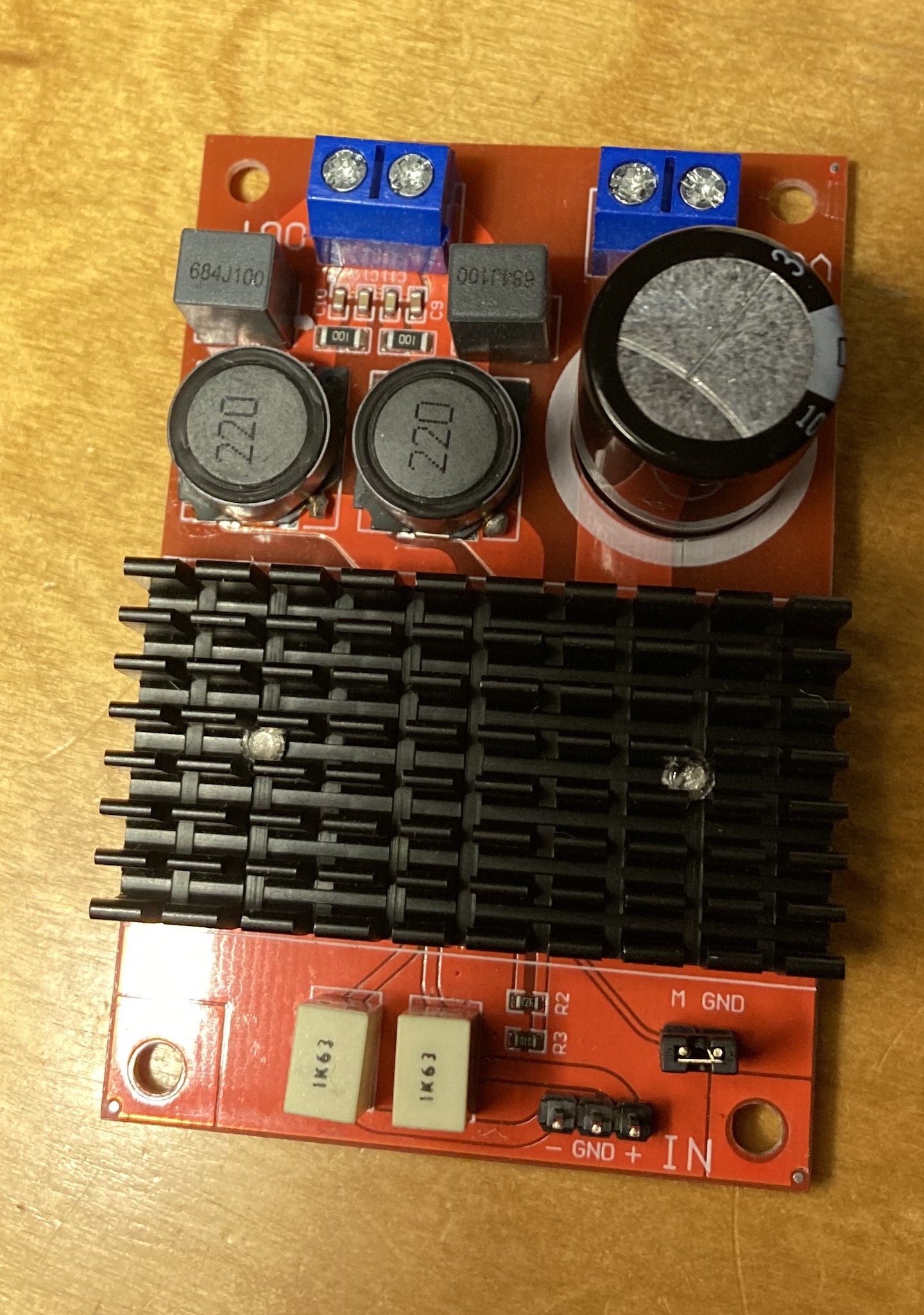

I think have successfully managed to reduce the gain to 20dB, as FauxFrench described in the other thread.
  1. I removed R2 completely - living it in the 'Open' state
  2. This leaves the 100kΩ resistor (aka R1) pulling GAIN to ground. This is much higher than the recommended 5.6k but seems to be fine.
  3. I successfully lifted the SYNC pin, so it is no-longer connected to ground. Hopefully avoiding the overheating issue that FauxFrench experienced.
Removing R2 was pretty easy. I used a largish soldering tip with a blob of solder and was able to heat both sides of the resistor R2 at the same time, so it floated straight off very easily.
I used a (sewing) pin to bend up the SYNC pin, while heating the pad with the soldering iron - again not very hard. I actually ended up snapping the pin off, semi-deliberately to avoid it re-connecting to ground again.
So very glad I didn't have to replace a SMD resistor...
With the reduced gain, the hiss (full volume, nothing playing) is almost inaudible, so a worthwhile improvement, I think :sly:
