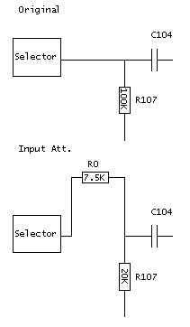

I will try to make this my last post on the BOZ🙂 . I built a BOZ for my friend and it sounds great but we can not get past the second click on the volume control as things get very loud very fast.
I am thinking that to decrease the gain I should increase R108 & R208.
Am I right on this?

Increasing R108 (and R208, if that is the right-hand channel) would do it. You could also decrease R104/R204. Or some combination of both.
Increasing R108 would tend to decrease your bias current as well. If you want to maintain the 40 mA bias, you should bump up the gate voltage accordingly using P102.
Alternately you could also put pads on all of your inputs to a greater or lesser degree (whateve it might take to get all of them at roughly the same input level) and put your volume control at the output. You'd get the added benefit of having all the volumes be roughly equal when you switch from one to another.
Erik

If I have the same problem, I would go for the fixed attenuator as in the figure. I could test R0 with different sizes. :yes: unless eLason or Mr Nelson Pass says :no:.

Yochim - You could use little linear-taper pots for each input if you like. That would save you from having to unsolder/resolder resistors in a fixed attenuator if you decide later to change your source gear around. (Or just want a little more or less loudness.)
If audiophile nervosa sets in, rest easy that such pots have been used in at least one well-thought of solid state linestage that I've peeked under the hood. 🙂 (Not sure if I should name names, so I won't.)
At any rate, you can measure the resistance from the adjustment pin to ground and divide it by the resistance of the pot as a whole to get the fraction of the amplitude you will see. (This is presuming that you hook the pot up as a simple voltage divider where the signal comes in "on top", the "bottom" is connected to ground, and you tap the signal from the wiper pin.)
You could also clip the ground lead of your multimeter to ground, and measure the voltage at the wiper pin until you get it just where you want it.
Erik
