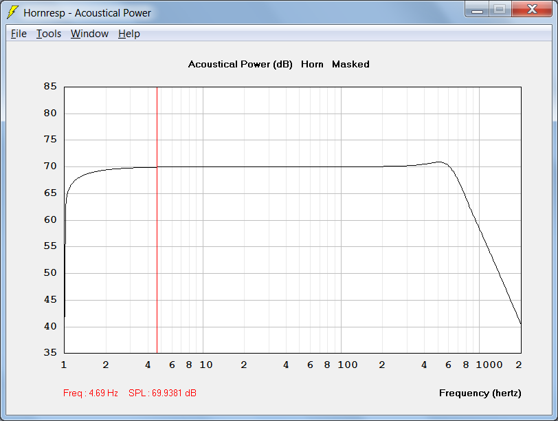

Hi William,
That is a great idea, but why settle for just 10Hz?
Let's pull out all the stops, and make it a 1Hz flare cutoff infinite exponential horn - ruler flat down to 5Hz... 🙂.

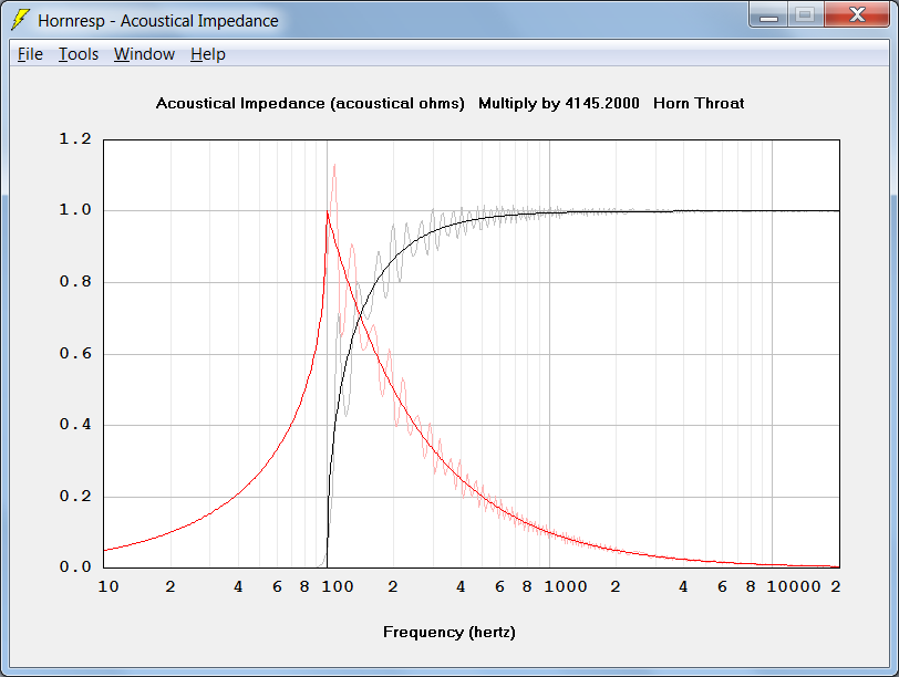

Eh... What does infinite mean? I know the option in Hornresp, but have not understood what type of loading that means.
As the word suggests, infinite means that the horn is infinite in size 🙂. It is a theoretical concept only - you cannot actually build one physically. Infinite horns are usually the starting point for any discussion on acoustic horns in the standard reference textbooks because they have simpler mathematical models than those of finite horns, and can give reasonably useful indicative results in simulations. This aspect is somewhat less important these days though, because computing power is now such that finite horns can be simulated almost as easily and as quickly as infinite horns.
The attachment compares the throat impedance of an infinite 100Hz exponential horn to that of a relatively large finite 100Hz exponential horn. As the horn length and mouth size are increased while maintaining the same flare rate, the ripples reduce in amplitude, disappearing completely in the limiting case of an infinite horn.
It's a thought exercise. Positive and negative infinity are used in mathematics to establish one or both ends of a continuum. All horns are compromised and being able to see what an infinite horn looks like demonstrates the magnitude of the compromise. It's an interesting feature but not one I've used often. I've never attempted to build one :cheeky:
