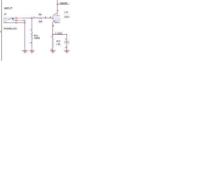

do i have to calculate the input from the cdplayer as if it were coming from another tube
signal -> Rg -> cgk ??? a resistor in series with the signal(rg->cgk) would set a ratio for decreasing the input signal thus risking frequency attenuation through cgk
(see attached picture)
i hope i explained myself a bit......

Datasheets use either or both, depending on what's appropriate. A bias voltage is DC, so that sets the peak limits for the AC drive.
In the circuit you show here, you can drop the gain easily by removing the cathode bypass cap.

@sy.... yeah i know, but it was used as an example, it's a different amp....
what does the 68K resistor do?? is this the ' input- reducer' and by placing such a resistor, do i have to take in acount the input impedance of my first tube or can i just use ohm's law to drop some voltage before entering the first tube??
The 68K will not reduce anything except very high frequencies. It's a slightly oversized grid-stopper.

so thats why 1,7v pk-pk dropped only to 1,6983v pk-pk.......

i was so fixed on this one problem that i overlooked something as simple as the input pot and it's value.....
simulated it with a circuitprogram and it turns out you can set ratios to the input voltage!! how could i've been so stupid to completely overlook this????
well i got my answer now!!
