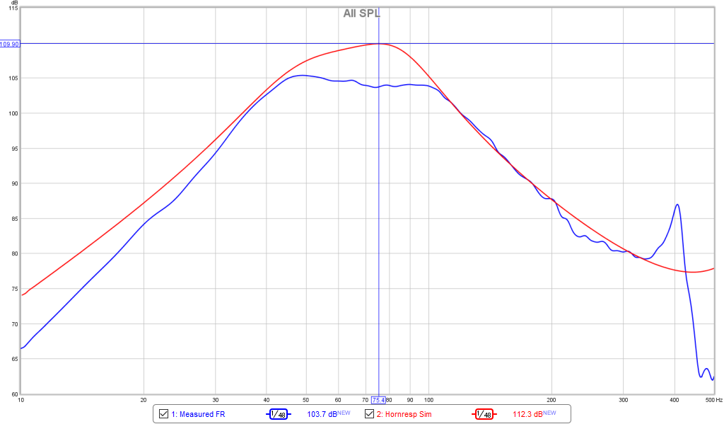

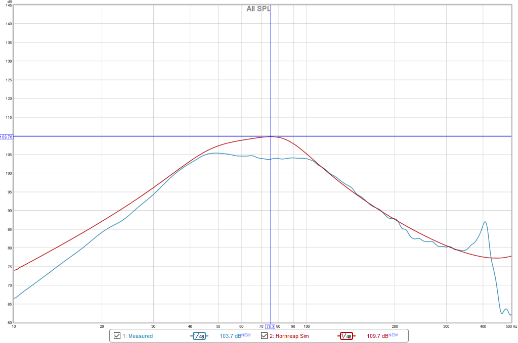

One of my earlier builds has come back to the roost. It's a 4th order BP design build around a driver from Madisound called the INF-10. It was a surplus driver, looks like from an Infinity subwoofer that had decent published specs for vented alignments, but when I tried using one in a vented alignment, it behaved VERY badly, exhibiting a loud cracking noise if even slightly over-driven. I ended up using it in a 4th order BP design, which maintained quite a bit more control over excursion at low frequencies. The design is document here - The Subwoofer DIY Page v1.1 - Projects : An INF10 Bandpass Subwoofer
Years ago I'd lent it to Dad for his HT system, but recently he upgraded it with a new amp that does not provide an amplified subwoofer output, so I retrieved it to do some tests on it.
The interesting thing here is that the measured performance of the build doesn't match the sim, and when I tried re-simming it in Hornresp instead, it STILL doesn't match. Fb is lower than predicted, the passband is wider than predicted, and the measured impedance is much more damped than the Hornresp sim (in Loudspeaker Wizard) suggests.

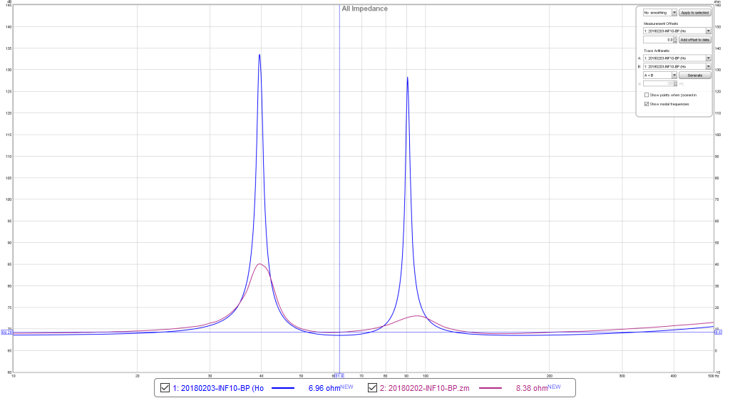

Well, here's the unstuffed INF10-BP's impedance curve compared to the Hornresp sim (which I've tweaked a little to reflect the same Fb). That upper impedance peak was way more damped than expected. I'm not quite sure what could be causing this. it kind of suggests that Fb is too high for this build, when in fact it's a bit too low. I'm modifying this build to increase it by at least 6~8 Hz.

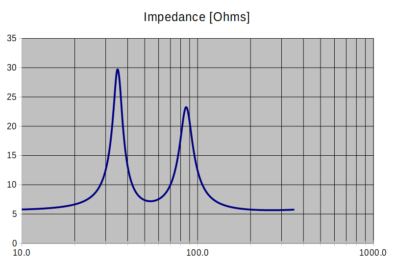

I get this with my simulator (note scale) using Ql=15, Qb=10 and Qp=20 (just random selections). F3l ~33, F3h~92Hz.
Could be a leaky box?
I thought that might be a cause, but if the box was leaky, I wouldn't expect that the minimum point between the two impedance peaks wouldn't be so low. And then there's the extra extension of the passband above 100 Hz that's not predicted by the sim.

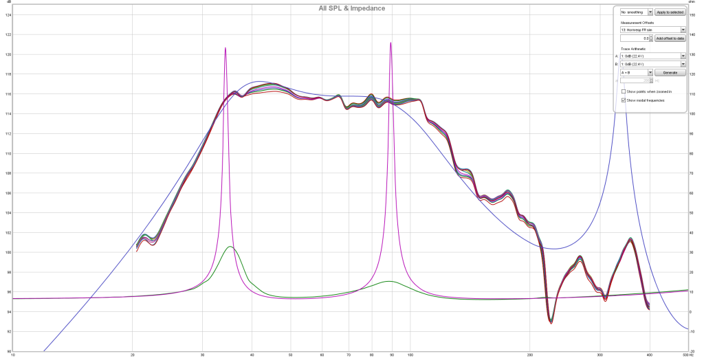

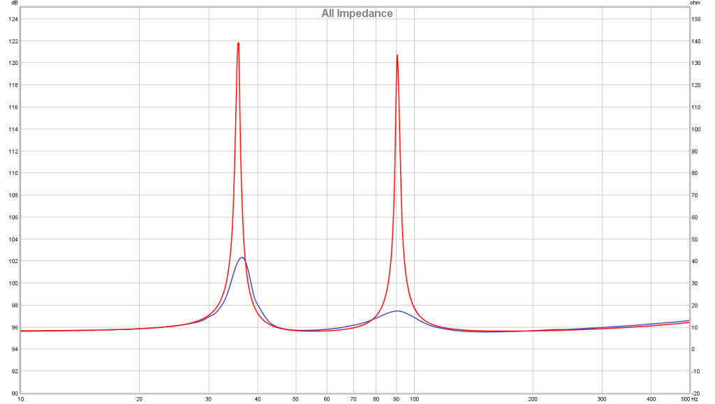

So, I basically went back to basics, and carefully measured the box again, measured the impedance of the driver in the sealed section (with the vented section open) and compared with the Hornresp sim, measured the driver's t/s parameters and made further adjustments until I got a pretty good correlation between the Fb predicted by Hornresp and the measured Fb. I also shortened the vents a bit to bring Fb of the vented section up a bit (it was too low). Then I put the vents back in, closed up the vented section, and measured the FR again, and compared it to the adjusted Hornresp sim.
This time I'm quite a bit closer, in that the location of the slopes on either side of the passband appear to be correct. The slope at the lower end of the passband is a bit steeper, but I put that down to box losses. But what happened in the passband? The measurements suggest up to 8.5dB difference between what Hornresp predicts and what I measured. I expected 2~3dB due to box losses, not 8.5dB! And the tilt of the passband is different too. And of course the big differences in the predicted vs. measured impedance curves still exist.

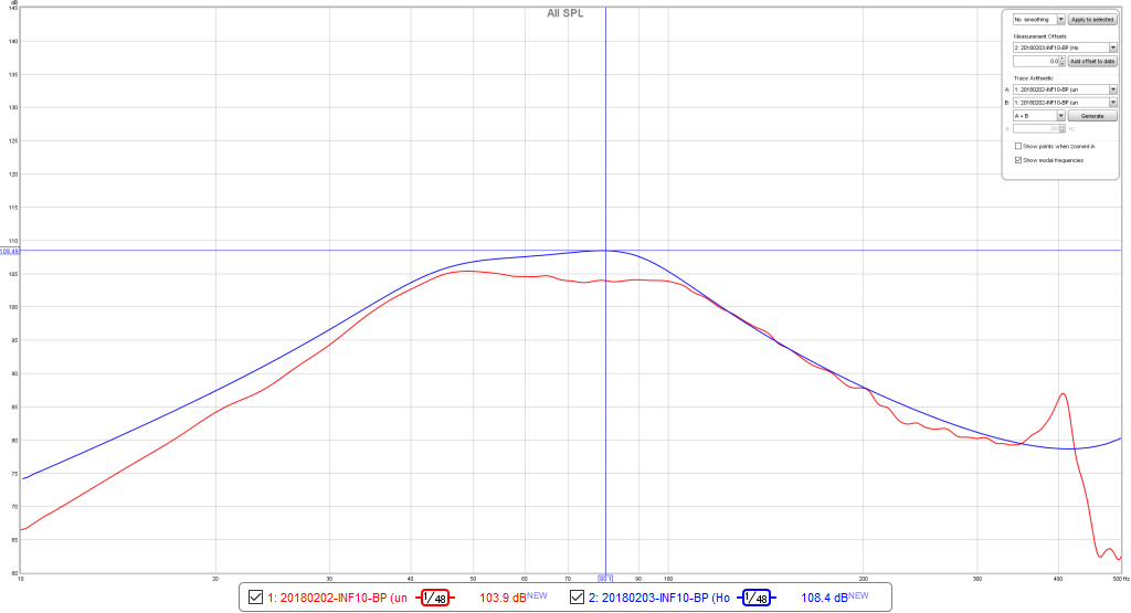

Something of interest has taken place since I shortened the vents a little. The big peak that was apparent around 400 Hz in the original build has diminished significantly in magnitude and there's a pretty large dip just a bit higher up in frequency. This leads me to suspect that the resonance at just above 400 Hz can be negated by selecting the appropriate combination of box dimensions and vent dimensions. Who knows - it might be possible to null it out entirely.
Ok, I just realized that I hadn't adjusted the relative level of the Hornresp sim properly. Looks like the difference is more like 6dB at its peak. Still significant...

I wonder if the 400 Hz peak isn't coming from the back of the woofer and angled just right to come out the port.
I like your measured response better than the sim. It may not reach the predicted SPL, but trading that for some section of flat-ish response is fine.

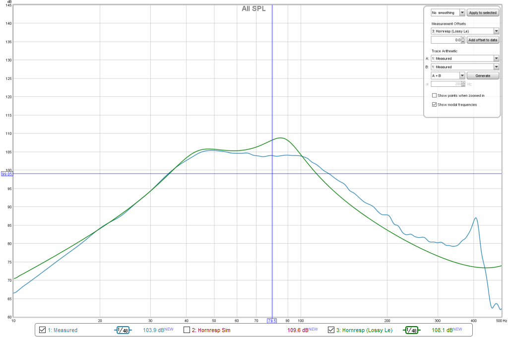

Here's a comparison between measured FR and a "Lossy Le" version of the sim. There is much better correlation between the sim and the measurements at the low frequencies, but it goes out of whack above 60 Hz and the upper cutoff slope does not match.

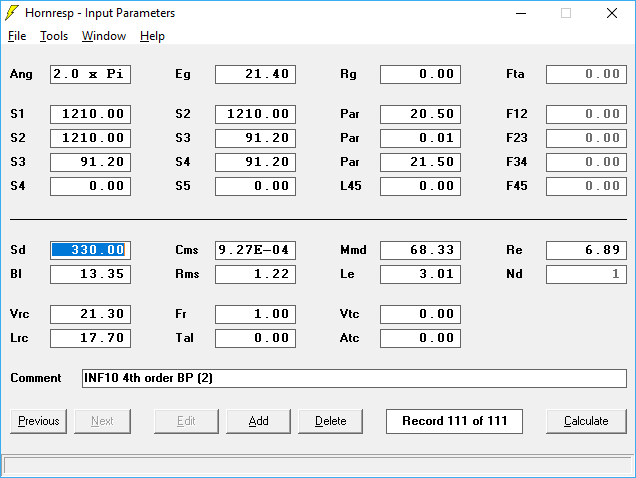

Hi Brian,

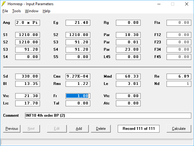

Would it be possible to post a screenprint of the input parameters window or alternatively a copy of the exported record file, for the simulation? Thanks.
Kind regards,
David
Hi Brian,
Kind regards,
David

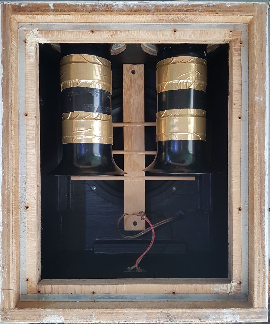

Here ya go. This is the current tweaked model that I'm working with. I've also included an image of the vented section with the access panel removed. This shows the only significant difference between the sim and the build, as the sim assumes that the vents are external to the vented section, when they're actually internal (and yes, the adjusted sim takes into consideration the volume displaced by the vents).

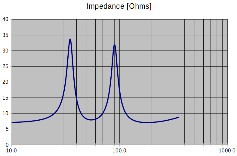

An adjusted sim using (from your screenshot)
Fs 20.0 Hz
Qts 0.317
Qes 0.332
Vas 141.78 Liters
Re 6.89 Ohms
Dia 20.50 cm
Vr=21.3
Gives modified (caused by sealed side) parameters of:
Fs 55.3
Qts 0.824
Qes 0.919
Vas 18.518
Then using (guesses)
Vf=18.7
Fb=57
Ql=15
Qb=Qp=30
Gives this:
Impedance peaks at ~35 and ~90 just over 30ohms
F3l=33
F3h=102
slight droop in the passband
Sigh, I found a minor error in the model, see corrected information below and attached....
Fs 20.0 Hz
Qts 0.317
Qes 0.332
Vas 141.78 Liters
Re 6.89 Ohms
Dia 20.50 cm
Vr=21.3
Fs 55.3
Qts 0.824
Qes 0.919
Vas 18.518

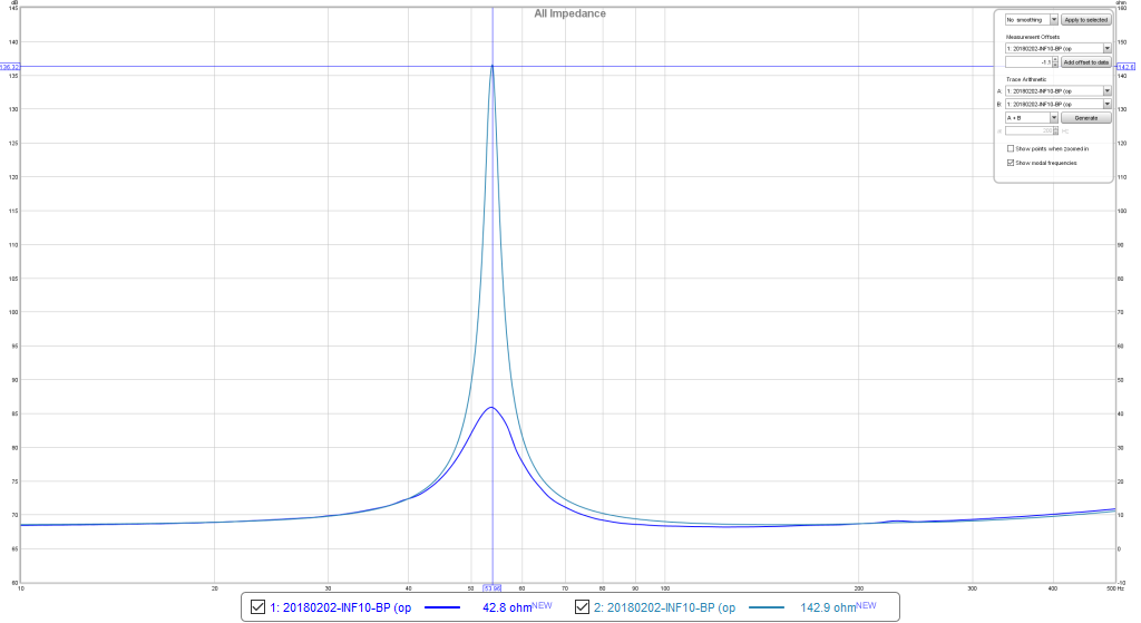

Fb is actually 54 Hz when the panel is left off the vented side, so that's pretty close. I basically took the panel off, took the vents out, laid the cabinet on its side (so the holes for the vents were blocked), then measured the impedance curve and compared it to a Hornresp model of a sealed cabinet loaded with a short "horn" with the same CSA and depth of the vented section.
Vf=18.7
Fb=57
Ql=15
Qb=Qp=30
Gives this:
F3l=33
F3h=102
Vf looks a little small there (I worked it out to be 22 l), and Fb a bit lower than measured. Depending on whether you use the minimum impedance or the zero-phase crossing to determine Fb, it lies between 59 Hz and 62 Hz.

Hi Brian,
Thanks for the information. Because the port tube is simulated using a horn segment rather than Ap and Lpt, no end correction is being added to the internal end. Attachment 1 may be a more accurate model, with segment 1 accounting for the internal end correction (0.1952 * Pi * Rp, where Rp is the port tube radius). The predicted system resonance frequency becomes 61.49 Hz.

Hi Brian,
Kind regards,
David
Hi David, I'd actually accounted for the end-correction in my sim. The vents are flared at both ends, and inside the box they terminate pretty close to the access panel and the sides (which are within 1 diameter of the vent opening), so I thought that the best way to work out the effective vent length was to measure Fb, and then work backwards to see what combination of S1-S2 and effective vent length (L34) would give a similar Fb. The actual "length" of the vents (minus part of the flare) is about 20cm each.
The build is actually in pieces at the moment, as I'm repainting the box (it is about 14 years old and the white paint had yellowed). but when I have it back in one piece again, I'm going to rerun the test with even shorter vents to see if I can at least flatten the passband. I would really like to know however where the up to 6dB of theoretical output in the passband has disappeared to.
