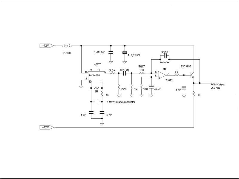

Its really not that complicated!
If we want to build a mono amp!
We dont need these:
-Common mode input (XLR) /U100,U101
-Compressor /U1B, U102B
-Thermal limit control /U4B,U4C,U3A,U3B
-sense of the output power (LED) /U2A,U2B
-clip detector /U1A
-distrorsion LED /U102C,U102A,U102D
-we dont need spleep circuit /U201C,U5C,U5D
-bridige /U101C
-stby /U5B
Mainb:
-crowbar /U2D, U7D,U7C
- and >10 OPamps
What we need:
3 OPamps for triangle generating (from 4Mhz precision)
1 OPamp input buffer
1 OP DC servo
4 OP (or less) for low pass filter <25Khz input
4 OPamp for error calibration
2 high speed comparator (MAX963) in 1 SO!, 4.5nS!, feeded with 0-5V signals, it also has SHDN pin which is simple to use.
fet drive: MAX5054 4-15V 4A! 20nS
Max ICs are for free samples
4 Opamps are in one packet so 4 SO/DIP can be used(4x4=16>15).
You can put very big current rated MOSFETs in the output stage! So you can achive 4 KW++ power, with ~90% effeince Maybe this inspires someone
We have to just work out the feedback to get a rock stable amp
Here is the stable working triangle generator without feedback, open with Multisim 9.

http://onlany23.atw.hu/Triangle.PNG
Here is the triangle generator, the original schematic uses 74AC02,74HC4024N,74AC74. So please prefer for those parts (my program only supported these parts)
There is only virtual crystal in the program so I couldnt
set to 4Mhz its running about 2,24...Mhz.
But its very sharp
I used a virtual clock source running @ 250Mhz.
The third amp is a simple integrator that changes the bipolar triangle into a 0-5V triangle.
Its needed because the comparator can only work in this range.
The supply (+15V -13V) is not important!
The results are the same when using +-10V for powering. You can find other OPamps.
This triangle generator is very simple, and its very (crystal) stable!
What about reinventing (just) the negativ feedback?
I think it could work with just voltage feedback, and without current feedback.
But its very sharp
