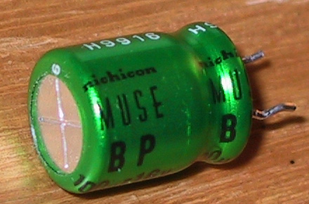

I pulled these Nichicon MUSE caps from a non-functioning DVD player. They do not have any polarization bar on them. Is it safe to assume that they are non-polarized? I will like to use them as high pass on 3" TBs in open baffle. They say: "nichicon MUSE BP 100uF 16V 85C" - should be enough for 30watts (Zen4).

They've got a BP printed on them and I'd bet my left one that it stands for bipolar. I don't know about the 16V rating on them though, that's rather low, and it's probably rated for DC...
