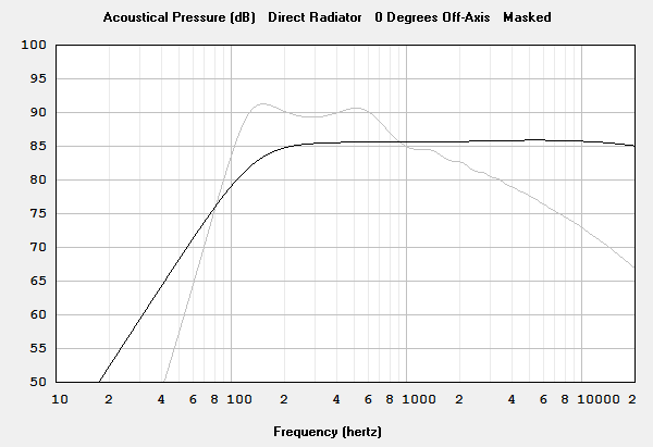

Spec-wise not all that well suited for a horn, though an 11" vented to Fb = Fs + some mids/HF EQ might work OK.
Faded line of course is the BR/horn output Vs the driver's IB + inductance BW, so above ~ 1 kHz the sloping line will be comb filtering with the flat line, so guessing 1st order around 65-6600 Hz to start dialing in.
