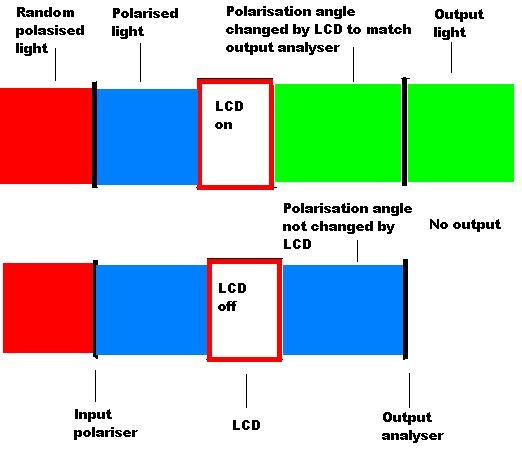

The attached image shows the LCD only uses polarised light.
For clarity I have shown the input polariser, and the output analyser separate from the LCD but they are glued onto the lcd
The input light (red) on the left contains random polarisation. Since the LCD can only use one polarity much of the random polarised light is wasted ie blocked from continuing by the input polariser. Light can be resolved into a P polarisation and an S polarisation. LCD use the P polarisation. The S polarisation component is totally wasted because it cannot go through the input polariser.
Obviously loosing half the light is a big loss but techniques to recycle the lost light are not simple.

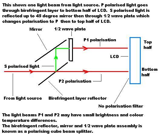

If we could pass the input light through a polarisation splitter first, allow the P polarisation to continue, change the waste S polarisation to P polarisation then redirect that light onto the input polariser it would also pass thus we would be using all the input light instead of half as we do at the moment.
One method is to use a semi transparent 45 degree mirror in the input light path with a polariser. Half the light goes through the 45 degree mirror. The half that is redirected by the mirror hits a polarisation changer, then another mirror sends that through to the lcd. So the LCD is illuminated in two halves. The left hand half by correctly polarised light and the right hand half by modified polarised light. Both halves of the LCD are now getting correctly polarised light and there is a much smaller fraction of wasted light.

The diagram shows a typical polarising cube beam splitter. Reference Patent 6206532. These units illuminate the LCD in two halves and there may be minor variations between halves which can be corrected by filters. Apparently only suitable for small LCD sizes.

Thanks remp, thats more info than I could have hoped for. Your great!!! So we could build this? I mean it doesnt look that bad to make. its a matter of parts and price really. The componenet list is:
Birefringent layer reflector
1/2 wave plate
standard flat mirror
Mirror is easy but where to get the other two is the prob. I'll have to search and see what I can come up with. The Birefringent layer reflector is just like those color mirrors that reflect all colors except one that passes on. Just this reflects undesired waves and passes the right ones. Then the 1/2 wave plate changes their direction of movement thus changeing the polarisation, I see know. I have a 5" panel so size shouldnt be the prob. for aligning the light on each half of lcd. I really wanna try experimenting with this theory, have to dig up the parts some wheres. On another note, I have my brother looking into some light traceing software and how to do it correctly. He's a CAD engineer so these prog.s make more sense to him than I. Hopefully he can add a little profesionalism to my deseign. He will be a great help with aligning the lenses and such as he's drafting out my hole layout of projector for me. So everything should be nice and centered.

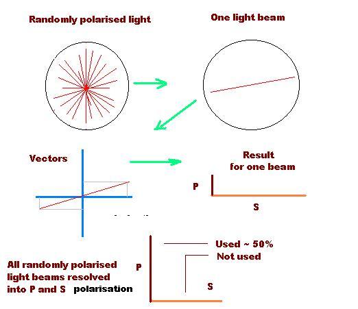

Attached diagram shows how a randomly or unpolarized light source can be resolved into P and S polarization.
