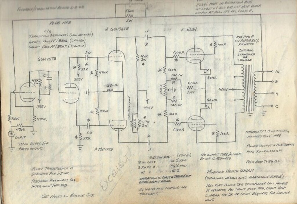

Ah, I thought so. ;-) The rectifier tube should be a 5AR4 to run the output tubes up where Dave Gillespie intended them. A 5U4 won't hurt anything but it drops a good bit more voltage than the 5AR4, like 30 volts or more. I think the amps would sound much better with 5AR4s. I built a pair of those and they're very very nice amps.
The Sovtek 5AR4 is actually not great. My 5V4G types sounded better but they are 175mA max. Voltage drop was similar. Don't have other types of 5AR4. The 5V4G is quite a bargain since it gets unjustly overlooked. It's my current favourite.

Yes, it's a VERY rich, deep sound! An EL34 Williamson is a wonderful amp. Good luck with assembling the JBLs, what a great project!
To answer your question, I did utilize an empty octal socket for an IEC connector, but really just for convenience. I don't think it's necessary.
Getting two SS diodes in series with the GZ34 plates won't help to circumvent the 60 µF filter capacitor limit. Putting them in parallel with the tube surely would, but also sacrifices the slow turn on feature and render the tube superfluous at all.I have not tried SS rectification with tubes. I have to say my favorite part of tube rectification is the automatic slow turn on out of the 5ar4/gz34. I use the trick of the 2x UF4007 diodes to have better switch off performance and be able to charge a larger smoothing cap with no issues.
