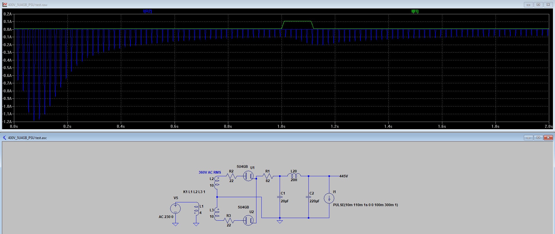

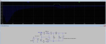

The secondary DCR + series resistor to anode, enough large for this load current. Increasing series resistor only makes a small difference of initial problem.
The initial charge pulse of empty C1 and C2 (via choke) about same order of magnitude (with these parameters). It's sum -if larger, than rectifier tube (depending on its condition) tolerate-, usually cause arcing.
In my practice both of them capacity much smaller (about half).
If you use larg/er/ capacitor in PSU than needful, the impulse response of PSU would deteriorates. This will be heard.
If you increase PSU impedance (larger series resistances), this also would be heard.

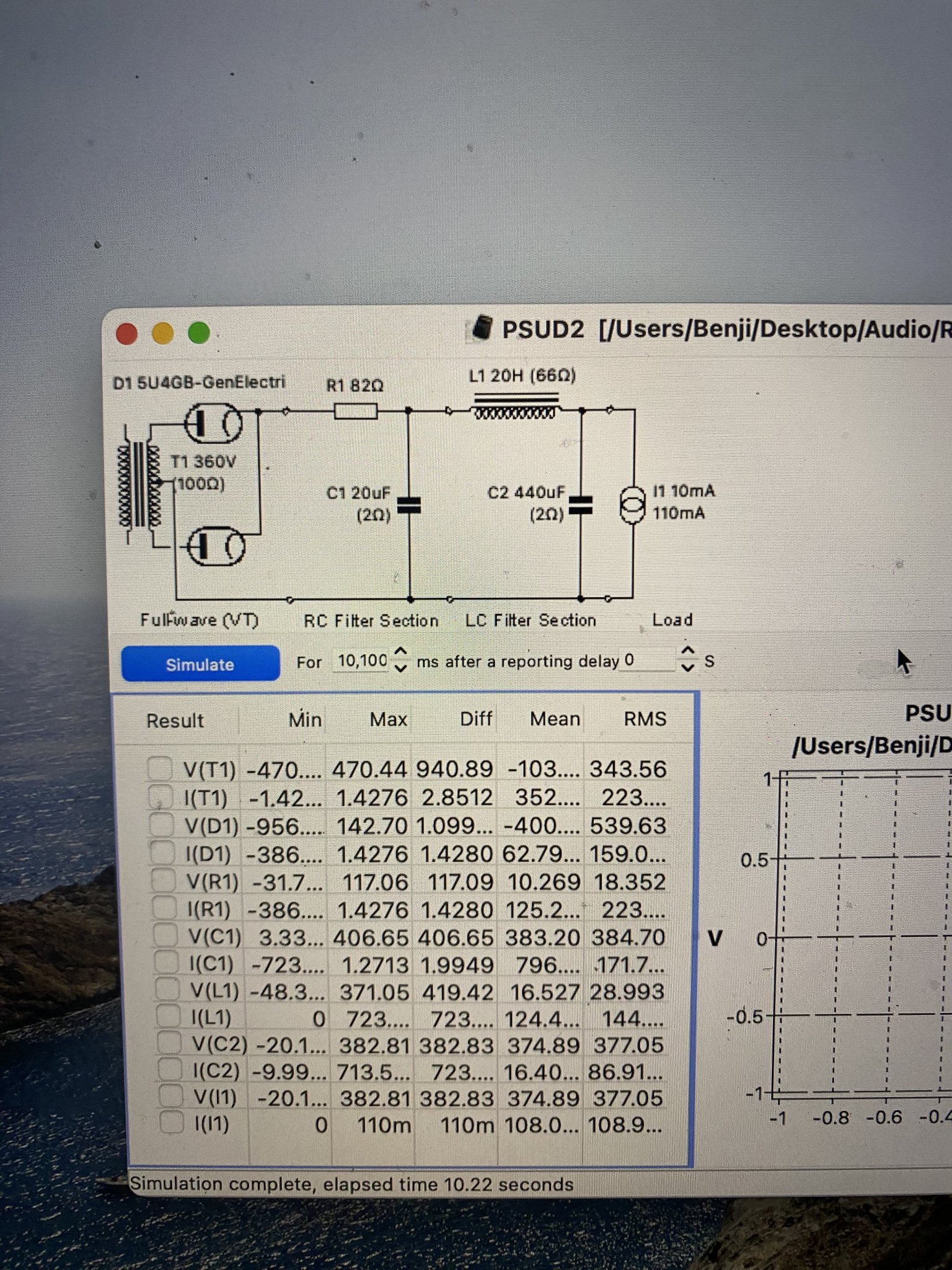

I did not see an arc in that video; the 5U4 just slowly warmed up.Here is a short video of the phenomenon(the sound at the end is unrelated!).
There's a short blue/violet lighting on the lower mica.
Anyway for starters I increased the series resistance of the anodes. Although I get absolutely no warning in psud2 I still get the arching at power on.
I my assumption that the tl783 regulator represents a low impedance correct?
At this point I will need to revise more thoroughly the psu design.
Can you confirm that once a rectifier tube arches it will have a tendency to arch even when used with the correct specifications?
I was under the impression that an arc was a quick, short, sudden discharge (a spark), not a steady blue glow.
