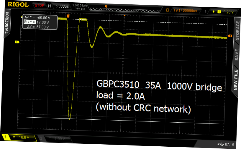

Last year I experimented with a couple of 35A 1000V bridge rectifiers made by Diodes Inc (datasheet). They were purchased from DigiKey so I don't think they were counterfeits or gray market devices or test rejects.
I found that the switch-off transient of these rectifiers induced a huge voltage spike in my transformer secondary. One representative experiment (of many) is shown below; the scope is displaying the transformer secondary voltage at the moment when the rectifier shuts off. The secondary voltage was about 17V when the diode shut off (cursor B) and the rectifier-induced voltage spike was more than 67 volts! (cursor A minus cursor B). A factor of 3.9X!

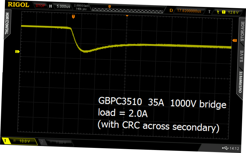

The second photo shows the same diode and the same transformer and the same load, with the addition of a CRC "snubber" network connected across the secondary. This reduced the magnitude of the peak, and damped out the oscillation.
I experimented with a few other bridge rectifiers (8A, 15A, 25A) as well. These were in the GBU and GBJ packages. They exhibited the same general behavior, big spike down plus ringing, as the 35A bridge. Unsurprisingly the 35A godfather device was noisier than all the others.

snip...I found that the switch-off transient of these rectifiers induced a huge voltage spike in my transformer secondary. ...snip...

Is it from the circuit inductance discharging due to a 2 uSec offtime? All the offline bridges typically run 2 uSec, I suspect that no matter how hard or soft it lets go, if it's less than 2 uSec, the circuit may still ring.
Are you able to determine if the ringing is characteristic of the circuit parasitics where wire dress/twisting/coupling can lower it, or is it just the winding inductance?

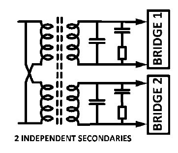

Hi there Mark (Johnson),
You seem to recommend a CRC snubber in any case... I'd like to try and see if I hear any difference/improvement. 😉
There's a pic attached here, taken from one of your articles. If fitted like this to the standard First Watt transformer with 2x 18V secondaries (230V/300VA), would you please recommend some values/parts to use? (I'm afaid my knowledge is very basic.)
Also in one thread you recommended APT100S20BG as an overkill unit, would this still be you opinion if wanting to go that route?

- STEP 1: Measure the leakage inductance of each secondary winding of the transformer.
- STEP 2: Look up the zero-bias capacitance of the rectifier you plan to use; either in the datasheet or in the SPICE model (parameter name = CJO)
- STEP 3: Choose a value for Cx, the snubber capacitor straight across the secondary. Make certain you choose a Cx value which is larger than (4 * Crectifier). Many diyAudio members find that Cx = 10 nanofarads meets this requirement for the rectifiers they have chosen. Be sure to select a capacitor which can tolerate the full secondary voltage.
- STEP 4: Choose a value for Cs, the capacitor in series with the snubber resistor. Make certain you choose a Cs value which is at least (15 * Cx). For those people who have chosen Cx = 10 nanofarads, Cs = 150 nanofarads is often a convenient value. Be sure to select a capacitor which can tolerate the full secondary voltage
- STEP 5: Choose a value for Rs, the snubber resistor which is in series with Cs. Select it according to the equation
Rs = (0.5 / zeta) * SQRT(LeakageInductance / Cx)
zeta is the damping factor; I suggest you choose zeta=1.00 unless you really know what you are doing. I suggest you select an Rs rated for 1/2 watt or even 1 watt; and I suggest you make it a "flameproof" type of resistor.
Done!
Some people prefer to avoid calculations like the above, so they use the no-Math approach to snubbing called "Quasimodo". It's explained on this website; look for threads with the word Quasimodo in their title, then download the .pdf file attached to post#1 in those threads.
Beware, you will need an oscilloscope. You'll use it in STEP 1 to measure the transformer secondary inductance; OR you'll use it with Quasimodo to select a snubber with no-math. In either case, you will need an oscilloscope.
