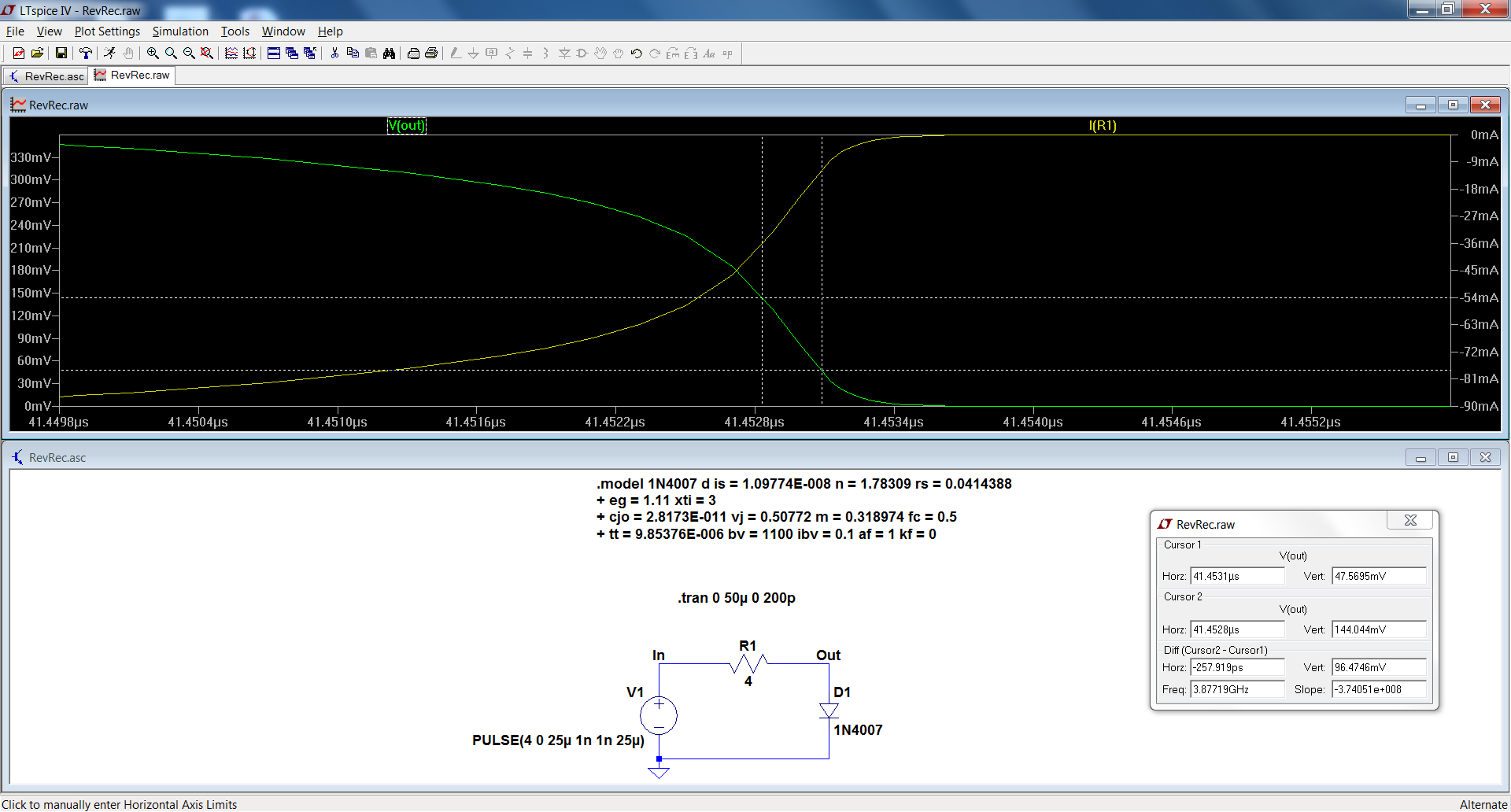

A diode is many things at the same time: depending on the where in the cycle you look, it can be a resistance (non-linear), a capacitance, a current source and a voltage source. Note that for my explanations, you could make a Thevenin/Norton transformation, it is equally valid.
The simplistic, textbook model of a voltage-controlled current source covers 99.9% of the behavior, but the most problematic part sits in the remaining 0.1% (or 0.01%), and that is the reason why I preferred to model the noise as a voltage.
In fact, during the reverse recovery phase, the diode has all the attribute of a voltage source, to the extent that it can actually supply energy to the outside world, without external bias or anything.

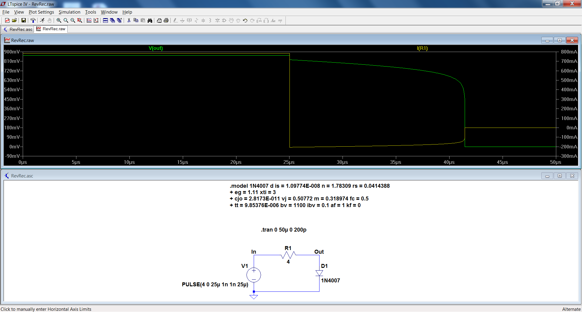

Since you're a fan of spice sims, I will illustrate that with a small sim, I think it will make matters much clearer.
The circuit applies a forward current of ~800mA for 25µs to the diode via a 4Ω resistor. Then, the source is turned off, leaving in fact the 4Ω in parallel with the diode.
You can see that at the switching instant, the voltage across the diode does practically not change, except for a small step: the diode is now actively delivering energy to the resistor, and it is very different from a capacitive discharge, because the voltage stays almost at the same level for a plateau of ~16µs.
The amplitude of the small initial step is ~43mV, and the Δi is 800-(-200)= 1A.
Thus, for all the recovery period, the diode behaves like a ~800mV battery, and an incredibly stiff one because its internal resistance is 43mΩ.
This undoubtedly makes it a voltage source.
So far, it is a rather innocuous one, it is simply a DC source that will not generate interference.
When the plateau ends, interesting things begin to happen: the second pic shows a zoom of that instant.
When all of the stored charge have been exhausted, the voltage (and thus the current in the load) collapses with an extreme brutality: the slew-rate reaches 370V/µs, yet the absolute value of the variation is small, a few hundred mV.
It is at that instant that a spray of RF is emitted.

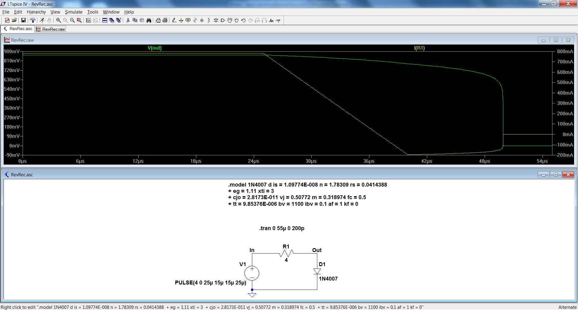

You might also object that what you see is a result of the stimulus being too fast: the transition time is 1ns.
In reality, this is not the case: if the transition time is increased to 15µs, the final collapse remains as nasty: this means that the noise source is completely autonomous, just like an independent step generator
Obviously, if the slew rate of the stimulus is decreased much further, things will calm down at some point, but there will always be a small residue of HF: it will have a much lower amplitude and will be hidden in the low frequency waveform, but it will be present.

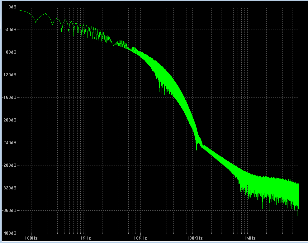

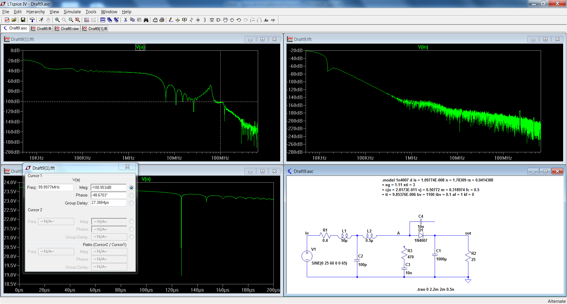

Elvee, you have tried twice to present simulations showing shunt-capacitors-across-diodes performing better than snubber-across-transformer. Both times you failed. Your halfwave rectifier simulation showed that CRC snubber gave smaller FFT artifacts and smaller time domain amplitude, than shunt-caps-across-diodes. Your fullwave rectifier simulation showed that both approaches produce common mode voltage because mismatched diodes / mismatched capacitors are inevitable. Neither circuit is best.
Would you like to try a third time? Would you like to present a SPICE simulation which shows shunt-caps-across-diodes clearly and obviously outperforming snubber-across-transformer-secondary?
Or perhaps this simply cannot be shown in simulation? SPICE is not up to the task?
Okay, Elvee, if you change your mind and create a third simulation comparison I would love to see it.
Meanwhile I got curious about your second transient waveform plot (common mode voltage, A&B) in post #17. Visually it appeared that those 60Hz waveforms were smooth and slow moving, but I wondered whether there might be some snap-recovery fast behavior buried inside. It was fun to learn how to nudge LTSPICE into making an FFT plot of a waveform arithmetic expression "(V(A)+V(B))/2" ! Finally I got the FFT displayed below. Not much is happening above 6 kHz.
_

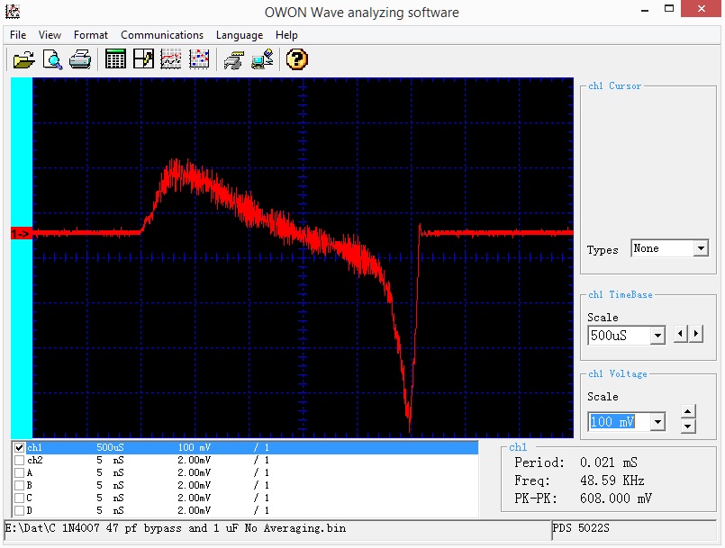

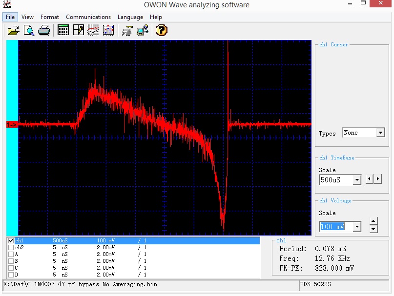

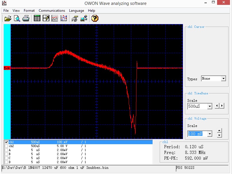

Here are actual results of 1N4007 diodes.
Notice in the first one how much line noise is let in during conduction.
The second has on diode snubber caps. Noise down due to scope averaging! (Probably just confusing as it is the same as the first!)
The last use transformer and diode snubbers.
The line noise was increase by a buzzer powered through a step down transformer.
Mark,
We just gotta keep disagreeing. John Curl also places a 10 uF capacitor across the AC line for his good preamps.
