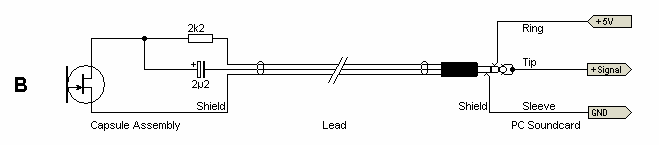

Go back to the link in post #4 which shows how to power an ECM capsule.

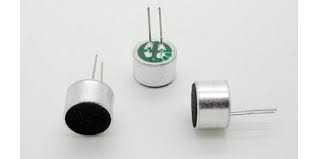

Is this the circuit you are referring to, Mooly? I shall connect the ring to 5V DC, right? And the same cable must connect the 2.2kOhms to the positive pin of the capsule? Similar with 2.2uF capacitor, it shall be connected to the tip and the tip must be connected to +Signal?
The pinout of the connector is different from what PRR wrote in the bird sound thread.

Maybe that's why it doesn't work.
I'll try to configure this circuit and see if I can troubleshoot the problem.

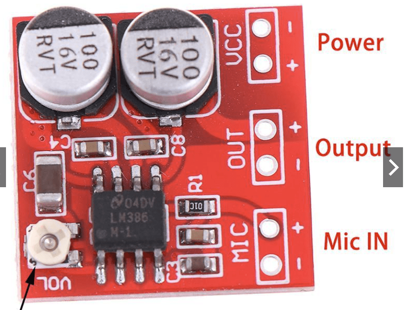

Good day! I disregarded the LM386 pre-made module (picture on the first post) and made a circuit from scratch (will share the schematic soon).

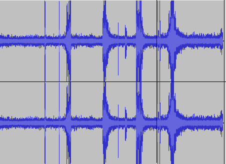

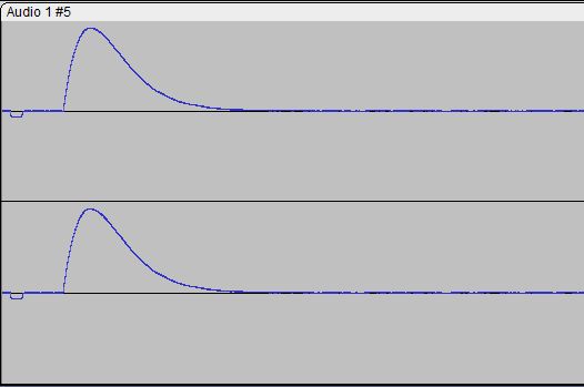

The output is directed to a laptop audio port via a TRRS plug. There is only minimal noise by replacing the battery source with cells instead of USB port of the laptop. The snippet of recording using Audacity is shown below.
The only remaining problem now is that, even if the gain of LM386 is set to approximately 200 and the volume is adjusted to distortion less amount, the ECM cannot pick up any lung sounds even with a coupler attached to it.
Are you saying that the recording is OK with a preamp of your own design?
Not entirely okay tho 🙁 the static/ground noise is loud. Attached also here is the recording with normal voice 30 cm away from the microphone.

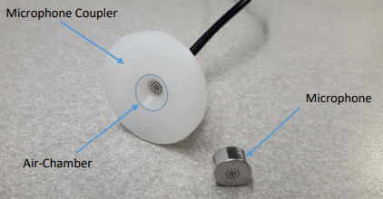

What do you call a coupler?
A mic coupler forms the air chamber on which the sound waves travel on to the microphone. I have managed to create a somehow feasible coupler.
Photo courtesy of J Winkler: https://mspace.lib.umanitoba.ca/bit...effrey.pdf?sequence=7#page=95&zoom=100,92,124
I've made a similar coupler and the recording seems to capture the sound but there is a noise. https://voca.ro/1j50HkQEIz1t
The recording device seems to have some form of automatic gain control in your sample. When you are not talking the gain goes very high and that is why you hear the noise:

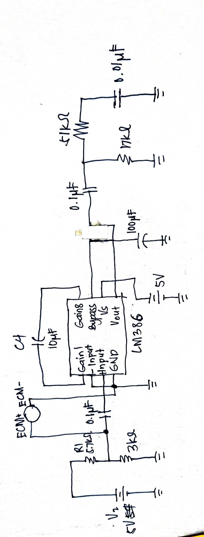

Please do, a schematic could be very helpful. It doesn't have to be pretty, just readable.
Here it is, sorry for providing a rush work.

An audio amplifier (or preamp) with a phono stage is a high gain low noise amp. The Moving Coil input is very sensitive (very high gain) but with low noise. It was just an idea. You would still need to bias the capsule (as you show in post #22) and feed that to the phono input.

Is that 5 V source a battery, a laptop USB port or something else? There is only some 12 dB of suppression from that voltage source to the microphone capsule output signal (just the voltage division of your resistive voltage divider), so it is essential that it is a very clean 5 V. In the bird sound project, we used several sections of brute-force RC low-pass filtering to clean it up.
I've used a laptop USB port initially, the noise was much bigger. In this recordings I provided above, I am currently using a 6V power series, with four 1.5V batteries in series. Unfortunately, the noise is still large.
On the last example you linked on #30 message the repeating noise sound like a digital polluted supply rail to me.
The sound from the capsule/ coupler is indeed relatively low but sound 'clean', it is an encouraging thing. 👍
Advice given by Marcel about psu filtering hold for your 386 circuit too.
How do you supply the 386 circuit? Edit: as in your schemo: powered by the 6v cells?
Is this circuit shielded (it could be picking EMI/RFI)?
What adc ( converter) do you use? Mic input on a laptop? If it is then try to run the laptop on battery it might solve the issue.
Said otherwise it could be a ground issue too on computer side. Been there even with 'pro' soundcards...
Thank you putting Vocaroo's service to my knowledge, seems fine and handy!
Edit: i listened to the mic 'check hello' file. There is definitely some agc taking place: computer using windows? There might be a software running hidden to perform some 'expanding ( dynamic) treatment'. Time to seek and desactivate any windows (or integrated to your soundcard sotware suit) integrated software enhancer.
Otherwise it sound nice to me ( as a mic capsule should sound!).
