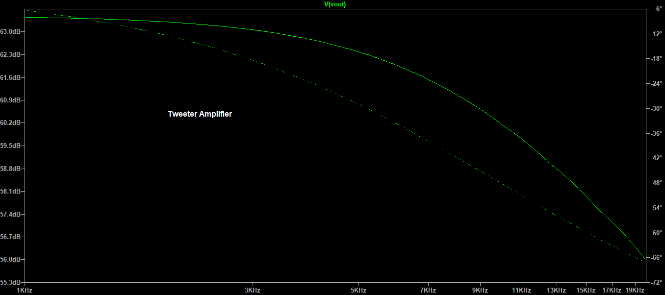

OnAudio might actually have good intentions while putting up an amplifier schematic in here. However, it is my experience that SPICE models and the simulations (phase margin etc.) could be inaccurate, and even OnAudio might be well aware of the same.

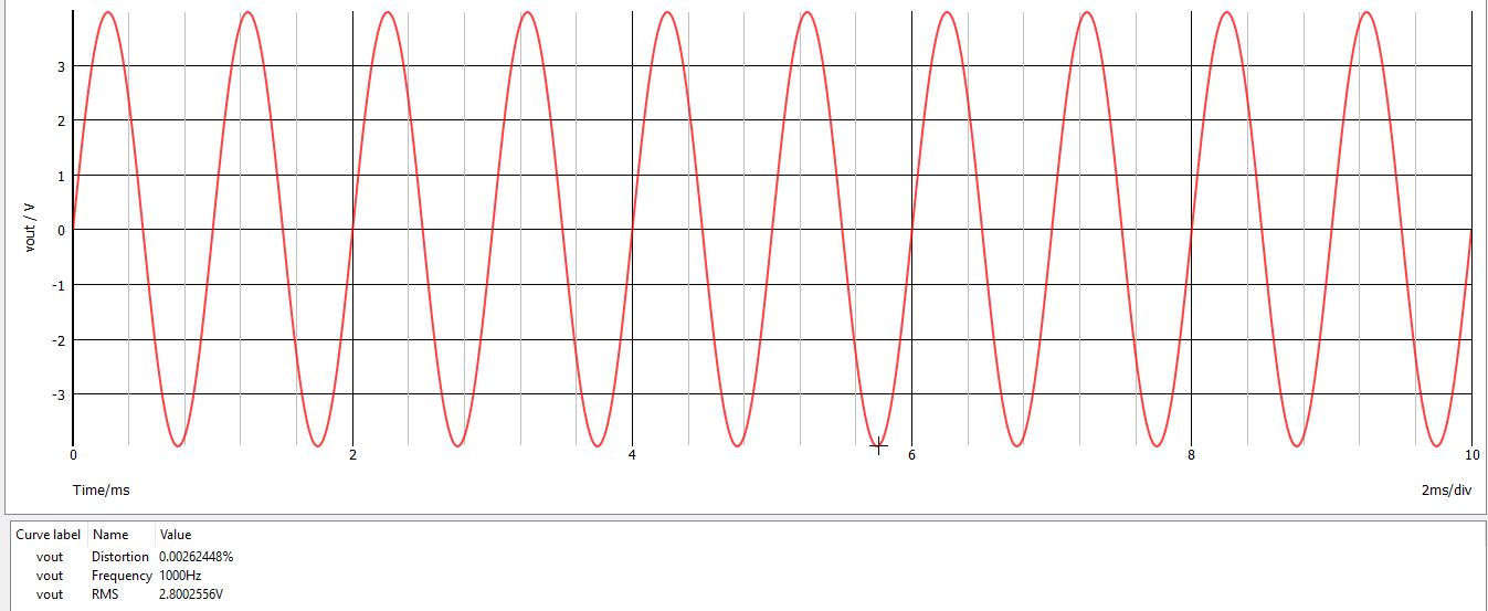

Thanks for your feedback, I don't take it for granted keep the comments coming. For damping factor. Its unlikely a regular power supply will be up to the task and then again no speaker can dip that low unless its shorted out. Damping factor is not a serious spec in this case its just a fun spec as this isn't an arc welder

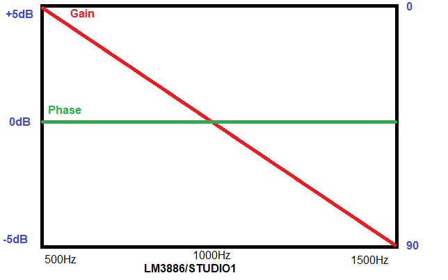

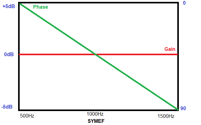

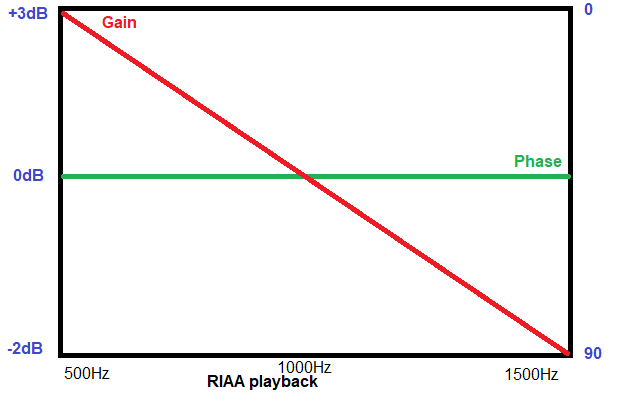

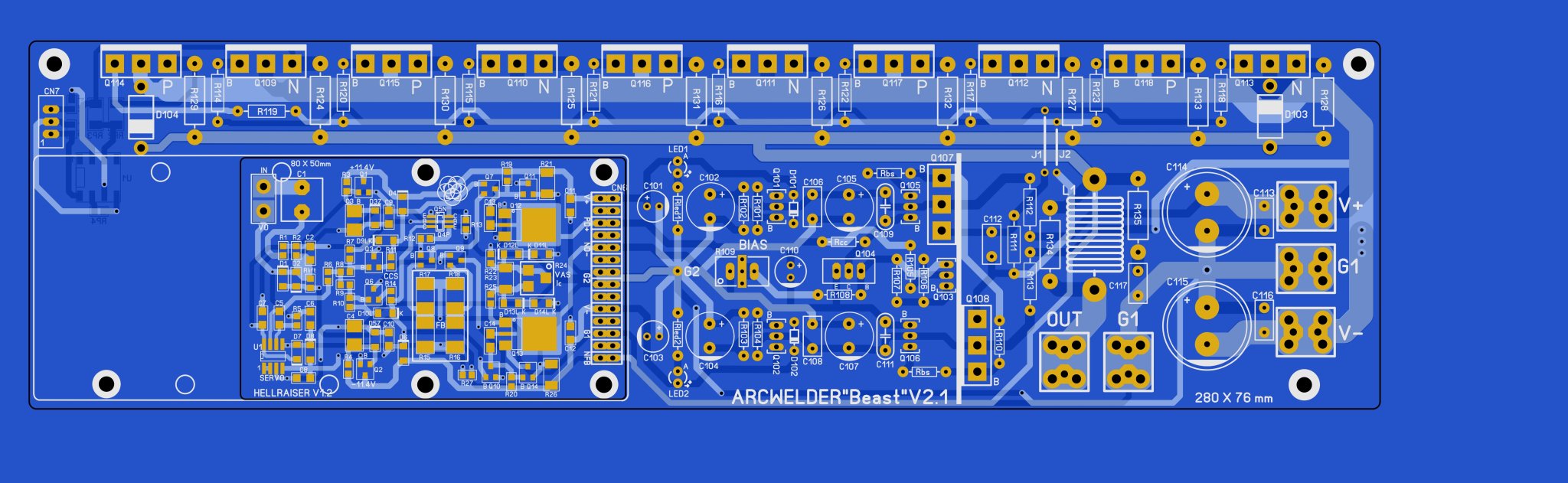

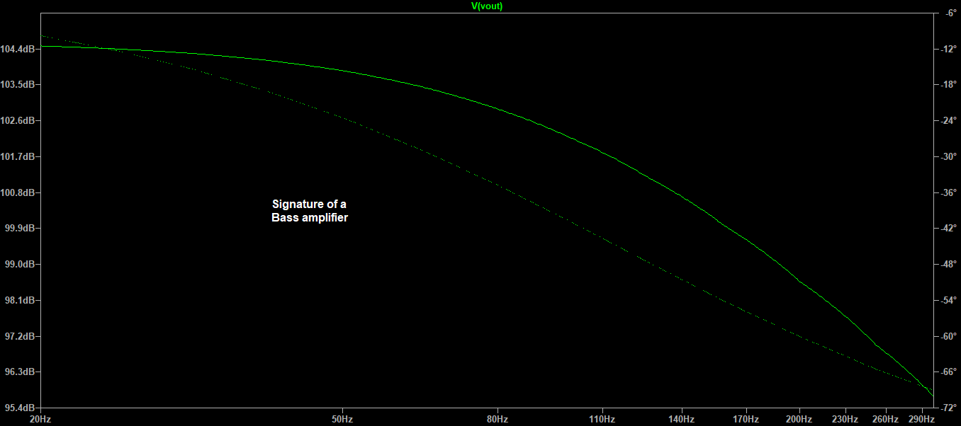

Voicing of an amplifier begins with design before moving on to selection of parts, this studio amplifier like the LM3886 and most opamps are voiced as a jack of all trades. However there are amplifiers that shine within their area of expertise. Many people that build the 1DIFFQC and SYMEF ended up saying that the high end of SYMEF was soft unlike the 1DIFFQC which was sparkling clear in the highs, while at the same time said that its midrange was not as sophisticated as the seductive SYMEF in the midrange. Here's an example of what was happening with the 1DIFFQC.

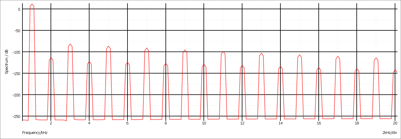

Typically , but I have noticed a CFA amp with high slew rate is better at negating EF artifacts and the wild (driver) impedance swings. This is moreOnce the slew rate is adequate there is no benefit in making it higher
the "CFA" than the actual slew rate.
Simulation even will show that THD rises very slowly on even a grossly under-biased EF in a CFA amp.
OS

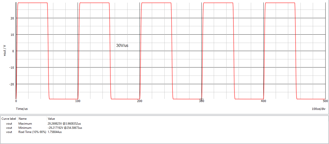

I don't know how you get just 30V/uS with your posted topology.
C1 (on your schema) , you are killing your OLG with that.
Wolverine / "blameless" = tested 75+
Spooky (like your amp) = 125+
CFA = 200+ (tested)
CFA = 200+ (tested)
Thanks for sharing Ostripper, I have no particular preference of amplifier or topology, that leaves my mind free to explore and learn rather than being caught up in a local optimization loop that could actually be a crater in a very high mountain peak on a mountain range 😉, audio is just fun, just like the many items we use in life, sometimes we need them sometimes we don't. Lets just have fun

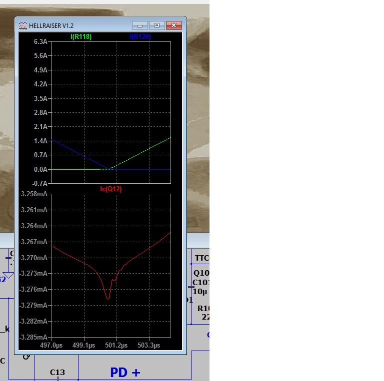

Fixing the wiggle in the middle is all about GBW. CFAs just have that in spades. The higher an amp’s GBW, the better it is able to correct high order distortion when applying feedback.Typically , but I have noticed a CFA amp with high slew rate is better at negating EF artifacts and the wild (driver) impedance swings. This is more
OS
If crossover distortion were just 2nd and 3rd order no one would be bitching about it. It’s noticeable because it produces high order artifacts.
I did not think anyone believed this . Some think it a myth.Fixing the wiggle in the middle
I noticed it on simulations at first while designing the "CFA vs VFA rumble (slewmaster)" amps.
(below) ... this is unique to a CFA.
I've observed the real amp hooked to a big woofer and there are even more non-linearity's present , especially with large excursions.
Back EMF , as well ?
OS
But you do want a "studio" amp ?Thanks for sharing Ostripper, I have no particular preference of amplifier or topology, that leaves my mind free to explore and learn rather than being caught up in a local optimization loop that could actually be a crater in a very high mountain peak on a mountain range 😉, audio is just fun, just like the many items we use in life, sometimes we need them sometimes we don't. Lets just have fun
-It has to be tough .... you current sourced ,diode biased Hawksford would "choke" at overload.
-It has to be stable .... Your current mirrored symmetrical input stage is inherently unstable in the real world.
Search all the Bob Cordell threads , he explored this. I listened and that's why I just use a cascode on my symmetrical (spooky).
Professor Leach also just went the cascode route.
It's not "fun" to produce anything that would have these attributes.
Speaking of the "Leach amp" , I notice many class AB "studio amps" use variants of this topology.
OS
