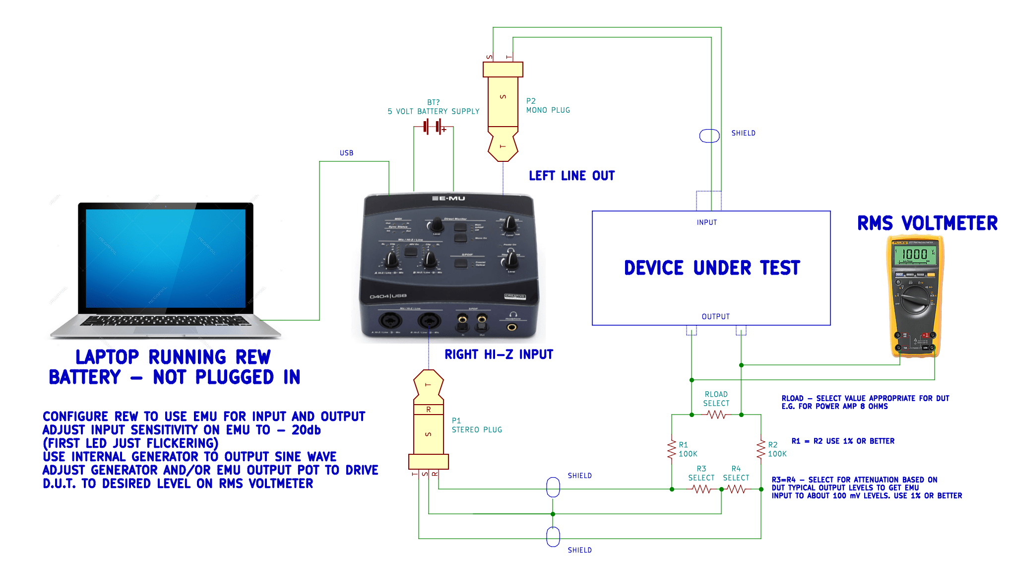

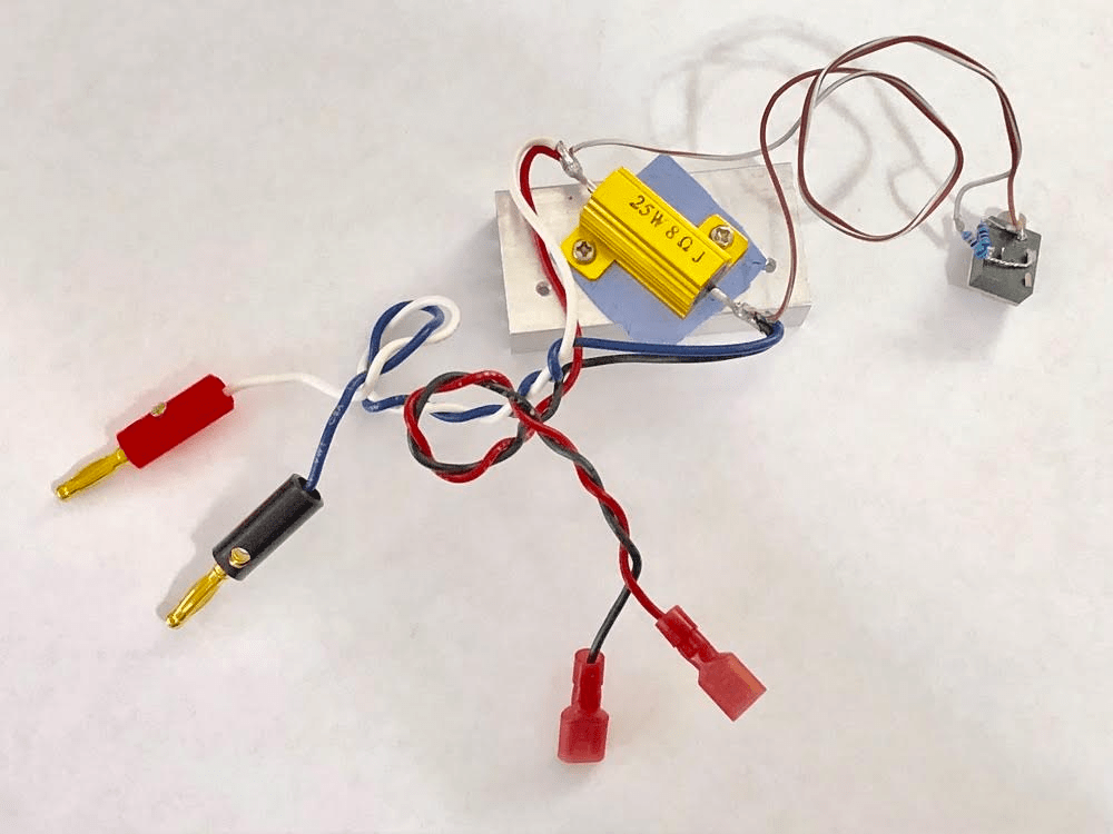

I would DIY it... It should cost about 5 cents if you have a cheap place for resistors...
The thread about how to use REW has an example using 22k and 2k in series to make a 10:1 attenuator.

Thanks Koda. I'll have a read and see if I can figure it out.
This: The two small resistors are the 22k:2k, the big one is the load for the amp. If you use the speaker as a load, you could omit the big resistor.
I don't think the pic you posted is relevant to the thing you want to test 🙁
