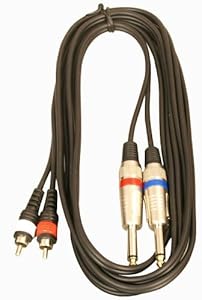

Hello Everyone, Thank you all for your replies. Im sorry haven't been able to get back online sooner. I was at church doing Sound again since posting and took a look at the setup. its a samsung DVDHR755, think its a rather old unit that was donated to us. quick look at the manual online says this model also max 2vrms. I couldn't see any setting in the menu for setting attenuation. I am using a standard 1/4 jack to RCA cable direct to stereo input on the back of the unit. The av output is feed to a small portable dvd player that we are using as a monitor and plug in headphones. I can only just hear the sound through the headphones with headphone volume on full. When I play back the dvd on my TV the picture looks little fuzzy but acceptable . I need to turn sound on tv up almost full to get reasonable volume level.

Video is fed from av output port on camera to video rca input on back of Samsung recorder and the sound comes from utility out on mixer to left and right stereo rca input on Samsung recorder. The video and sound output from the samsung then feeds into a small portable dvd for monitoring. The gear is locked away during the week but can take pics next sunday if Its helpfull.

Anyway, just to be clear, you're using a cable like this at now ? :
