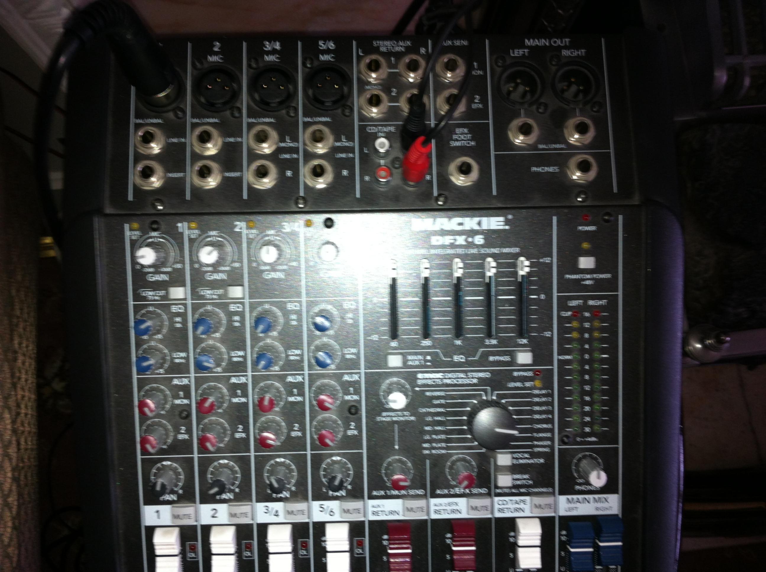

I am trying to record live audio from my mixer.
Please take a look at the picture I have attached so you can see what ports I have available.
I have done some research and what I know is that I need to use this cable:
http://www.amazon.co.uk/Cable-Tex-3...UTF8&qid=1365778782&sr=8-6&keywords=rca+cable
and plug it into a computer to record
I understand that the cable goes into the tape out ports in the mixer but the problem is that the tape out is already being used to get the mixer to connect to this home audio system thing which then plays the audio live out of speakers.
So what is the solution?
The port is already being used, so what can I do?
Many Thanks for your help.

You can simply plug into the MAIN OUT L+R XLR connectors in the top right hand corner of the desk and then run them to either the home audio system, or the computer, whichever you prefer. I would recommend running the CD/TAPE OUT to the line in of your computer and then the MAIN OUT into the home audio system.
Depending on what input connectors are used on the home audio system (they will probably be RCA/phono), you will need to buy an XLR to RCA/phono (or whatever other connector type your system inputs are on). This is wired to convert the balanced MAIN OUT (XLR's are normally used with balanced signals) to unbalanced RCA/phono. You should be able to get it from amazon too.
Hope this helps.
Depending on how they've wired the adaptor, those cables should work fine, though you may find you're having to run the master faders a bit low; XLRs are generally used at broadcast (+4 dBu) levels, while RCAs are normally used at domestic (-10 dBu) Alternatively, there are jack sockets in parallel with the XLRs, and jack to RCA cables should be cheaper than XLR to RCA.
Or, since the outputs are low impedance you could use a simple Y-adaptor cable, one RCA male to two females, sometimes with a bit of wire in :-http://www.amazon.de/mumbi-Verteiler-Y-Adapter-Cinch-Y-Kabel-Stecker/dp/B003RI8Y6Y/ref=pd_sxp_grid_i_0_2 , sometimes without:- Cinchverteiler Chinchverteiler Cinch Chinch Verteiler: Amazon.de: Elektronik (those pictures come from Amazon, but unfortunately Germany), which can afterwards be used for a variety of signal distribution tasks (but not for mixing stereo signals into mono).

I see what you wish to do. The RCA outputs from the mixer are the same audio content as the XLR main out OR 1/4 inch main out.
Looking at the DFX mixer block diagram from Mackie.com - I might recommend using cables to your playback/monitor audio (your stereo), with 1/4 inch MONO plug to RCA plug cables.
The reason for that is it will not only be slightly less money for these cables, instead of XLR, but mainly because the 1/4 inch main outs on this mixer are impedance balanced and the XLR main outs are "true" balanced.
An adaptor cable with XLR to RCA has to eliminate one of the "hot" connections in the XLR. XLR Pins 2 and 3 in a true balanced audio line, both have audio but are in opposite polarity. When an adapter is used to go to RCA for instance - it likely connects pin 3 to pin 1 and is shorting the audio drive on pin 3 to common.
If the XLR out was impedance balanced - pin 3 in this case would not have audio drive on that pin and is safe and ok to "short" that to common and end up with a unbalanced audio connection. It is preferred to not short out a driven output pin to common...
Going back to the block diagram, I note that the 1/4 inch main outs are derived from only one audio out of the true balanced XLR out pins.
So, this is a good way to connect the main out by 1/4 inch MONO plug to RCA. No potential harm with the mono plug in that jack because the "ring" connection on the TRS 1/4 inch plug in this output jack has no audio drive from the mixer circuitry.
If you did need to use "balanced" output from the TRS (tip, ring, sleeve) jacks, you would use a TRS plug. No need to go into the intricacies of impedance balanced theory in your application, other than the major difference of how a balanced output is achieved.
The block diagram does show a buffer amp with 2 actual, out of polarity, audio drives for the XLR outs. It is true balanced.
Again, I suggest using 1/4 inch male Mono (tip, sleeve) to RCA male adapter cables and you are good to go.

Ok
I guess I am allowed to put this website item from Amazon.
I personally do not use Amazon but this is an example of the cable.
Amazon.com: Live Wire RCA-1/4" Dual Patch Cable 1 Meter: Electronics
This cable will feed the audio from your mixer (1/4 inch MAIN outputs) to your stereo and could use the RCA plugs into an AUX input on your stereo.
You would continue to use the MIXER RCA jacks you have hooked to your computer already.
You will be able to listen to what is coming from the mixer with your stereo.
Keep in mind that if you are using a microphone into the mixer to record, you do not want to have the stereo in use because the audio in the room will be picked up by the mic from the stereo.
However you wish to run the mixer into the computer AND the stereo, is your choice. The mixer RCA out jacks AND the mixer MAIN out jacks have the same audio content.

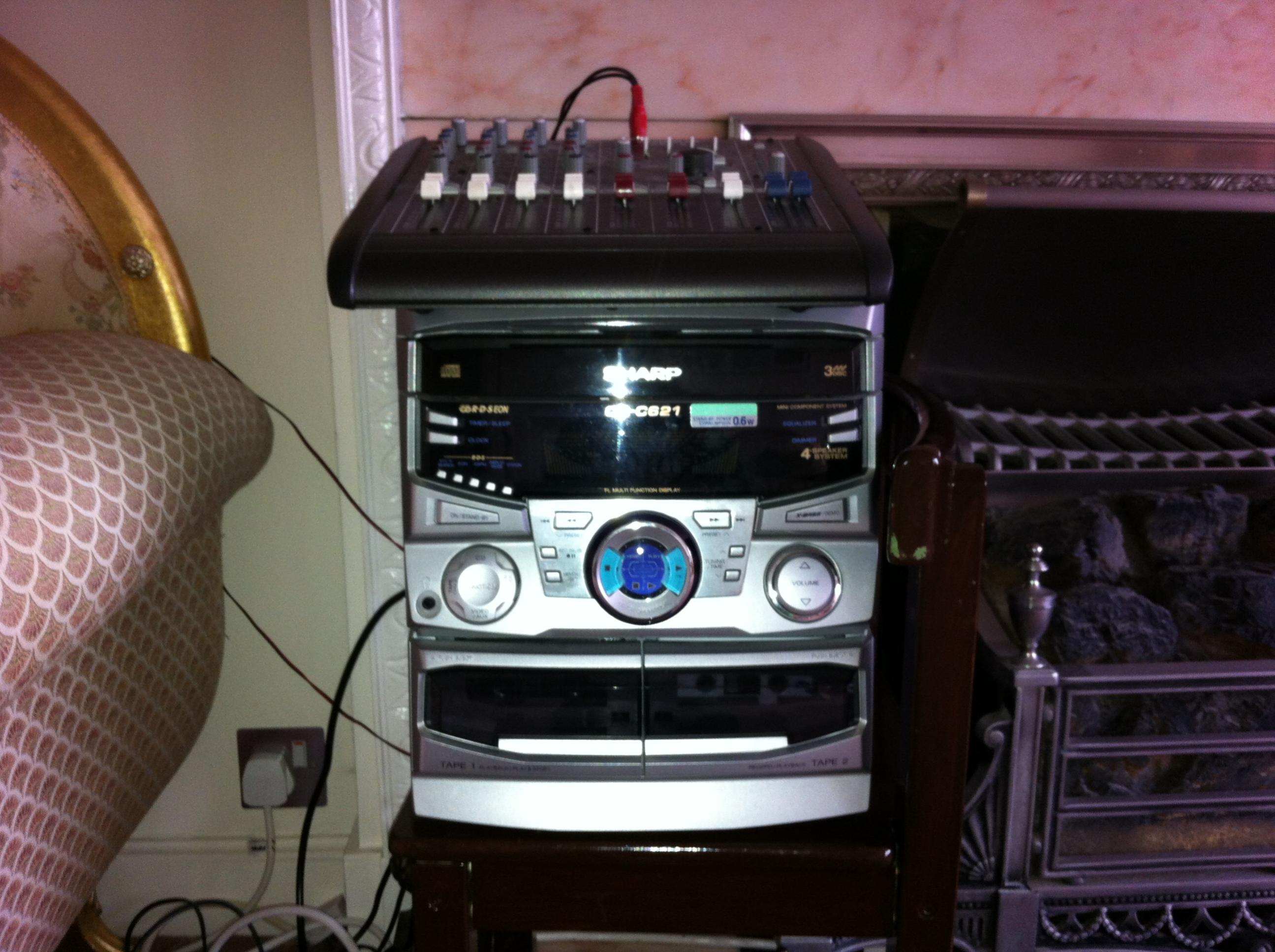

Take a look at the 2 attached photos to see my setup, as well as the picture attached in my opening post to see the mixer
This is what I need to do:
I manage the audio and video for my fathers business seminars and meetings.
I have a home audio system with 2 speakers connected, which also allows for more to be connected.
I need the audio to be played out live, I already know how to do this. But I also need a cable that will allow me to record all audio going through the mixer onto my laptop, as in it will go into the microphone port.
I have done some research and found that the port on the mixer for that is used to connect the mixer to the home audio system, you can see where it plugs into the system in the picture microphone2.
What I am asking is:
1. Could you please give me a link to a cable that I can purchase which plugs into the mixer and allows me to record the audio on a laptop.
2. Could you recommend a cheap to mid range wireless lapel mic set to use with the mixer.
That cable you linked isn't what I need I think. I need a cable that plugs somewhere into the mixer and on the other end of the cable its 3.5mm standard audio cable which can plug into the microphone port on a laptop and can be recorded with something like audacity.
Please advise - urgently, I need to order the parts today!!

Hello
What you described in your "info" post explains more of what you are shooting for, in the seminar presentation.
I would suggest leaving the XLR patching, out of your solution, for the reasons I listed in my previous post.
It looks to me that you have a dual RCA cable from the mixer out - to the RCA inputs on the little stereo unit.
That is fine and you said that works, so that part is apparently ok.
Look at your mixer. Notice the 1/4 inch jacks right close to the XLR outputs. These are the 1/4 inch (Main) outputs from the mixer that has the same audio as the tape outputs, as said before.
This is where you can supply the same audio to your laptop for recording everything that comes from the mixer, as I shared previously.
The cable you can use would be a Dual 1/4 inch male MONO plugs on one end and a 3.5 mm male plug on the other end.
This is an example: Amazon.com: Hosa CMP153 Y Cable 1/8 Inch TRS to Dual 1/4 Inch TS Cable - 3 Foot: Musical Instruments
If you need longer than a 3 ft cable - then select the same ends in a longer cable...

The line level coming out of the mixer at the main outs could easily be stronger than what your laptop mic input can handle, without distortion...
The mic input on the laptop is expecting a mic (low) level input.
One option is to use aux sends on the mixer, instead of the main out - to send a reduced level (by a lower setting on the aux outs) to the laptop. But I am trying to help avoid confusion in consideration of you being somewhat new to this equipment and patching stuff.
Relative levels in audio are important considerations for best performance and least distortion.

Copy from previous post: Look at your mixer. Notice the 1/4 inch jacks right close to the XLR outputs. These are the 1/4 inch (Main) outputs from the mixer that has the same audio as the tape outputs, as said before.
The picture in your post #1 is dark where the main outs are located.
Here is the Mackie mixer manual:
http://www.mackie.com/pdf/dfx_om.pdf
On the first page of the manual (.pdf) is a picture of the mixer. Enlarge it a little and you will see a boxed off area with L+R XLR outs and 2 L+R 1/4 inch main out jacks. The jacks and XLRs have a little line between them showing they are Main outs corresponding to L and R.
Right above the headphone jack...

from the pictures you supplied i am left wondering a few things first is the mixer on (powered up) and secondly why are all the unused channels turned up to max as well as the masters this is not good mixer practice as it simply adds noise to your mix that your trying to record!
you didn't include pic's of your speakers are they stand mounted? which to me would be a must to do business presentations.
what is on the other end of that mic line that's patched into channel 1?
Too quiet with the 'gain' potentiometer on the Mackie wound flat out, or too qiet when compared to the others with equivalent settings? Yes, you're likely to have less gain and more room sound on the lapel mic; it's omnidirectional, so picks up everything, and is not optimally placed for voice pick up. It'll also probably require lots more equalisation to sound decent. But that's just typical of that style of microphone.
You haven't given model numbers for the microphones, but some of those body pack transmitters give gain trimmers – generally screwdriver adjust mini potentiometers, occasionally DIL switches – and set them pretty low on delivery, because they don't want them to distort on loud signals. Don't adjust anything like this unless you've read about it in the manual; sometimes they're channel select. Look for preset gain, input gain, input pad, anything like that.
