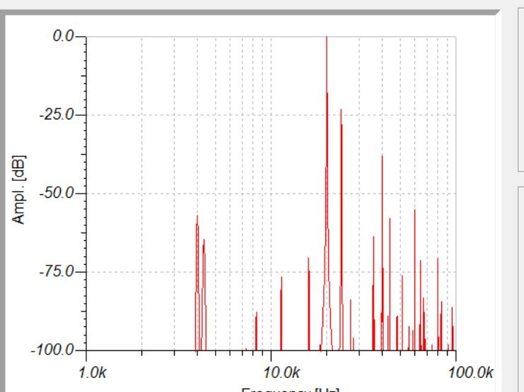

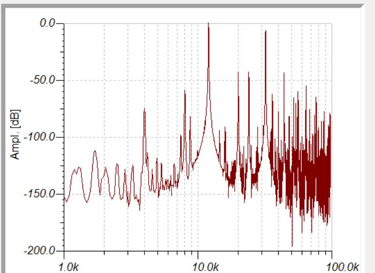

On LTSPICE I get -5db image of 20khz at 24khz.
-9db for 16khz at 28khz, -10db for 12khz at 32khz.
If I pass these ratios through a common emitter 2n2222a amp with 1% distortion simulating an amp+tweeter character, I get an intermodulation of 4khz for 20khz about -45db and about the same at 20khz for 12khz signal.
This is less than 1%.

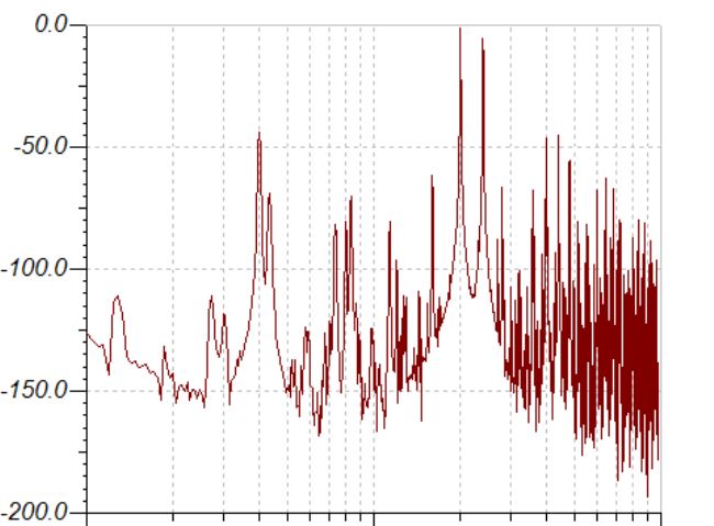

If I filter only -20db the image, I get less than -60db 4khz. Why such level is not sufficient?

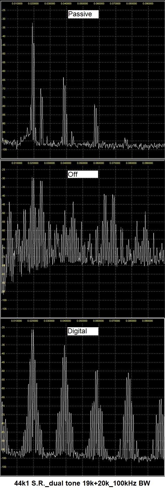

I am wondering why in off you are getting 4khz -15db and 6 kHz beat? Where in your measuring equipment intermodulating so hard ? What good to see the digital is not cleaner in audio band as the passive. It has 1khz at -40db.
