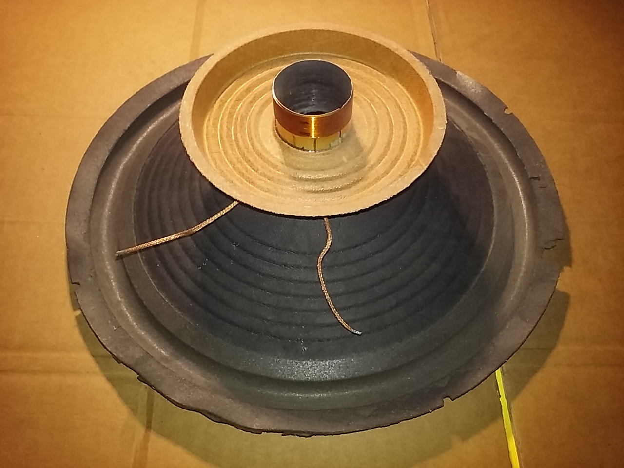

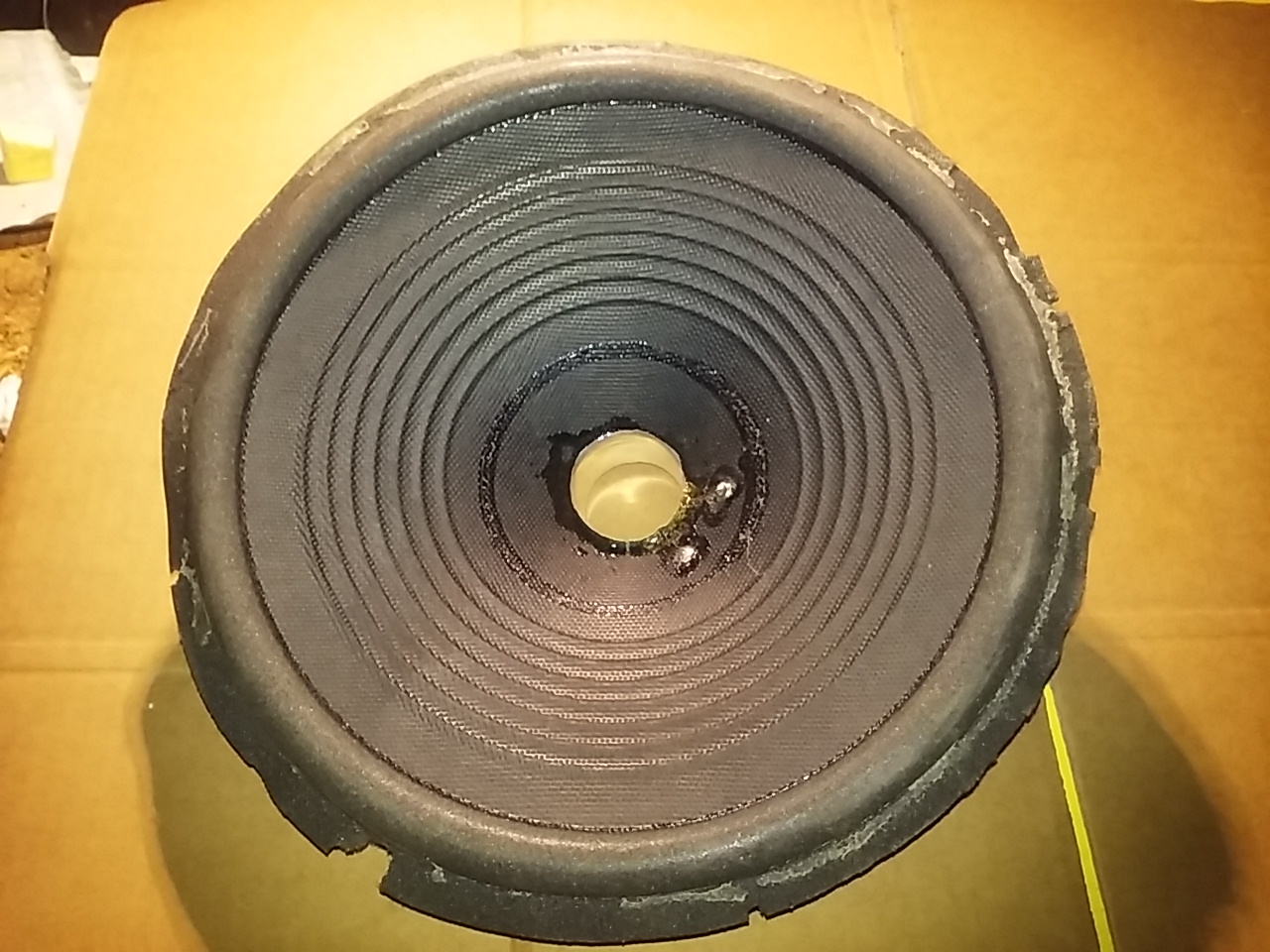

Hi there, I am trying to get into the wonderful world of speaker reconing/recoiling. To start of I have acquired some unbranded 12" drivers that someone was throwing out. The frame looks to be in good shape the cone has disintegrated.
What specs should I use when buying a reconing kit?
There are two tweeters as well with the coils opened, again unbranded. What should I keep in mind when ordering replacement?

By 'specs', I assume you mean which measurements you need to take of the old cone/voice coil?
I'm not sure that you can buy recone kits to match unbranded drivers in the way you suggest, but I stand ready to be corrected.
Some photos of the 12" drivers and the tweeters may be of assistance.
As to how a recone is done, there's lots of help out there: Recone Instructions - Unassembled Recone Kits - Speaker Exchange

We don´t know what kind speakers are you talking about, nor brand or model, but start realizing all speakers are different, and you´ll need specific parts for that.
his is a generic speaker diagram:
When reconing you keep the magnet and frame; will replace cone, voice coil, spider, dust cap, surround, gasket, tinsel wires.
Big problem is the difficulty in getting those, and even worse because they come in so different sizes.
And suppliers are "obscure" and hard to find.
Google any capacitor - resistor - semiconductor - tube - swit h - etc. and more or less suppliers will appear, with prices, amounts, etc.
Try that with any speaker parts 😱
Voice coils are worst because even "same size" ones can be very different.
Voice coil must "float" but not touch in the least inside the narrow (1.25mm to 1.5mm wide) slot between pole piece and top plate hole, diameter tolerance (acceptable error) is in the order of 1/100th of a millimeter. 😱
Too small, it will scratch against pole piece; too large, it will scratch "outside"; you need at least 0.1mm frree space (voice coil basically moves up/down but it usually also wiggles a little) inside, also outside; 0.15mm is safer but you can´t overdo it because you waste magnet big time.
Car Audio speakers may have up to 0.3 or 0.4 mm each side, and are famous for humongous magnets (which can be seen) and appalling efficiency, requiring hundreds of Watts to fill the tiny space inside a car 🙄
Cone must be similar to original one , same depth so it meets VC+spider at the proper point, easies parameter to meet is cone diameter.
Spider must also be similar to original one, same outer diameter to meet speaker frame at the proper place, same hole diameter to match voice coil.
The problem with speaker reconing is getting a good supplier which has literally *everything* available to you.
As of tweeters: cone ones are "the same as standard speakers, only smaller" but are almost not used today (and that, in the cheapest of the cheap systems); dome tweeters require the *specific* dome and voice coil which usually come preassembled.
If you want to do this as a job, you may somewhat specialize so narrowing possibilities.
Guitar speakers tend to copy a famous one for mojo reasons, so you will find, say, Eminence has a few modeled after Celestion speakers and share basically same cones and voice coils, some modeled after classic Jensen, same thing, so stocking half a dozen cones and a dozen voice coils can cover a lot.
Hi Fi speakers by definition are all over the landscape.
An ex employee of mine specialized in repairing Car Audio speakers using the skills he learnt working forme: he takes *any* blown woofer 😱 , no matter brand or type.
All come with scorched/nuked voice coils.
With infinite patience , plus various solvents and steam from a kettle, not kidding, he unglues cone, spider, etc. without destroying them (sourcing them would be impossible or very expensive), measures the voice coil former and diameter, has a friend who lathe turns a winding former out of hard wood or aluminum and uses it to hand wind a new voice coil, then he reassembles the speaker.
In part this is made possible because in those speakers tolerance is relaxed 🙄 and since he keeps a shelf full of winding formers, after a while certain sizes start to repeat so his task is easier.
But it´s a very "niche" kind of market.

@JMFahey - thanks so much for the detailed explanation. I live in the Maldives have updated my profile as you suggested. I can't seem to get the flag displayed like you guys have.
I would also like to learn more about removing the glue and try to save the voice coil option as well.

I tried uploading the pictures but for some reason it doesn't seem to go through.
So here they are added to my flickr acc.
https://www.flickr.com/photos/189979534@N06/

Hi Yamin!
Does the 12" driver still work?
If so, the tears could be patched up using watered down PVA adhesive and tissue paper.

@Galu thanks, Yes the voice coil is intact and shows the proper resistance value when measured with a DMM.
Is there any instructional material about the solution you mentioned.
The photo I uploaded was the driver which was a bit intact but the other 12" driver's cone is totally disintegrated.
This method works well: Repairing a Speaker Cone - YouTube
Tissue paper is only necessary if there is a missing section of the cone that requires to be patched over.
