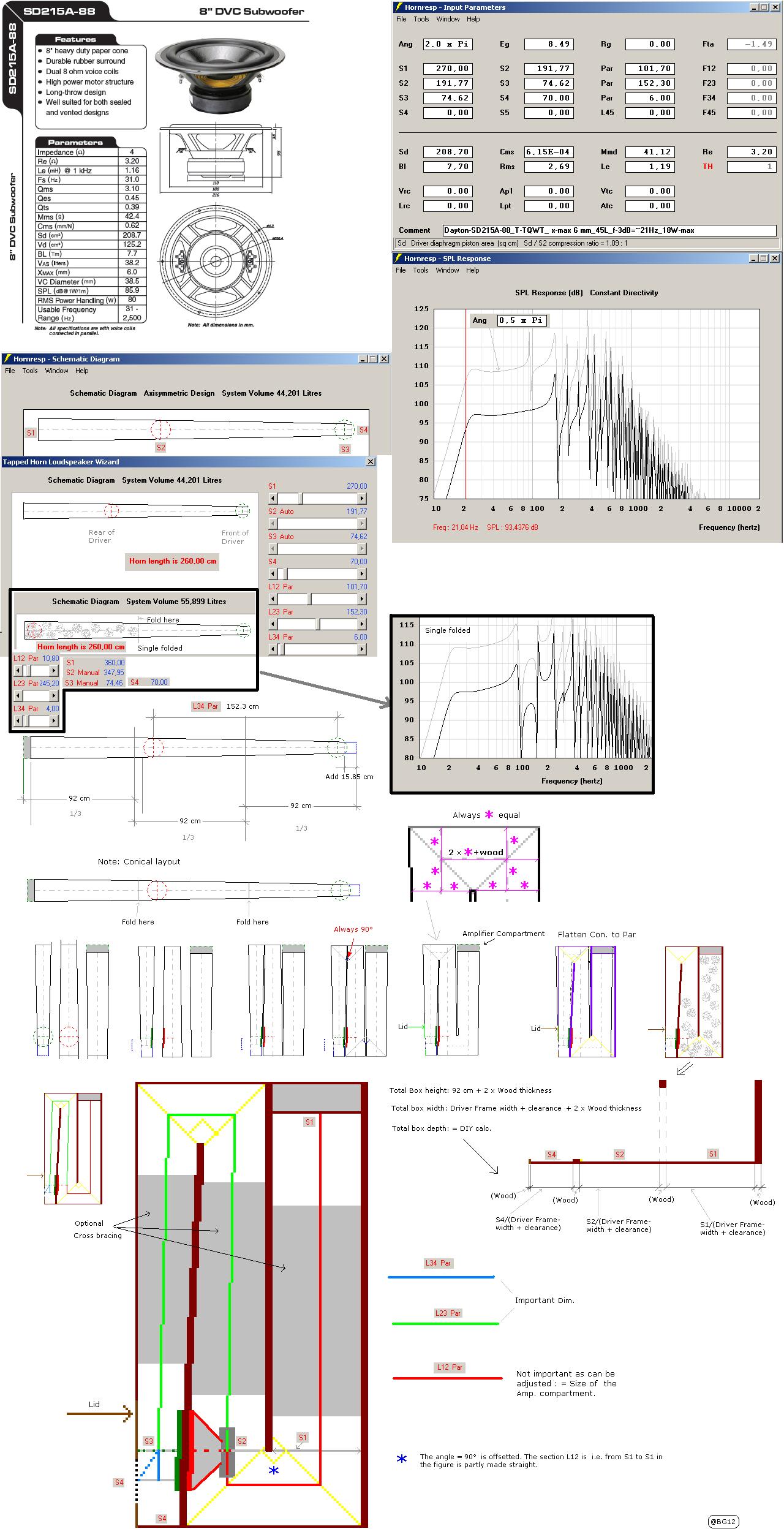

FYI:
b:)
  • Dayton Audio SD215A-88_T-TQWTs.zip
