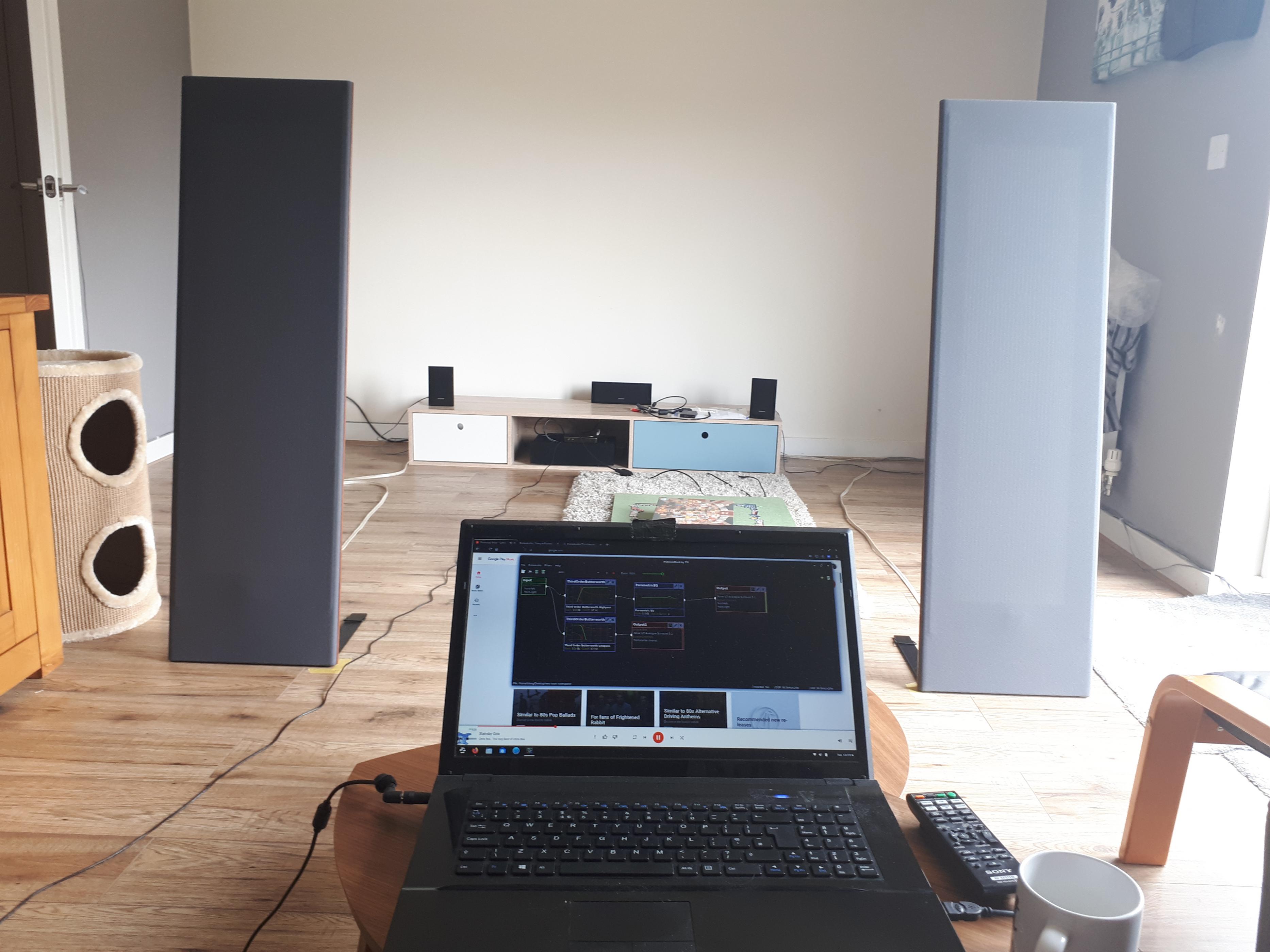

I thought I share a picture of my set up with your software in action.Attachments
Very nice, thanks! Did you actually use the support for FRD files in the software? Up to now it seems that nobody ever used that, at least I have no feedback whatsovever.
FYI: The link to open the image does not work. I copied it to a new browser tab and then it works...

Yeah some weirdness with google drive links, I've found forums dont like them, I'm not sure of a workaround.
I haven't used the FRD files yet, I'm still waiting for my measurement mic to arrive, but I'll keep you posted.
For now I just tested the setup with pink noise and a spectum analyser on my phone. I found the ideal cutoff for the sub where I could see the speaker bass response falling, then I level matched the speakers and sub. just something as simple as that has made the world of difference.
I'll share further adjustments when the measurement mic arrives and I'll get to grips with REW.
