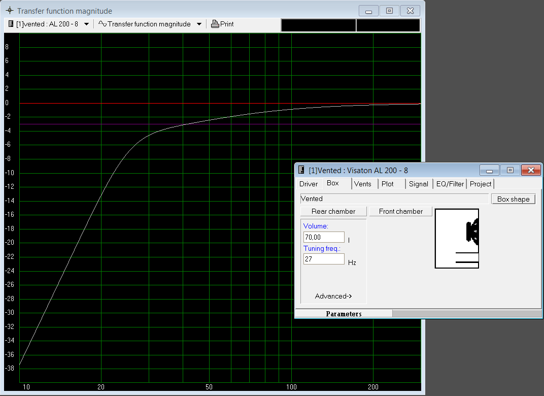

I am cudgeling my brains about Visaton's official enclosure recommendations for their 8 Ohm AL 200 woofer with a Vas of 77 litres, a Qts of 0.35, and an Fs of 32 Hz.
Specifically, the last option with Vb = 70 l. and Fb = 27 Hz does not model well. Am I missing something or do you think it is an error on their site?
Seems OK to me. It is larger and lower tuned than what gives a flat response, which results in a shallow roll off between 100 and 30 Hz. Some people say this mixes better with room gain, as deep bass is often excessively boosted by the room. Furthermore, do not forget the series resistance of the inductor if you will be using a passive crossover. This will make the response flatter.

Thank you, TBTL, I am getting the same result in WinISD (should have attached the driver's .wpr file for your conveniece). I had not thought of room gain. In my room, whose only treatment consists of soft furniture and carpets, the mid-bass region is gone wild, but the steady room gain is not present. Do you know whether any HiFi or High End manufacturers deliberately tune their loudspeaker systems to be that far from the flat frequency response in the anechoric chamber? I don't think they do, do they?
As to the inductance, yes, I am going to have a low-pass filter, but near Fb its resistance will be negligible.

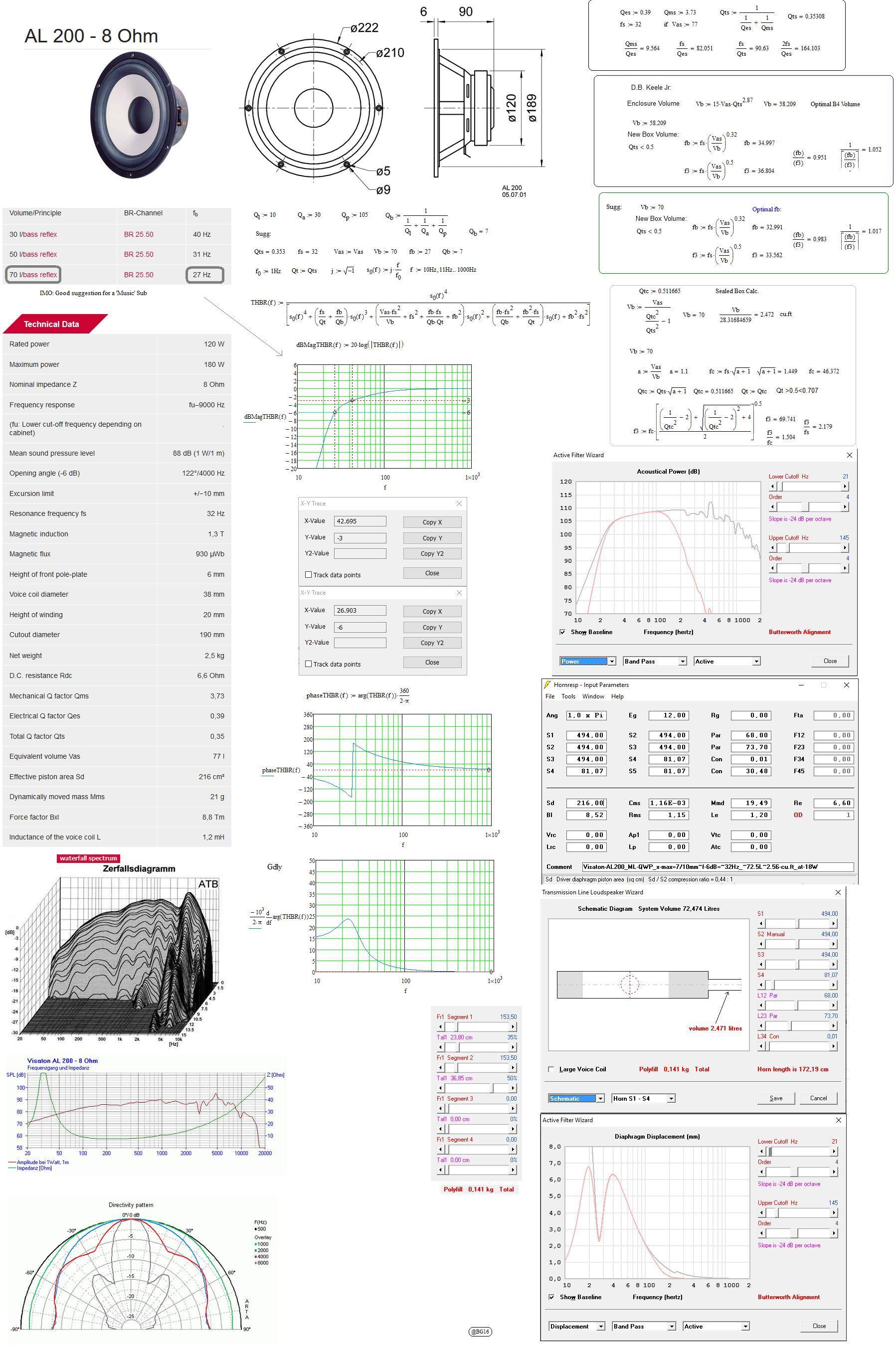

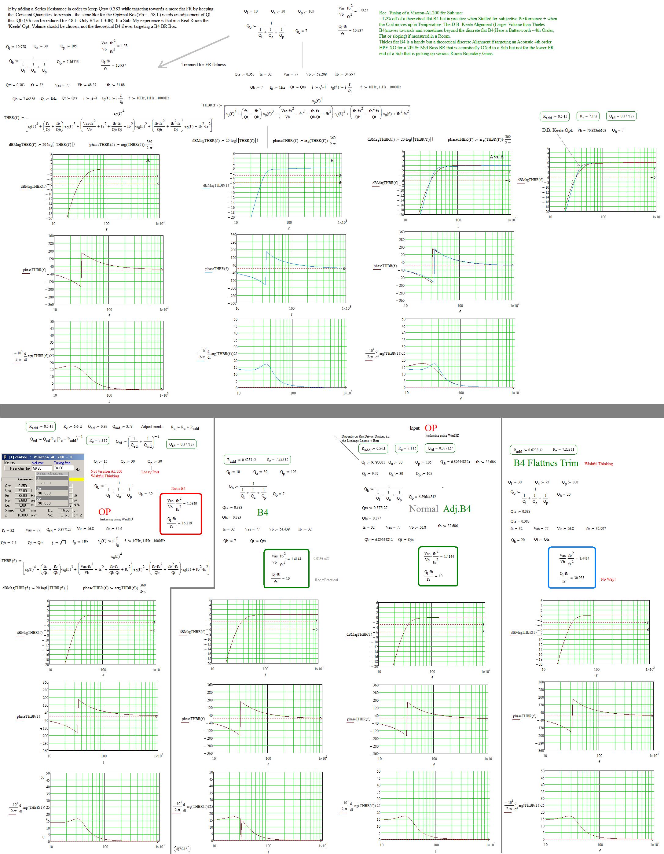

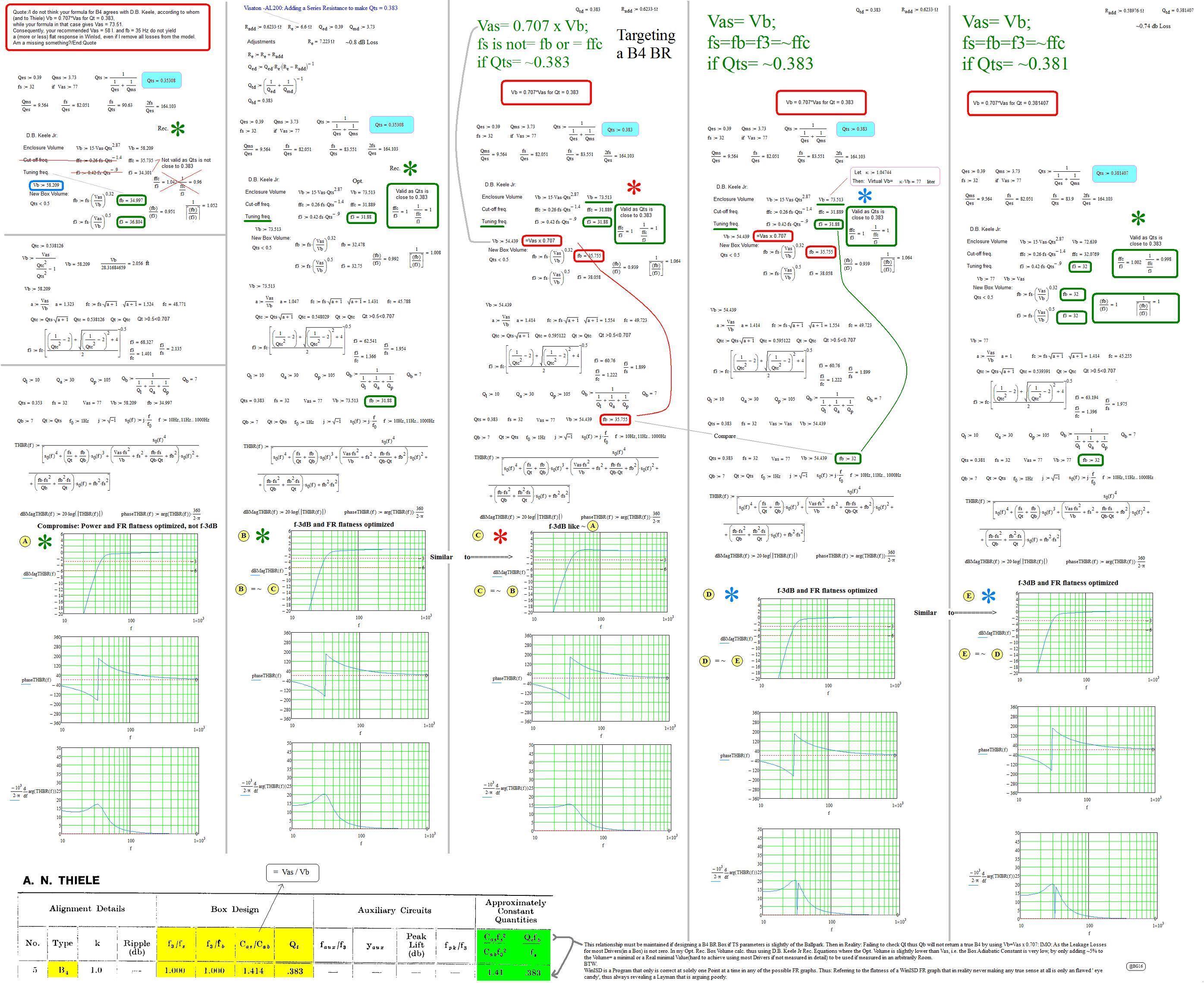

Thank you very much for the calculations, bjorno. I do not think your formula for B4 agrees with D.B. Keele, according to whom (and to Thiele) Vb = 0.707*Vas for Qt = 0.383, while your formula in that case gives Vas = 73.51. Consequently, your recommended Vas = 58 l. and fb = 35 Hz do not yield a (more or less) flat response in WinIsd, even if I remove all losses from the model. Am a missing something?
What do you mean? Vas is a fixed T/S parameter 77 liters for the driver. What do you mean with recommended Vas? Do you mean recommended alignment Vb@Fb ?! A recommended (between thousands) alignment is a net volume Vb and tuning Fb. Have fun.
All of Thiele's alignments from the 1961/'71 paper are for the lossless condition (academically interesting) and do not apply in real life.
B4 is only Vas/sqrt(2) for the lossless condition; for lossy boxes, Vb and Qts get bigger. For Ql=7, B4 is actually 1.05*Vas and Qts=0.4048.
Keele's formula is actually a curve fit of QB3 and C4 at Ql=7, curves which meet at B4. For the model bjorno is using (leakage+port+box damping) the usual alignments can't technically even be calculated because there are too many terms in the characteristic equation...

With your woofer, the Small-Margolis curve fit suggests
Vb=48.2L
Fb=36.8Hz
Keele's formula suggests
56.8L
34.6Hz
You are, of course, free to adjust those values to whatever gives you a response shape that "models well", whatever that means. If you don't like the drooping response of a 70L/27Hz box go higher tuning and/or smaller box.

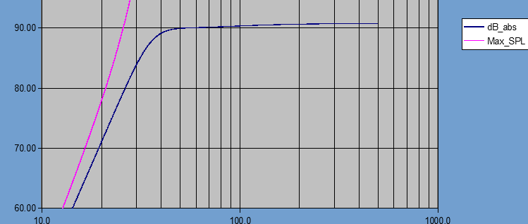

Keele's alignment looks like this, FWIW (sim neglects inductance, but uses Qa=Qp=30 and Ql=15)

I have decided on a model box with a Vb of 60 l. and an Fb of 34.5 Hz. According to WinISD, with an added series resistance of 0.5 Ohm, Qa = Qp = 100 and Ql = 10 it has a nearly flat FR with an F-3 of 34.5 Hz. I will play with this box to see which suggestion is the closest, decreasing the volume if required.

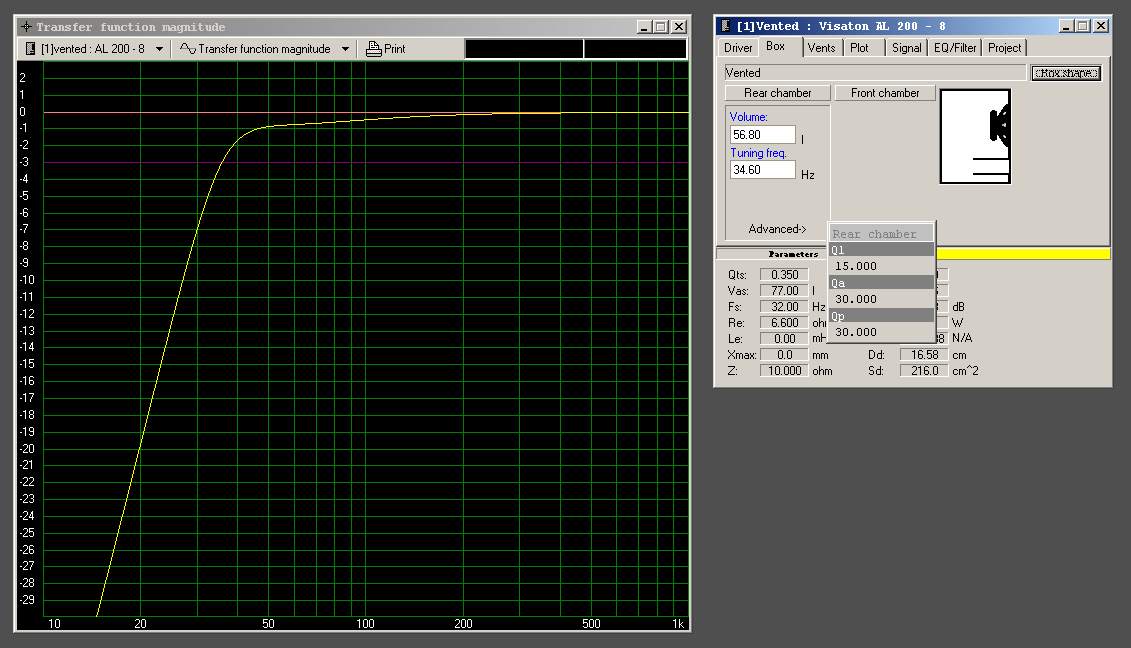

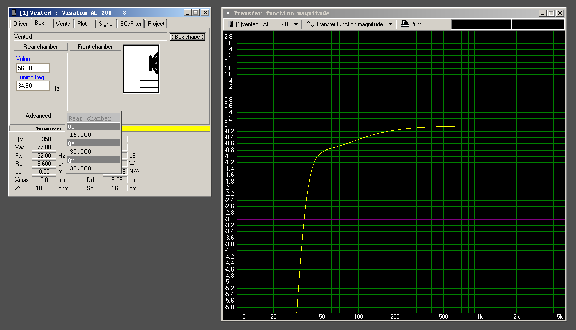

Here's what I get for it in WinISD without inductance:
