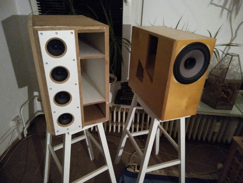

i made a triple horn for 4x 3FE25, excellent in my case useful over 80 Hz! with Schalmei
