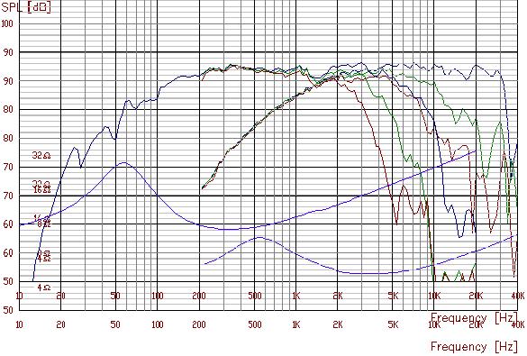

I did find this Vifa design - using the 5" P13WH and a 1" D27TG-45 tweeter: http://www.speakerbuilding.com/content/1015/
Using the specs from the Vifa site, I get the following combined frequency response - looks great (with about 5dB of tweeter attenuation)
Total driver cost = NZD$248 (approx USD$130) so should be within my constraints..... The P13 can only take 40 watts nominal. (Stange, it has no long term power handling in the Vifa spec sheet like the P17....)
I'll keep hunting...
Dave.
It does look good on paper. I'm not sure about the dip around 1.5KHz (whether it's worth worrying about - an artifact of the midwoofer).
The design also uses an xover @ 3Khz - but 4th order LR. Luckily the site has the schematic. I'll just double check the amount of attenuation he used....
I did notice the design has no impedance compensation for the woofer. Would this be an issue?
Also - there is no resonance compensator for the tweeter. I suppose that doesn't matter, since the 4th order LR means there is very little energy around tweeter Fs to worry about.
I also suppose all xover components have some interrelationship too!!! (just to complicate things some more!) - so adding a zobel could upset something else?
