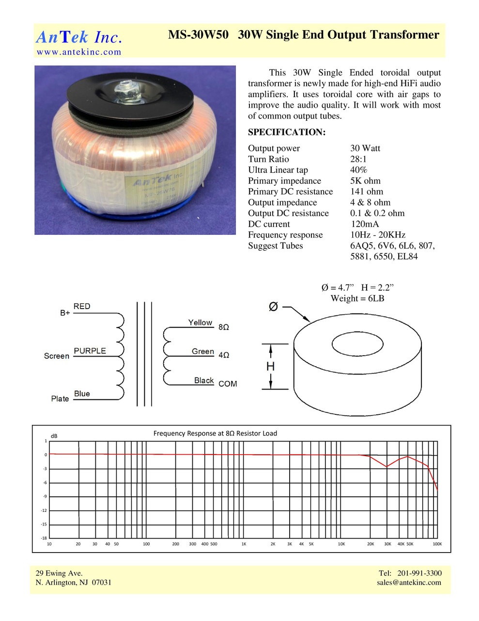

Is anyone aware of changes with Antek's models? The previous three vendors were dead ends with no response from Hayboer. Perusing options again and considering a 5k transformer run off the 4 ohm tap I noted the Antek specs apparently changed. My recollection is the original transformer showed severe HF drop below 20 kHz. The current spec is flat. Any experience with their latest? Thanks.
I wouldn’t be surprised if they have reworked them to get full range response to be more in line with other brands. I use their power transformers but haven’t tried the outputs yet. Have you looked at Toroidy yet? They are big in Europe but sell in NA too. They have some nice looking transformers and some with cases to finish them off nicely.

I did look at Toroidy but questioned the high primary Rdc of their 7K model, especially given the high current rating. A UL tap is also custom. The 6.5K UL Hammond available locally is much cheaper with lower power losses but I might still reach out.
Not lying the low Antek pricing is also very appealing.

Contacted Antek and they recommended a 7.5K model to be released next week. Spec sheet below. A tiny bit of HF drop at the very top of the range but this amp will utilize ~20 dB of feedback anyway. If it's priced with the rest of the range I'll buy a pair.

Can't really say. Maybe a 10K high power SE UL transformer was too niche to bother. Or the web form was just missed. Currently though Antek recommended this transformer based on the voltage and current operating parameters, provided a full set of specifications with response graph, and shipping excluded is far and away the least expensive option. From an engineering perspective those are strong incentives.
